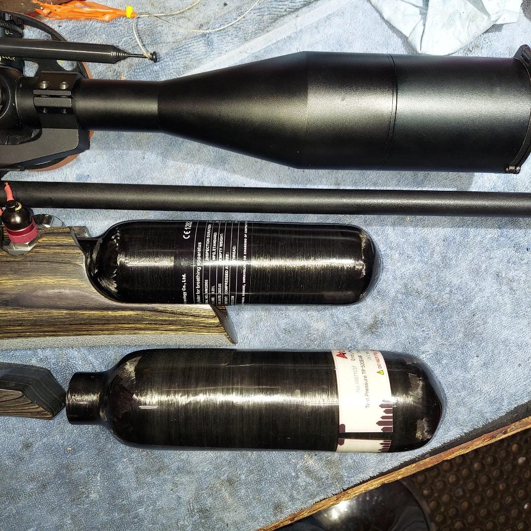

Motörhead, we checked today and a carbon bottle would be within 3” of the bore centerline. Perhaps that could be added as an upgrade, but it will probably be heavier than the current pistol with the short 200bar aluminum bottle.

Pics I received of it with the larger CF bottle.
Meets the regulations for Pistol FT, unless one is planning on constantly shooting high power 20fpe or more I don't really see the reason for the heavier/ larger CF bottle.
When setup with the small bottle and a with few tweaks I believe a full FT match is possible at 19fpe with it. I probably won't be upgrading mine to the large bottle, but it is an option as an additional purchase.

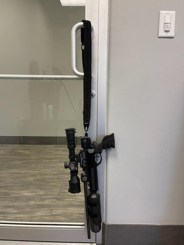

This beauty may be stretching it's legs at an upcoming match this weekend.
