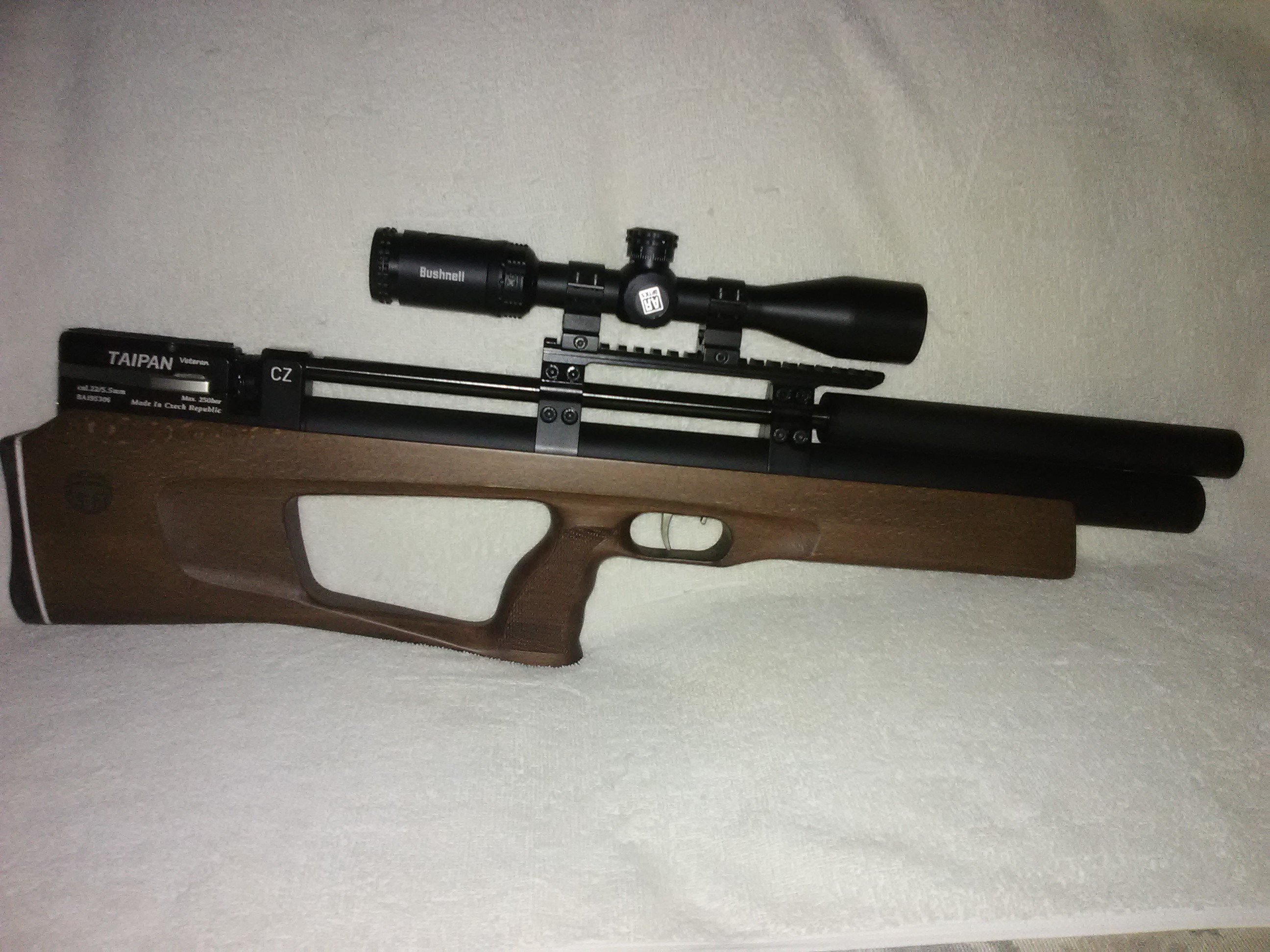

I've two original Veterans, .22 Standard and .25 Long, both in Beech. After good barrel cleaning, .22 shot JSB 18.1s out-of-the-box dead accurate, .25 didn't care for JSB 25.39s, dead on with 33.95s after 3/4 crank in on hammer spring @ 58 FPE. Of all my .25 PCPs, Taipan only one that doesn't care if 33.95s are MK1 or MKII. No moderator needed, both are simple and tough. Rear cocking can take getting used to but never bothered me. With increased interest in next generation, opportunity for buying a good used original should improve. WM

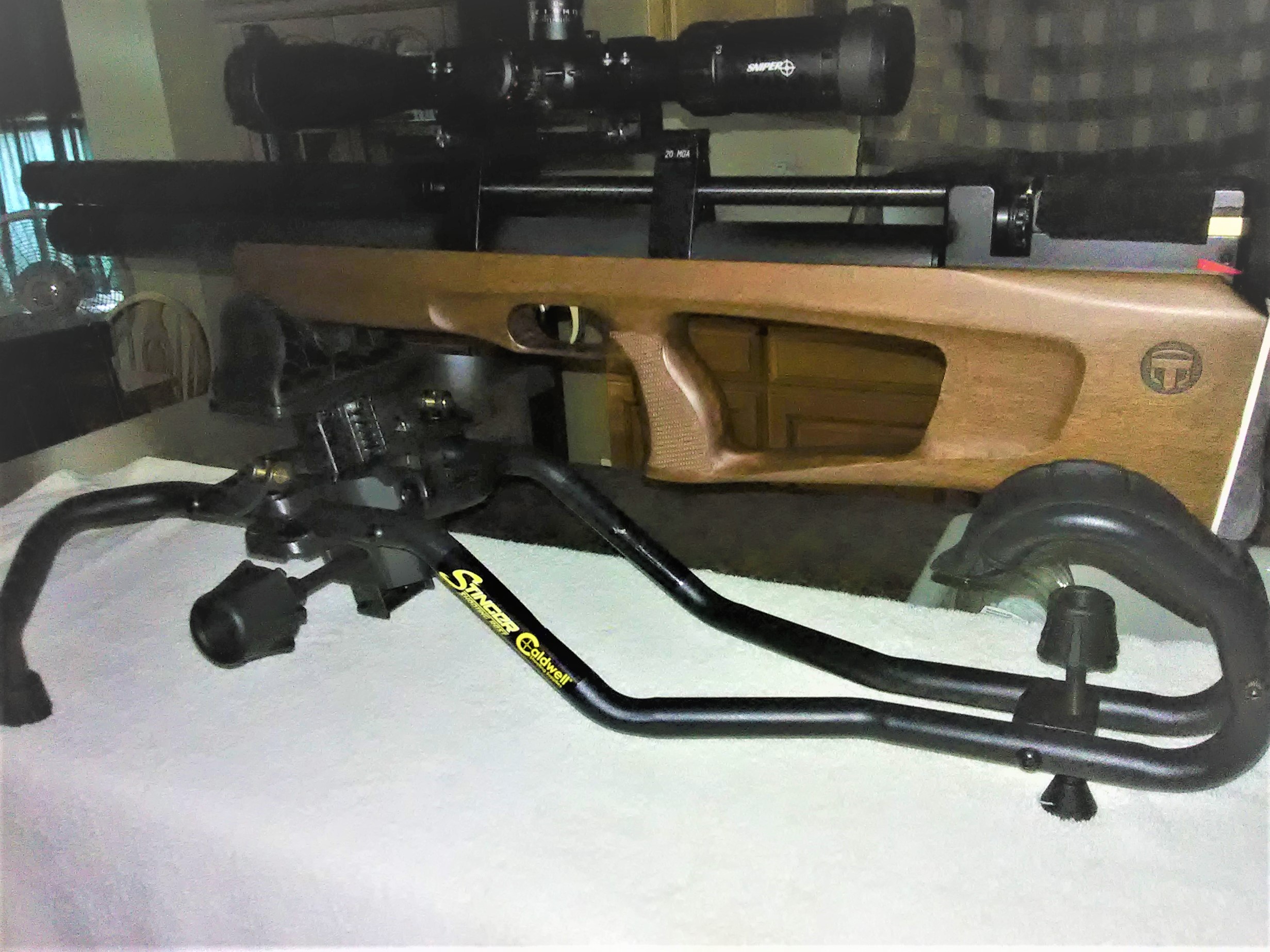

That's the .25. Used small piece of red electrical tape to mark factory setting of hammer spring for reference. Used black felt tape for cheek rest as receiver gets cold, you can see it just above red tape. Really love my Taipans, they instill complete confidence for pesting and hunting, they'll never let you down. WM
