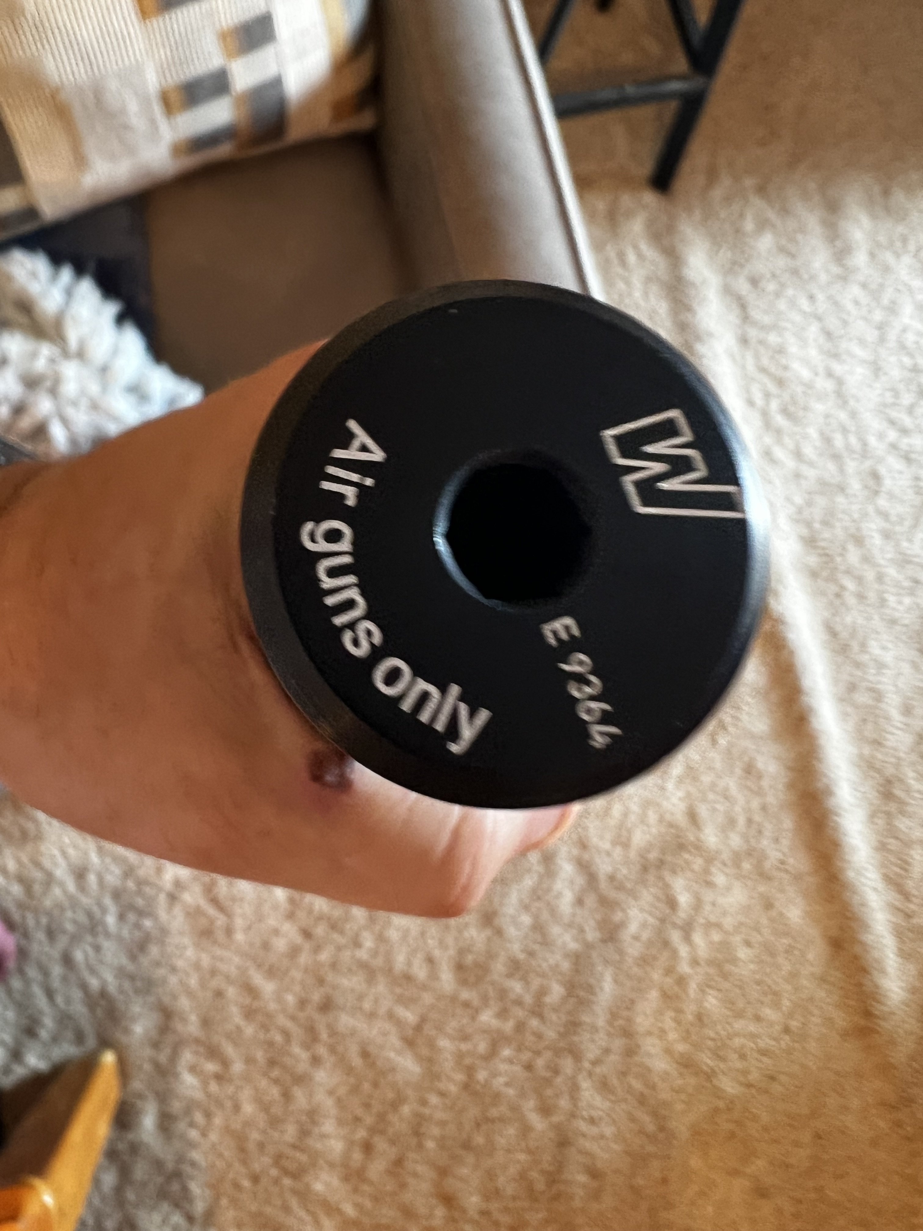

I agree the 50 is harder to cock than the 30, just about every springer is harder to cock. The 30 is butter. But I added a Weihrauch suppressor to the 50 and it made it a lot easier to cock. I don’t know about the sound but the leverage was super and only $110., a deal. I just bought the 95 N pro field coming tomorrow. I bought it for many reasons but cocking effor, weight and length were 3 primary requirements. And I can unscrew the OEM weight and screw on an OB160 and not only will it add some leverage it significantly silences the bark. I’ll let you know if it’s true.
I added the HW moderators to my 30 and 50.They look good and "might" quiet them a little bit.The big advantage as you mentioned is a pickle on the end if the barrel to help cocking them.
Reactions: Bandito and wgd
I would choose a UK spec HW95 over the HW50 in .177. Basically the same power level, but the longer barrel will be easier to cock. The short barrel HW50 may be slightly more manuverable in the field if you stalk squirrels or iguanas in the woods, I do not. I would like to get a full power HW95 in .20 to try sometime, may be a good balance of power and trajectory.
I own both just add the Weihrauch suppressors, yes both work and significantly reduce cocking effort.

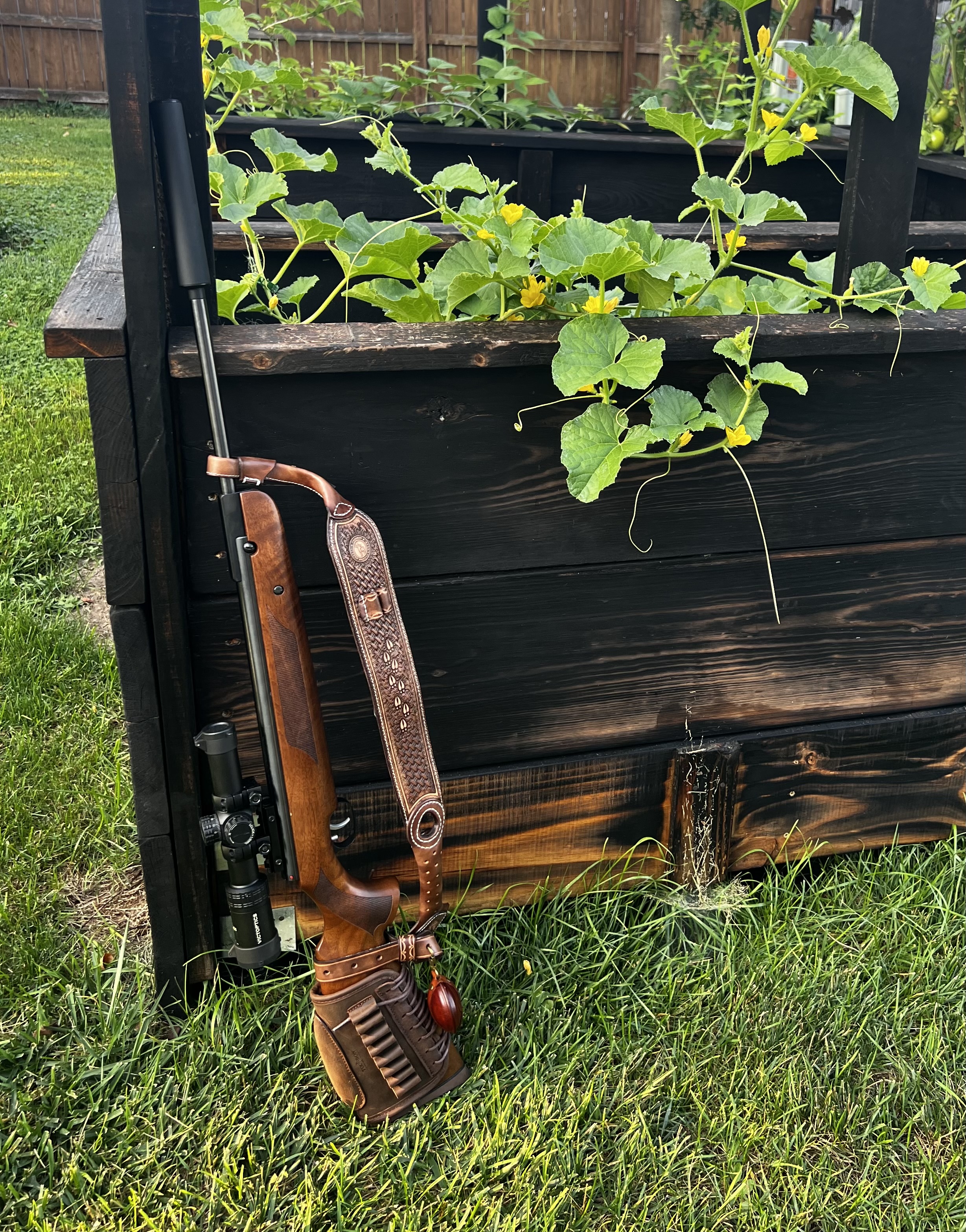

I have an HW 95L with H&N .177 field trophy pellets. I was playing around at about 20-30 yards to start on different days. I was sitting down since I'm disabled and I was hitting pretty much where I aimed it.
A question how often do you have to tighten up the rear sight? Same goes for the rest of the screws. After just 2 sessions The 95 is a great rifle.

Reading between the lines, you tweaked my decision with your exceptional lawyer/politician response. Skills honed to not diss anyone or any thing in the slightest. So I spent twice the money and went all in on a new HW95N Walnut Field Pro. What pushed me over the edge was the ability to screw on a 1/2 UNF accessory only on the Field Pro, that's huge. I require as much peace and quiet as possible. Thanks again.
Love mine. Have only had it a month. I do prefer the older gold trigger vs the new silver. But that’s easy to look past.
