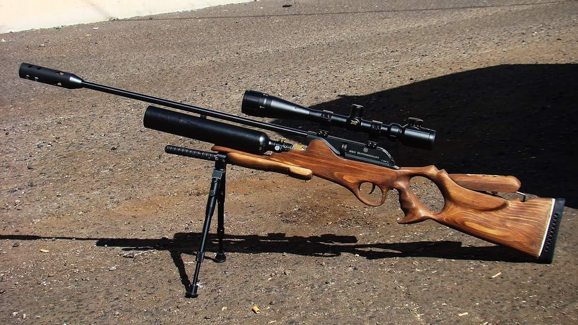

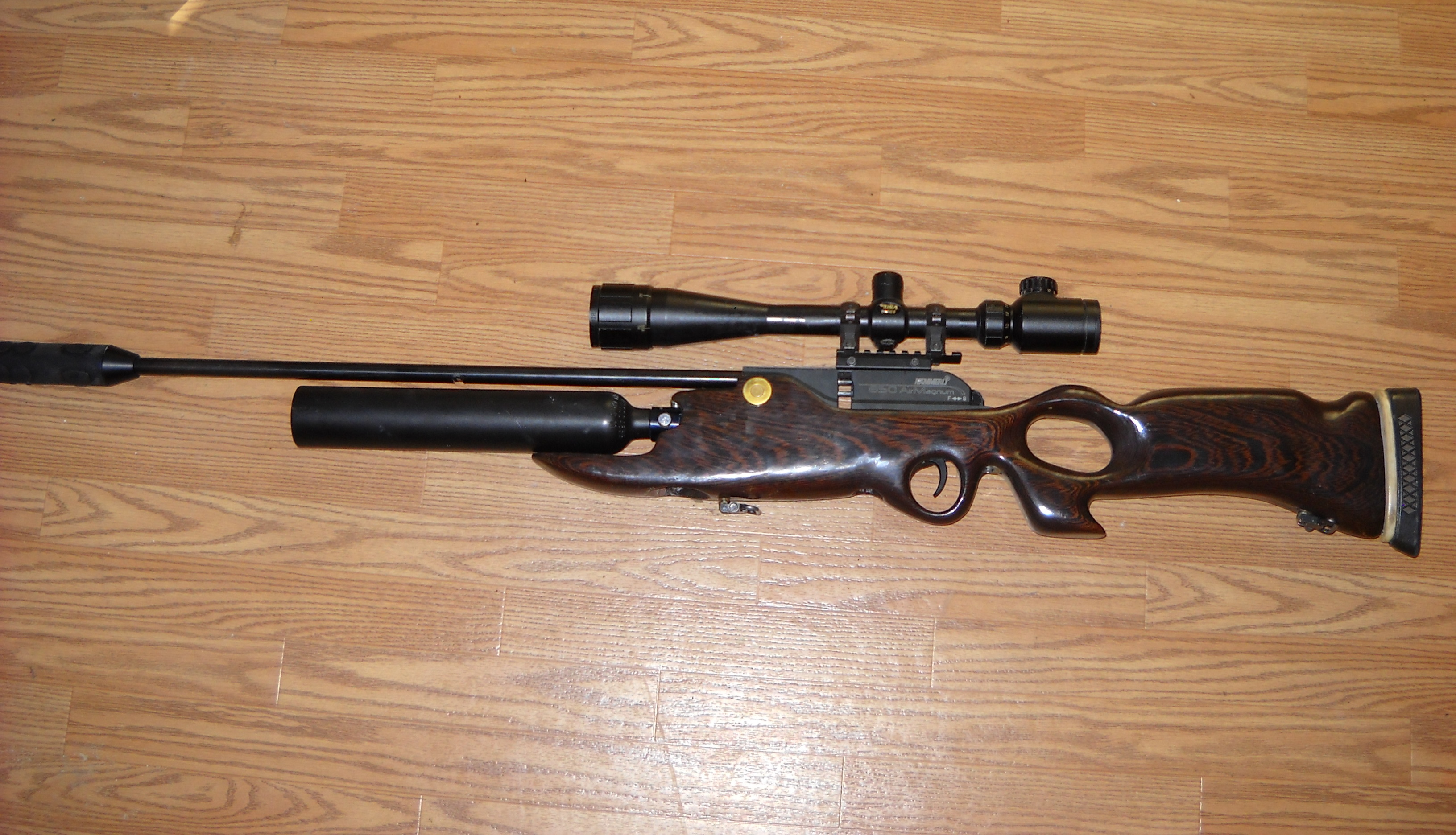

if you like tinkering and want a solid pop rifle an 850 air magnum conversion would be in your price range and they can be as accurate as most in the price range, the conversion is not a hard or tedious project, around $300 for the gun $200 for the tank and reg, $50 for a bottle adapter, maybe $5 in stronger spring, some studying at the 850 store archives, some ez cleaning and polishing to the action inside, simple trigger mod and you can use the stock it comes with or make your own if you want wood.. my 177 version was one of the most consistently accurate guns ive owned and in building your own set up is a learning experience that changed my whole airgun hobby into a more satisfying and contemplative place where aloot new doors open to add your own creativity to the mix. Ive been into airguns for 45 years and building my own provided a way for me to understand a lot more of what it takes to get accuracy out of an airgun and added a whole new dimension to the hobby that has been challenging, informative and satisfying as hell... here are a 177 and 22 I built about 10 yrs ago.. I just used the original plastic stock to get the design to fit the action correctly cause I Like wood much better.. both are tack drivers in close and even at 50 yds or more the groups were better than any similar priced airgun I'd owned up till then, I own a fx impact m3 now and it is a far superior gun to the 850 in every way, except I can't really figure out how to make a wood stock to fit its build without
being to fat and heavy... still pondering it tho....
