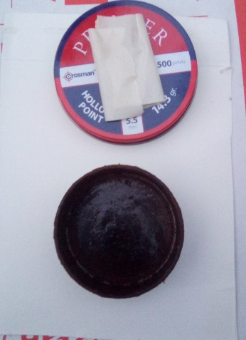

A nice 100y bull i like is a crosman tin painted black on a white cboard/ backing. Its 3" so any all in is good for general shots.. the 2-1/2" snuff can i like at 75. I dont scope just factory irons and ot works well for my eyes.
Anyway you get a cheap clear distinct aim at point.
