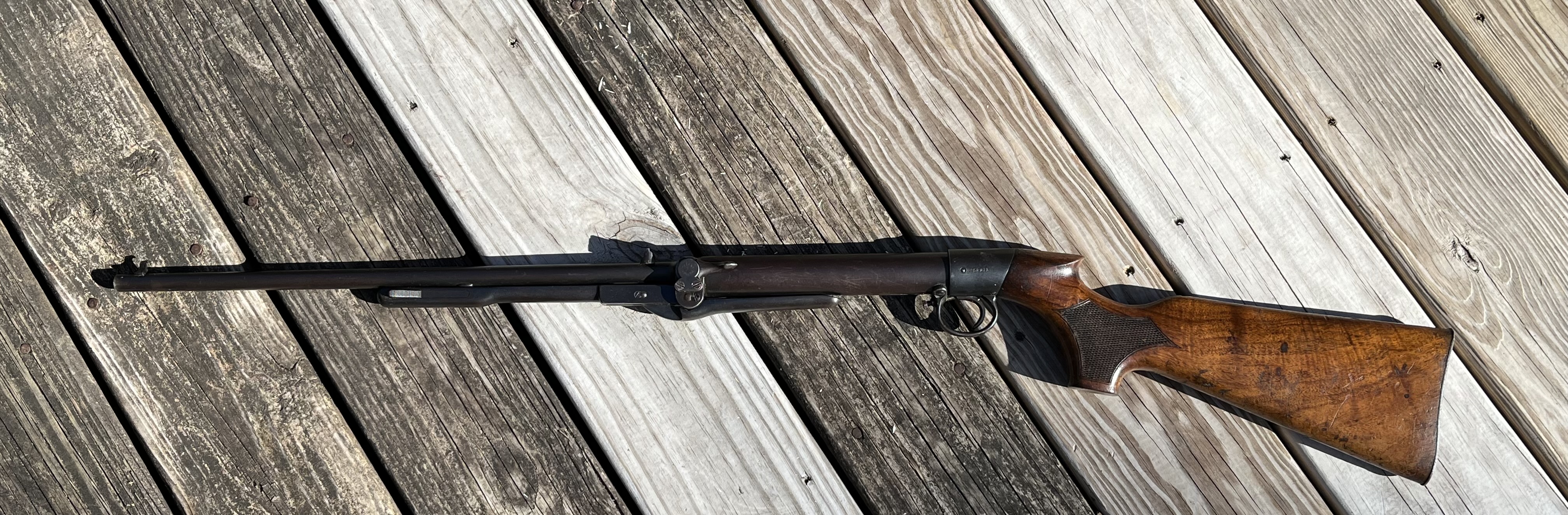

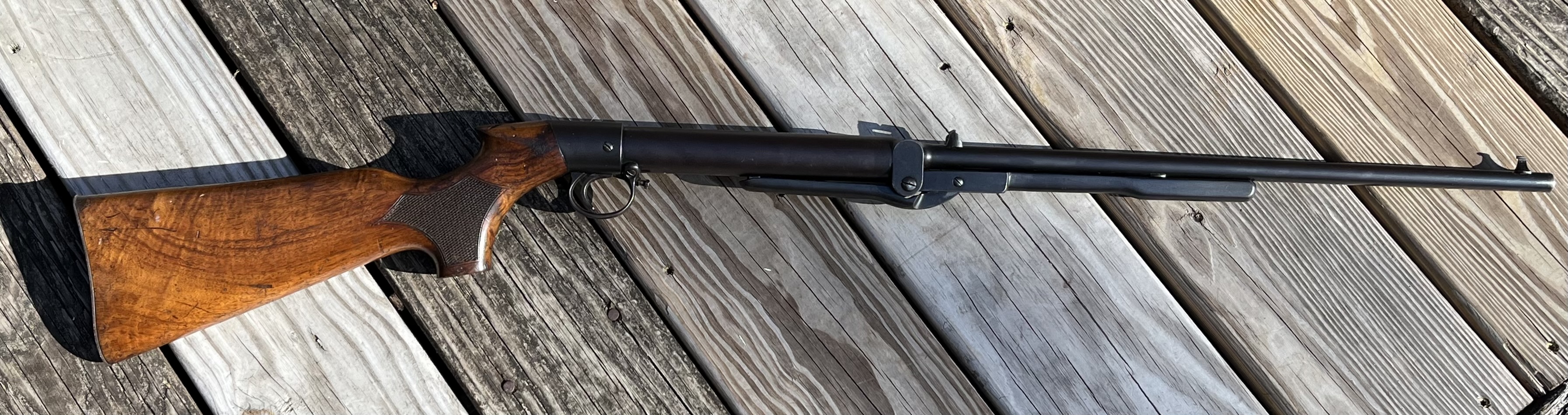

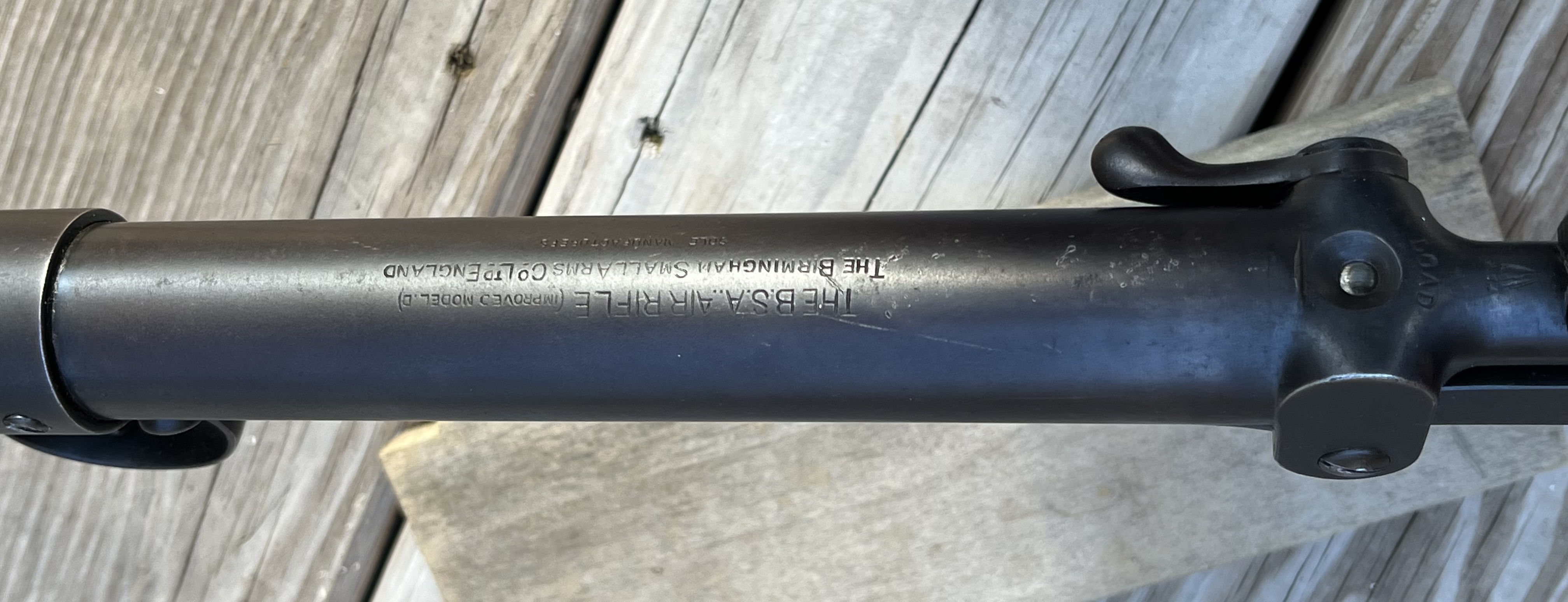

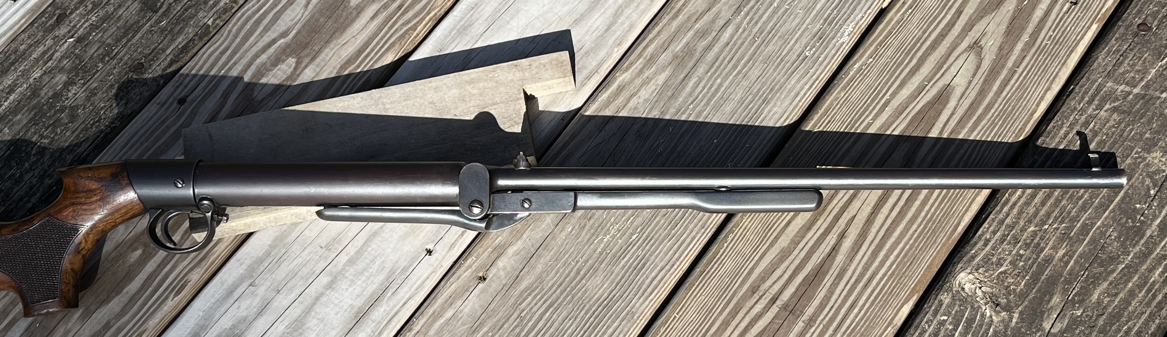

BSA Improved Model D. 1912 Light pattern 177

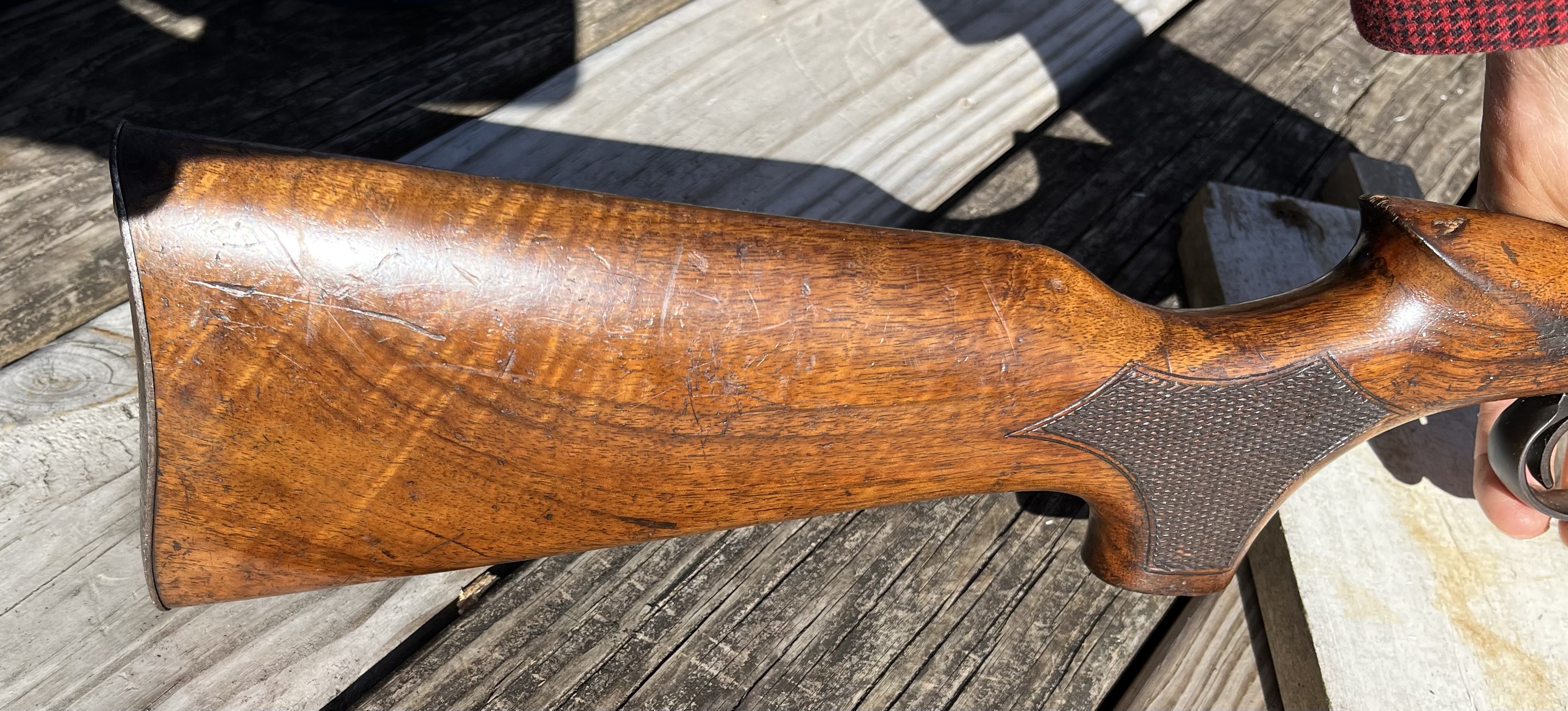

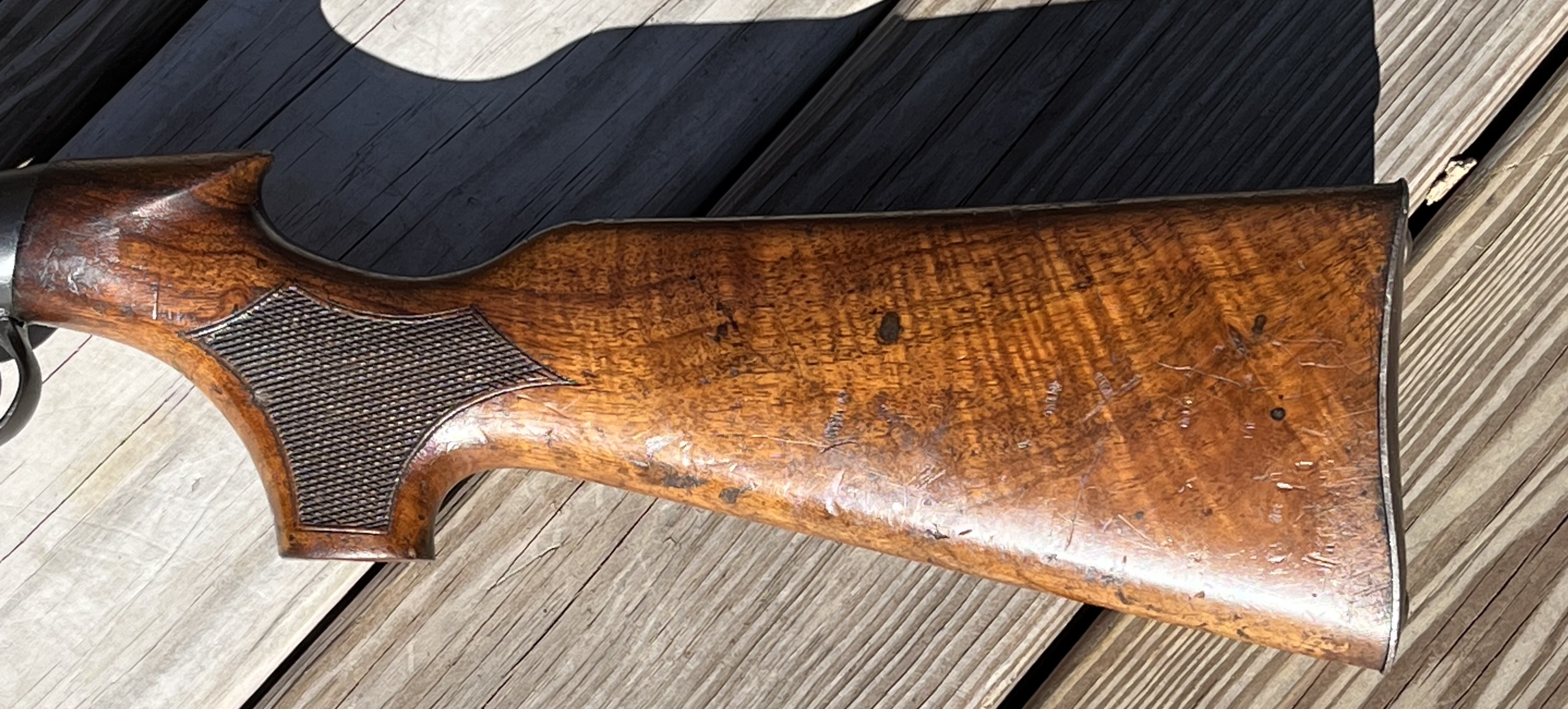

Pretty figured stock.

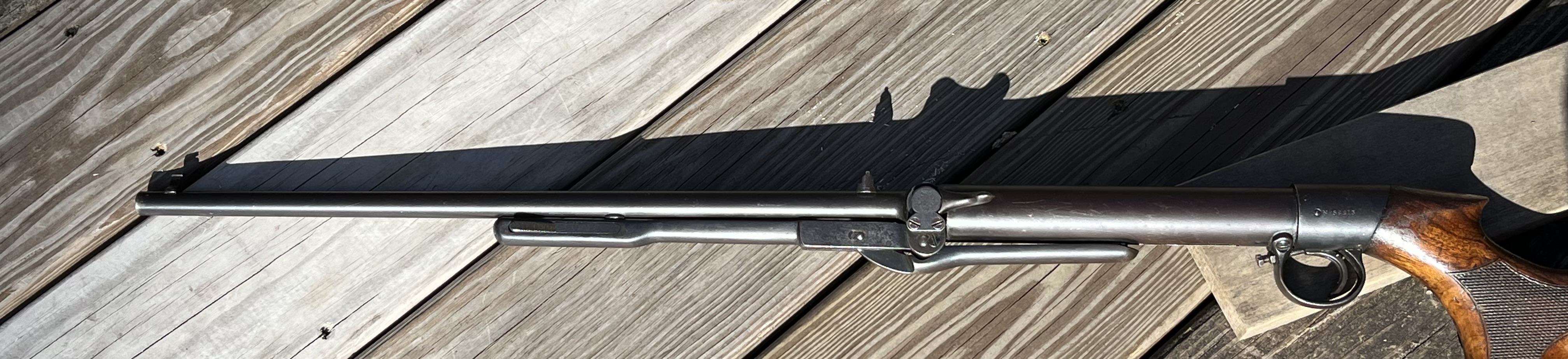

The gun cleaned up nicely. Typical plum brown compression tube.

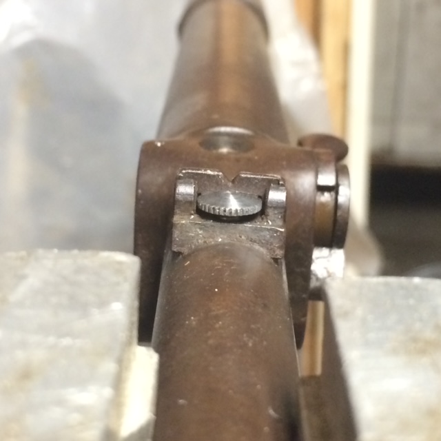

Spring and seal feel good. Original oval wire spring. It’s always good to open these BSA’s up because primates have very often put BB’s in the tap and they end up imbedded in the seal after they destroy the fixing screw. If there’s one BB there’s usually several more.

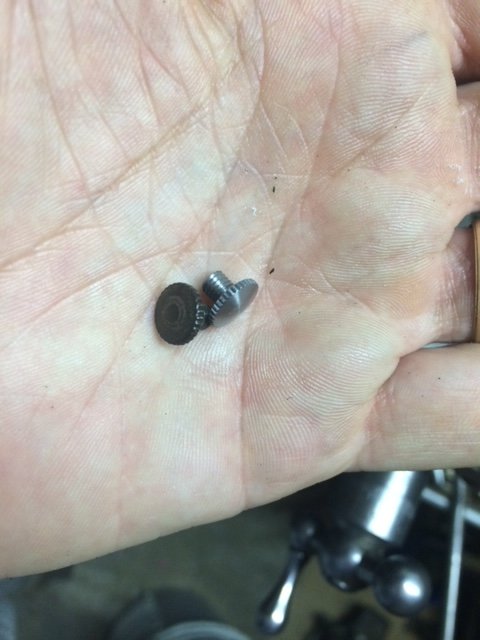

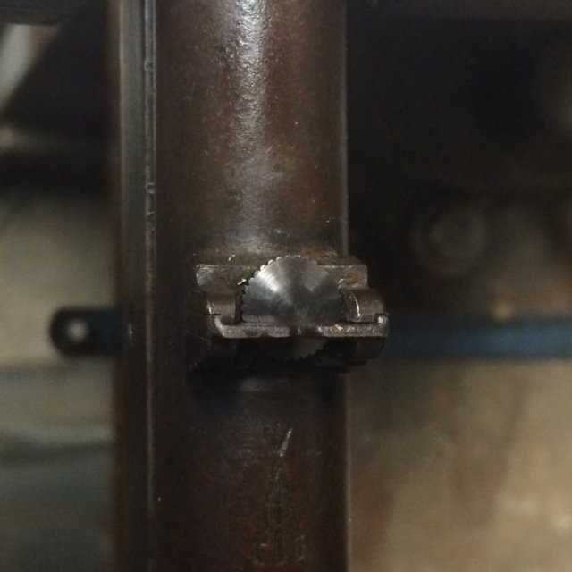

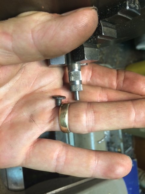

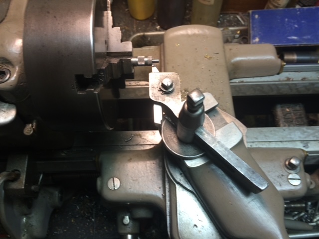

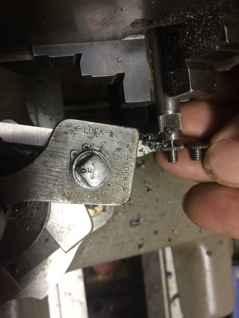

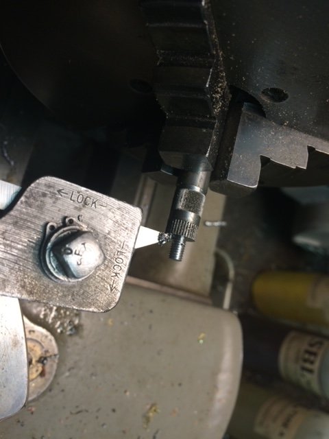

The knurled sight elevation screw is missing but I’ve made them before
