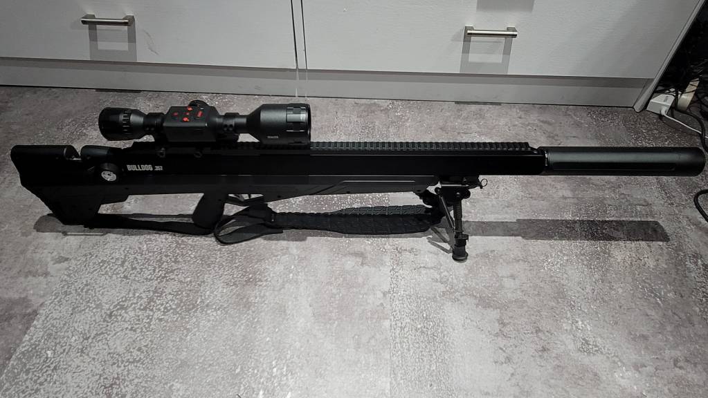

I have leaned towards using a lot of power for my nighttime setup for raccoons using the Benjamin Bulldog .357 with the ATN Thor 4 thermal scope. I use 110gr NSA slugs and Predator Polymags both to excellent effect, but the slugs over-penetrate retaining maybe half of their energy. The Predator Polymags out of the same gun drop them just as dead, but with no passthroughs on bodyshots. I also use the DonnyFL Emperor suppressor to keep things somewhat quiet.
Here is a Polymag dropping a raccoon at 25 yards from my window with the Polymags.

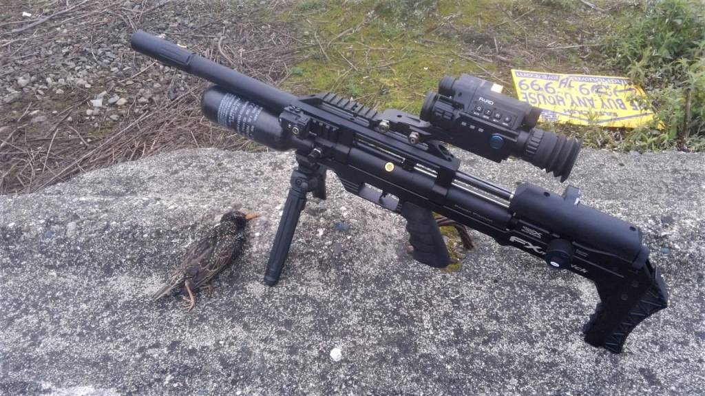

I'm running a PARD 008LRF on my FX Maverick. That 6.5x magnification and tiny FOV is a handicap at "inside a barn" ranges let alone inside a chicken coop range. For really close range, I use a green laser mounted on the side, parallel to the bore. You can see it in the picture, just behind the cylinder.
ETA- The Estarkey thermal route would be awesome for ratting. I'd still look for as much FOV as possible. Something like a AGM TS25-384 or a Bering Optics Hogster R25 both have 78 feet/100 yard FOV @ 1.5x magnification. The ATN Thor 4 has 84 feet/100 yard FOV @ 1.25 magnification. Those are base models that cost right around $2k.

@Hal4son, I love the look of that PARD on your Maverick! Can the scope be mounted without the bracket so the scope height is reduced? I was thinking about getting one for my Maverick .30cal at the ATN is quite heavy.

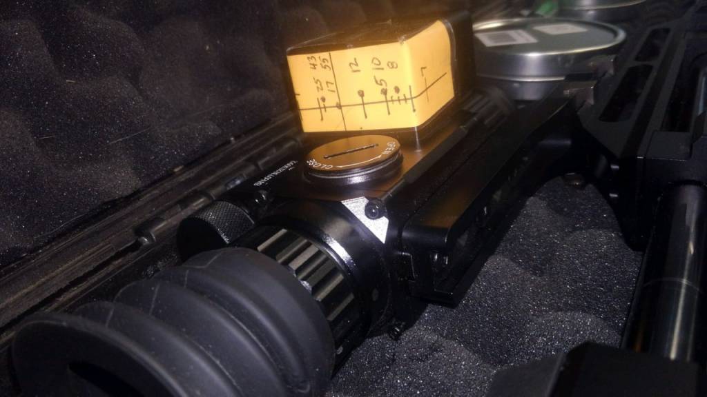

@estarkey7 I don't think you can get it much lower as the mount is screwed into the bottom of the PARD. It's a comfortable height on the Maverick as it is. The center of the objective to the centerline of the bore is about 3-1/4". While a high mount causes issues inside of 12 yards, it makes the gun appear super flat shooting between 17 and 55. A lower mount would not have those same holdovers.
I like the PARD. However I would like it more if it had twice the FOV even if it cost me most of the magnification. That 6.5x is good out to 200+ yards shooting coyotes at night (PB). But it's really tight picking starlings out of the trees inside of 20. If it was a 2x and had 50' FOV it would be a most formidable optic. Especially when tied to that fantasticly accurate LRF.
