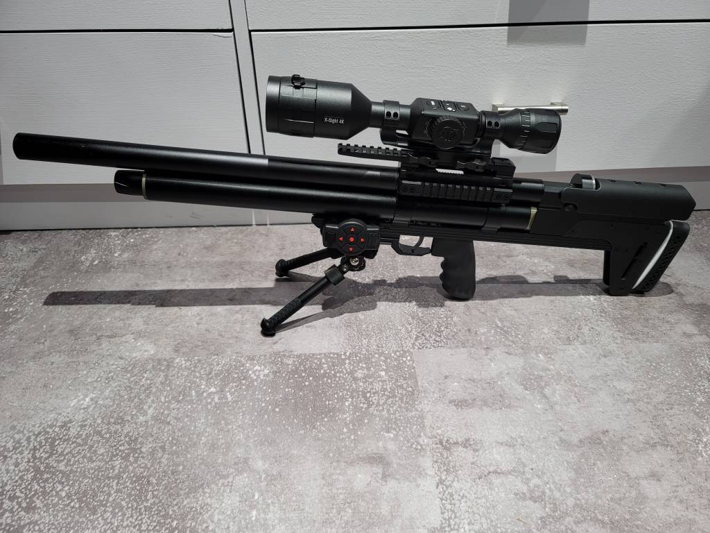

I can't speak to any night vision other than the ATN. I have both the X-site II and the 4K, both in 3-14X. The ATN is awesome both in day or night mode. Adjusting the screen brightness down really helps with eye fatigue at night. A better illuminator than the one that comes with it helps a lot, too. It's not bad with the factory illuminator, but it is definitely better with the upgrade. Another thing I disliked about the factory illuminator is that it uses CR123A batteries, instead of rechargeable li-ion batteries. Not a deal breaker since a family member gave me a case of them when they stopped using them at work. The ability to record video and photos makes it easy to share with others, or just review my own shooting. Weight isn't really an issue for me as I use a shooting stick or other support. Picking out the target animal is very easy when you see how brightly their eyes shine in the IR light.
