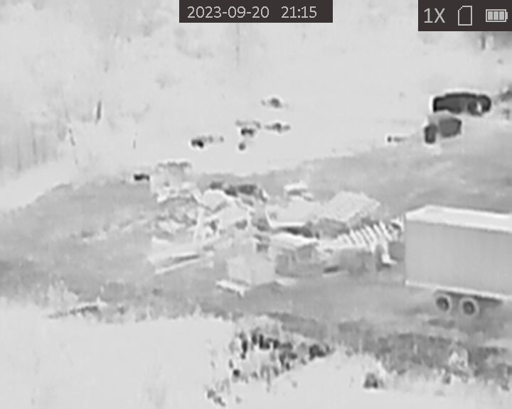

I wrote an article on What Thermal Optics Bring To Airgunners over on the Reddit airgun sub. Not that you need to know this, as I think you have a good idea about what this brings, but I do have a few comparison images between my AGM Taipan 256px monocle and my ATN THOR 4 2-25 640px scope. This will help you decide how much resolution you really need. I will include a few of the images here just in case you prefer not to go over to reddit.

The same shot with the AGM Taipan 10-256px monocle.

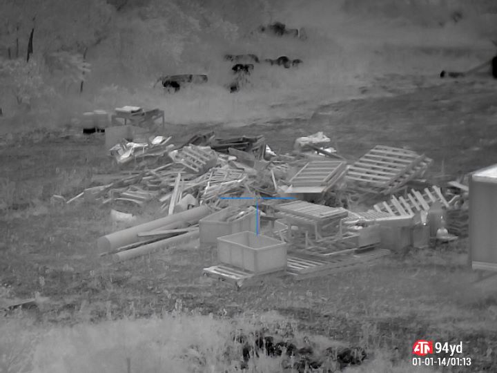

As you can see, the higher resolution thermal provides a significant increase in resolved detail.

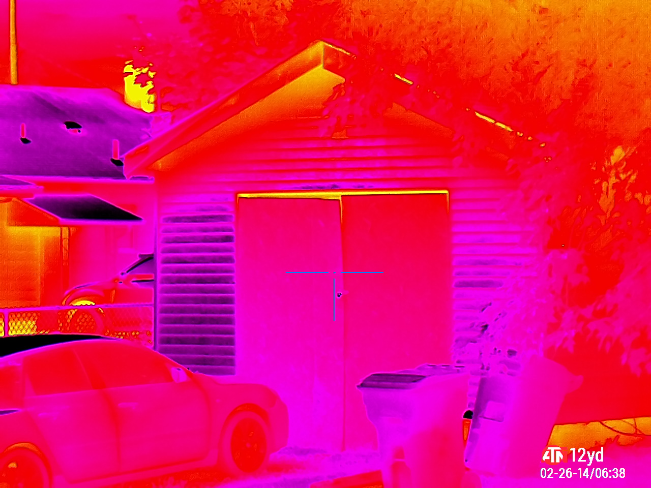

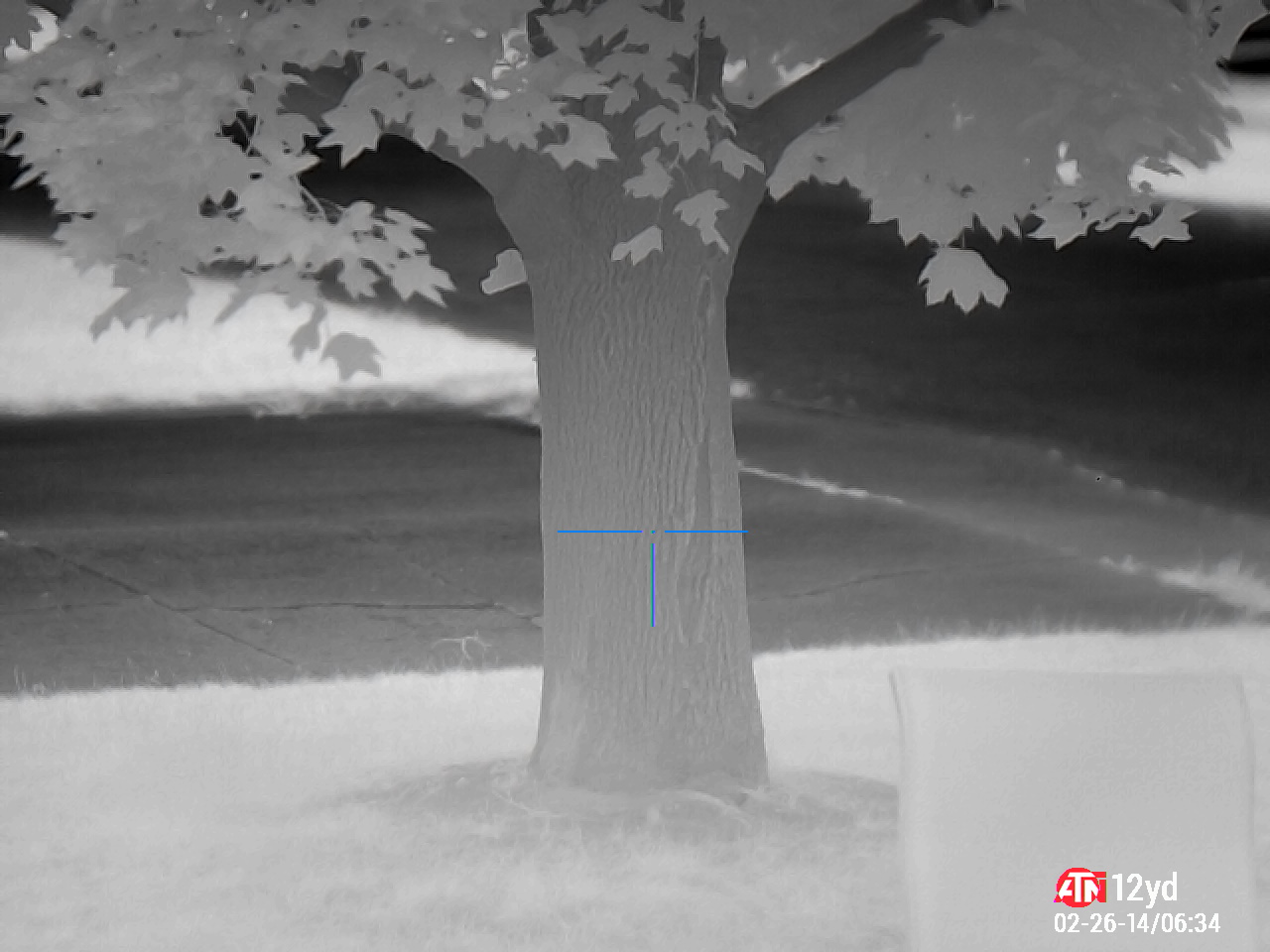

A thermal will love it if the target is hotter than ambient, but I can also clearly see any temperature differences, even if the temp difference is just a 1/20th of a degree on the surface of the same object. I just took some photos outside of my home with various objects that should be the same temperature, and you can see that the detail in these items is clearly visible. All photos taken with the ATN THoR 4 640 2.5-25x scope at 2.5x zoom. I have no clue if my scope can detect a bullfrog in a swamp, or other cold blooded animals. But I can clearly see things that should be very close to the ambient temp.
My neighbor's trashy garage and broke down car: Each plank on the garage are clearly visible even at 11pm.
The bark on my tree is clearly visible.
Even more temperature differences are detectable when using a different thermal profile.
