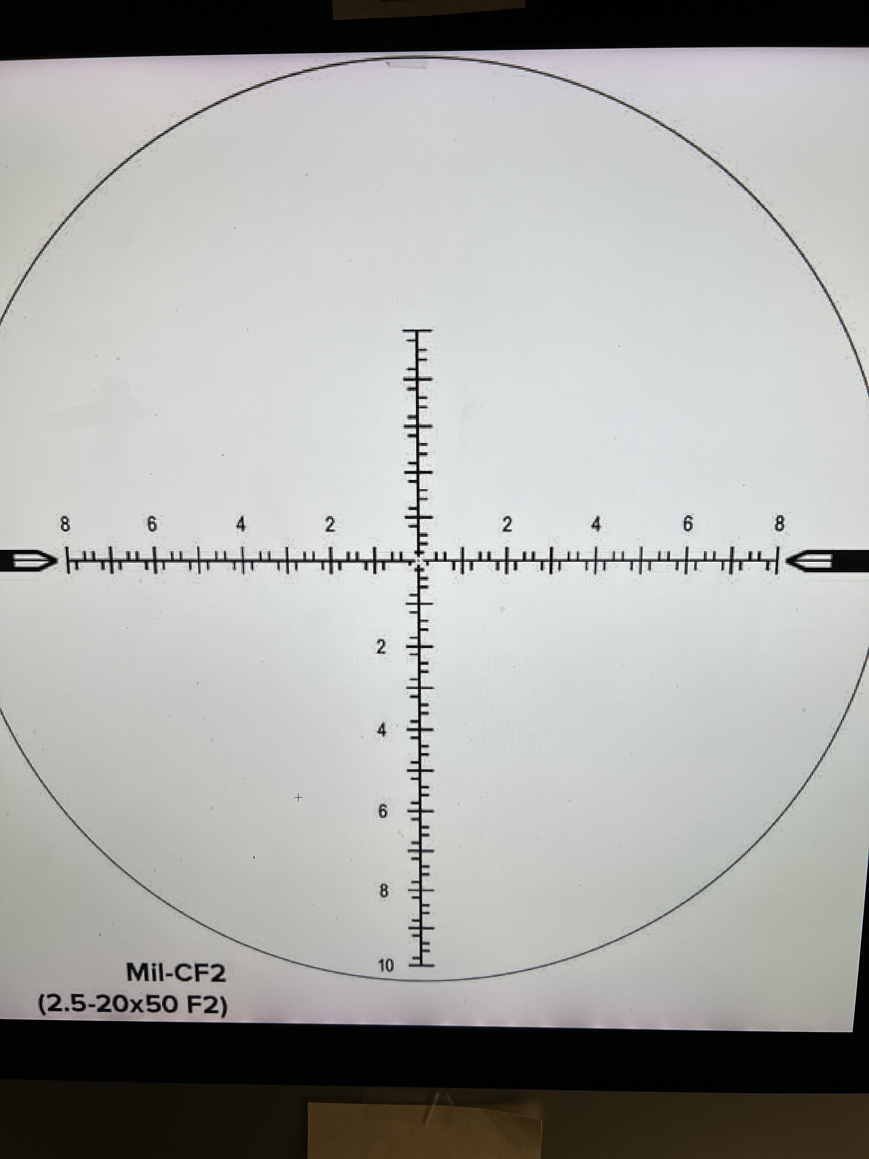

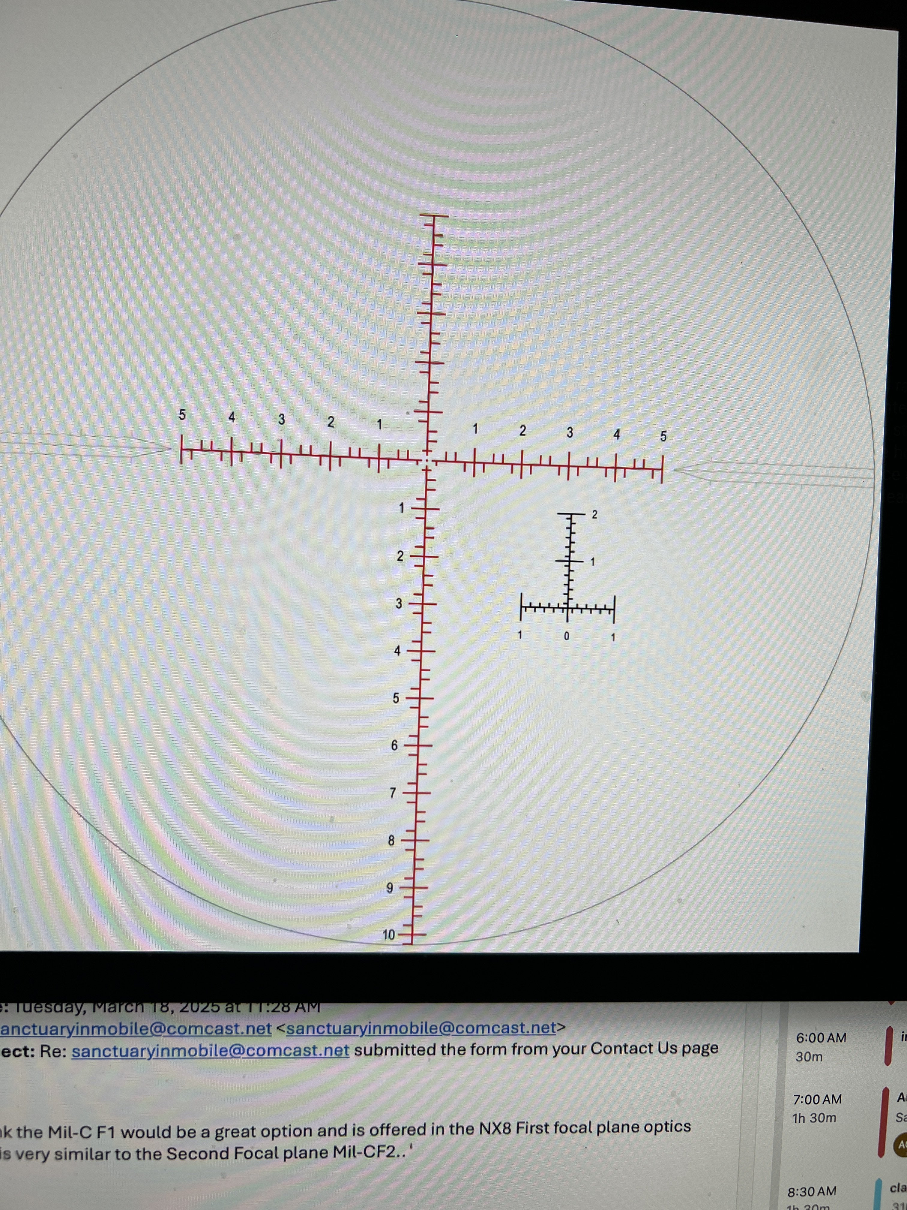

im looking at these two on two different NF models the CF2 on the 2.5 is definitely thicker or easier to my eyes at 16X.
i also like the NF Mil-XT
View attachment 551116View attachment 551117
Thanks. I would (personally) like more illumination points on the CF2 and more space around the dot; otherwise, I like the reticle's layout. I also slightly prefer the less-cluttered center dot on the Mil-C. Yes, the Mil-XT is nice if you want the tree. I go back and forth too. S7
