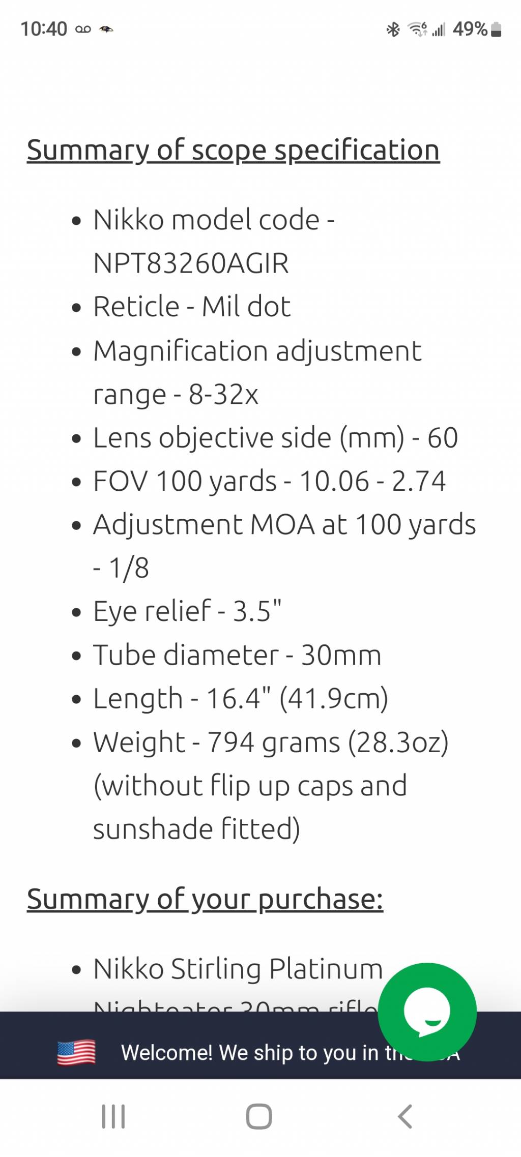

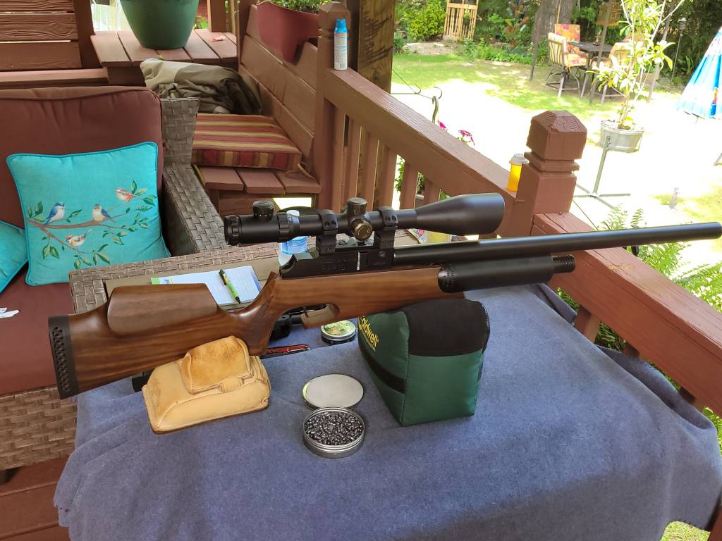

I got this scope recently from second hand (I am the third hand already). I am a big fan of Japanese scopes, the price to glass quality is right (unless shovelling money for the German/Swiss glass), also I am shooting rings only, so SFP.

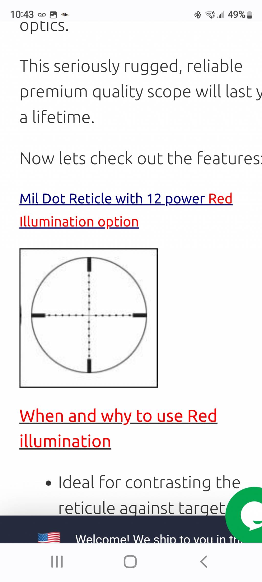

Trying to input this reticle into the Strelok Pro, and asking for the ranging magnification where this reticle was zeroed? Also I would need it to set my own parallax.
The Nikko Stirling website doesn't help and the "contacts" page appears to be down. (Oh I just hate those websites setup with very light squared boxes, you cannot see where are those placed on the screen)
My Falcon X50 (10-50x60 SFP) for example was calibrated for 1MOA at x25 power at 100 yards. Following that logic shall I take a mid power as a default?
Anybody can help me with the scope original doc, in pdf maybe?

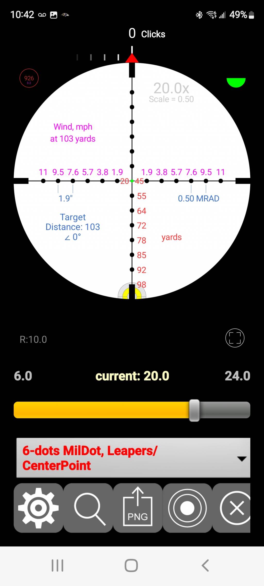

Bighun, this may help. If it has the 6 dot mil-dot reticle like this photo just use the utg 6 dot. The clicks are 1/8. Nice glass. I have the 6-24 on my Rapid mkll .20. Hope this help.

I just got back from my club. Picked a 50 M target with a power of x10, the parallax error was visible (if I force it) but acceptable for normal shooting.
Pretty much happy with a scope. Next is to see how can I remove the elevation turret cap? I got this scope from a FT guy ;) and would like to tighten the clicks a bit, diy.
Removed - cleaned - greesed the turret caps, feels much better now
