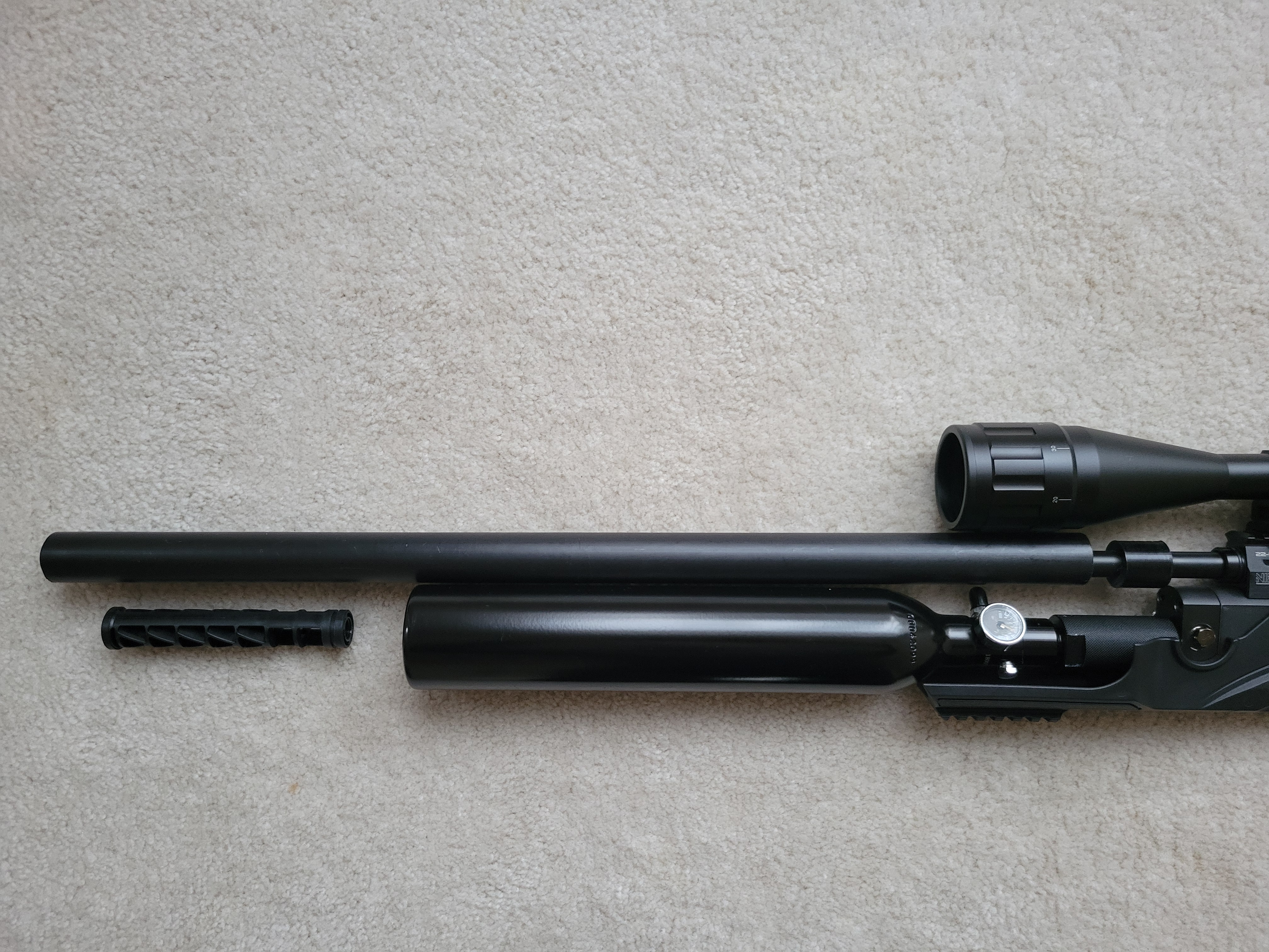

For the shroud I used:
-plastic tube (from Home Depot), about 1" ID, and almost 24" long
-Crosman 1/2-20 threaded baffle which screws on the barrel, wrapped in duct tape to get a tight fit against the tube
-3D printed (from TPU) barrel bushing which supports the rear end of the shroud

- I added a shroud
It just makes the barrel look thicker.
