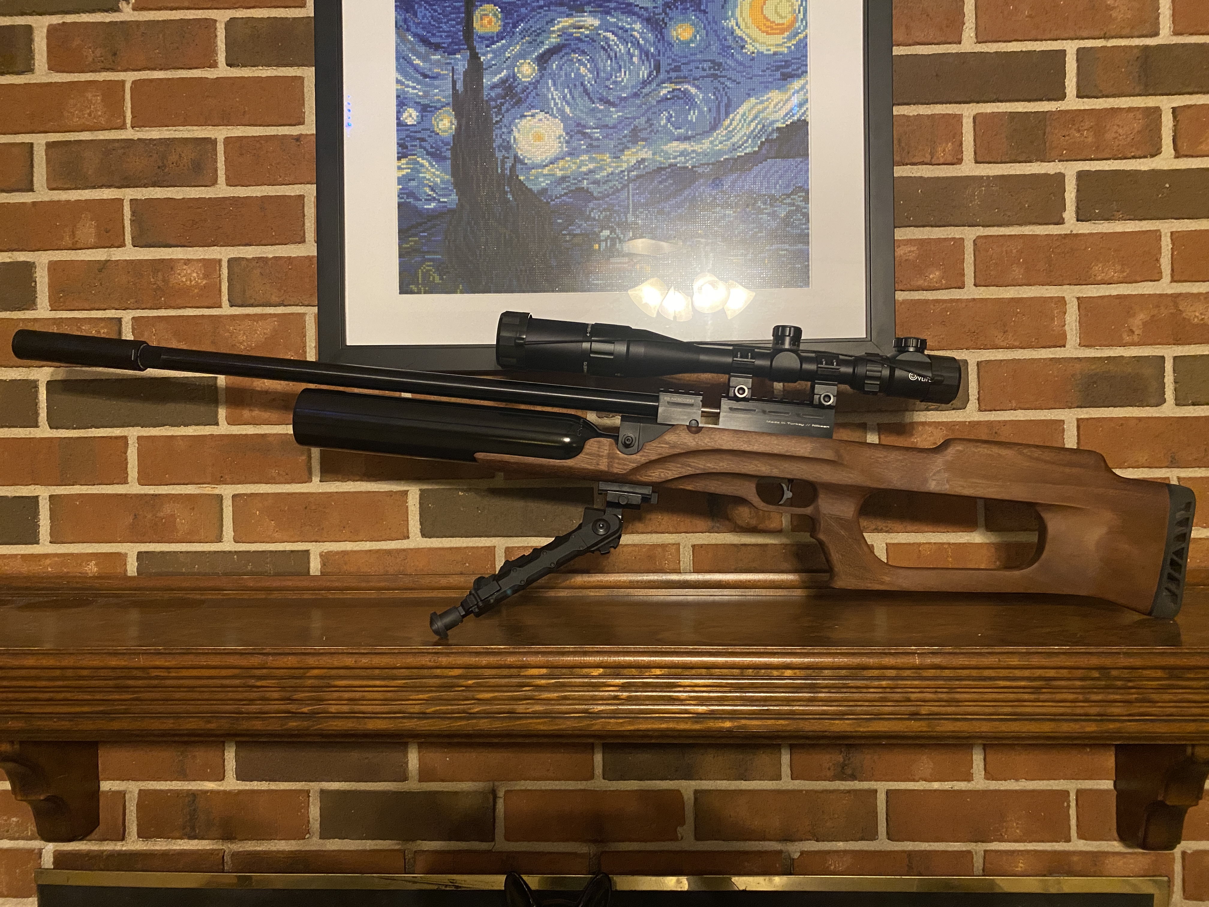

I have the TW and really like the it. It's an accurate, good looking setup, for sure. So far it seems to like the heavier pellets (34) in both FX and JSB. I am trying the JTS pellets next. AEA's after that. The one drawback about the TW, IMO, is that it really requires a bottle clamp for the bipod to be where I want it. The TS has the in the right location. I could add the mount to the wood stock, but it doesnt seem like it would support it too well. Again, my 2 cents. Oh, and I purchased mine from DonnyFL. Great expereince.

An update to my last response. I have right around 2500 pellets through my Ozark. Getting to know this gun, I have gone through some frustrating moments. The hammer spring adjustment ultimately has very little adjustment capabilities. Which, in the end isnt that big of deal and the optimum tune is how I received it from DonnyFL. That wasnt the frustrating part (that was actually fun). I wrestled with both a scope issue and a dirty barrel issue. very long story short, a new scope and a good cleaning later, this 25 cal gun prefers 25 grain pellets. Based on the comparison of four, JTS and AEA were neck/neck at both 25 and 50. JSB performed great at 25. FX...not as good.

The more I shoot mine the more I love it as well. Yeah, the HS is not adjustable on this gun if it's a US model from DonnyFL or one of the partners that sell it like the pellet shop. It turns but makes no difference. It will stop the gun from cocking if you turn it in too far. It's supposed to have the correct hammer spring in it which is a fair bit heavier to meet the "DonnyFL Spec." The only adjustment on the gun is the transfer port. I personally wouldn't mess with it. I turned mine down because I just want between 800 and 850FPS for the .22 18.13 JSB Jumbo Exacts mine is such a fan of and it ended up causing an O-ring to burst on my valve stem. Also, because I wanted more shots per fill. So, I just run the TP wide open and that "HS adjuster" that does nothing, flush with the rear of the receiver and she runs like a sewing machine. If your gun ever starts honking at you like a goose that O-ring has broken. Right before it goes it will make an oscillating sound and get really loud even with a moderator on it. The tune right out of the box is how this gun was meant to run, and it runs well with the stock tune which really isn't stock. Just need to find a pellet it loves and have a ball with it. As far as the barrel goes, they ship with grease in them to protect the barrel and thoroughly cleaning the barrel on a new gun should be the very first thing you do after a function check.
Well, I didnt know what it was, but from what you said, my valve stem o-ring is blown. It shoots when its's all the way open, but doesnt sound quite like it did before. Thanks for the info. I guess I know what I will be doing over the weekend. Yeah, I have tried the HS in all those positions. I measured what it was before my adjustments. It's back to the DonnyFL tune. So, i guess it's tear-down time to get to that o-ring.

I had a spare in my parts bag. Make sure you use some silicone grease, sparingly, on it and make sure the sharp area of the receiver it slides into doesn't cut it when you replace it. Just be gentle. I nicked mine a tiny bit and figured it would be fine, nope. Luckily, I have a few O-ring kits I bought and have plenty of replacements. You want a good tight O-ring that doesn't get cut or nicked when inserting it into its home in the receiver. It's not difficult to repair either. Just start pulling it apart from the front and it will stand out like a sore thumb. Best of luck. Hey, did yours start slinging the crap out of your ammo even though it's burning up air like crazy and has a broken seal? Mine started shooting better but it was obviously in need of repair.
Yes, mine is shooting GREAT! Very tight groups. I can shoot two clips without getting through the curve. Basically, shot 20 drops dramatically. mine is a 25, so it may be a bit different on that front. I am seriously considering buying another one. I like to tinker. In fact, that is what I like most about this hobby. So I may see what one of these does when the air has more space to go through...open it up a bit. Then...maybe a regulator. Just thinking. Keep one stock, though.
