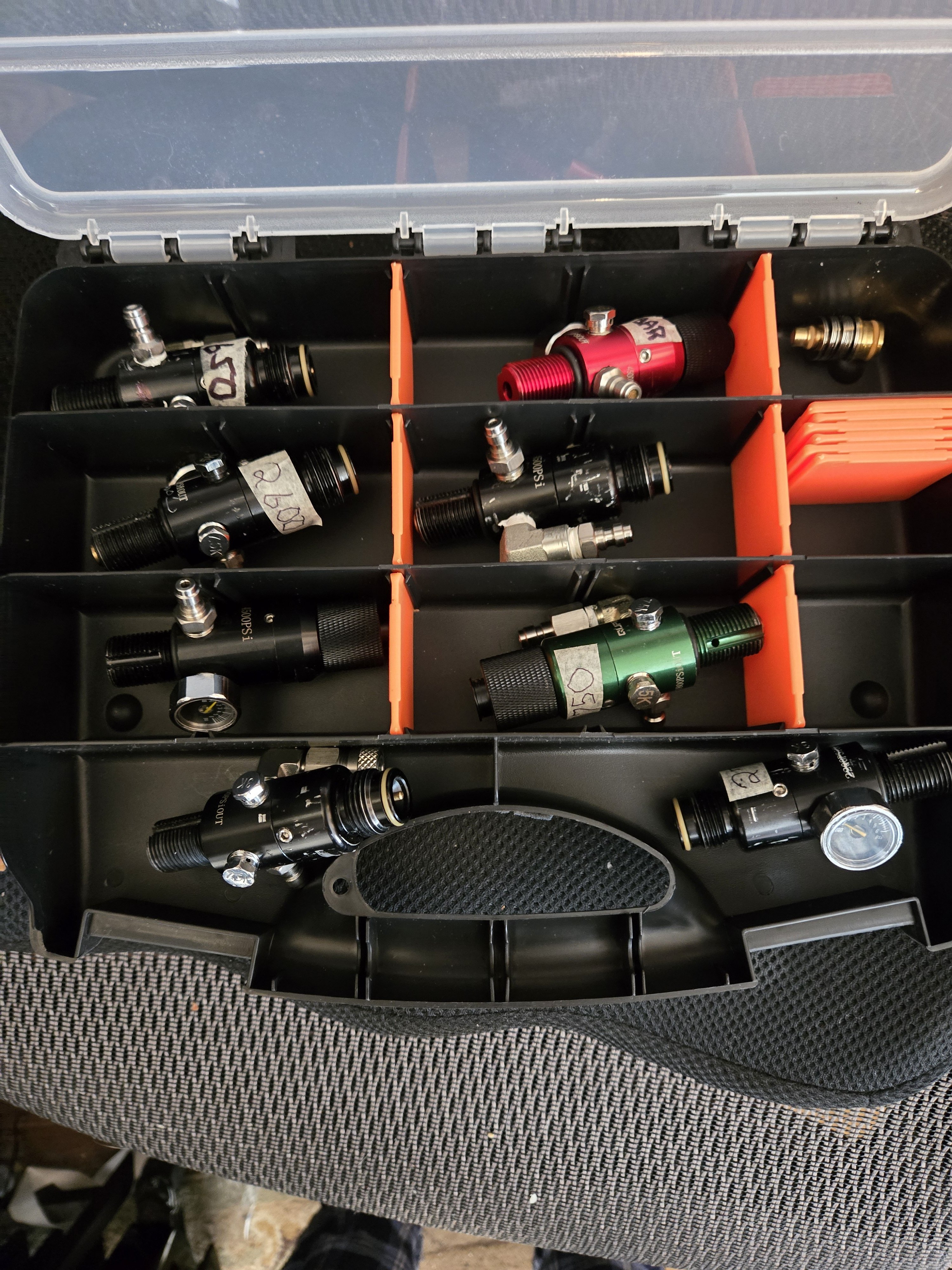

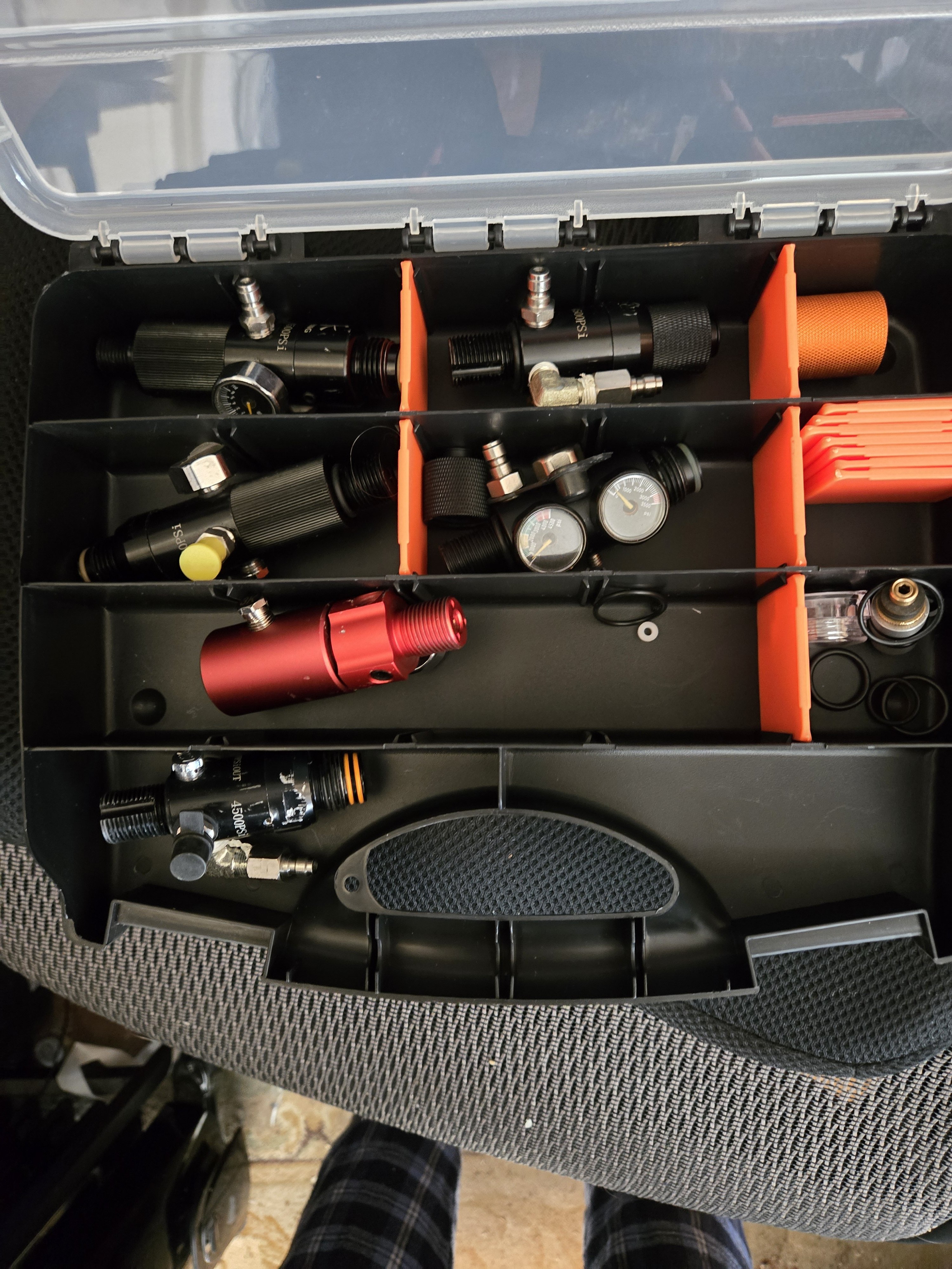

I have more than a few of those regulators. Taught myself a lot about Belleville washers. But I learned they are not the most stable regulator. Tended to drift quite a bit over time. Mostly use Huben Power regulators nowdays. My Ozark S .22 has the Cricket Max-ATH. Which kind of shoots down all the money saved buying the Niksan 😯.

As I said, own a few I modified.
But in the end the Huben were just so much better.
I do own 2 of the knock-off Huben from AliExpress. But I found out they were knock-off and started using the real deal. Don't know if the knock-off are as good or not don't want to find out they are not...

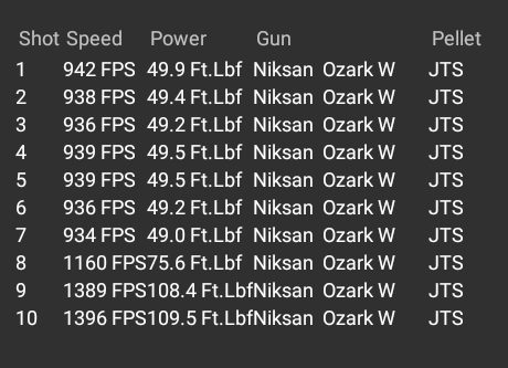

so much for my super consistent gun just chrono'd it again and its got a super fast sweet spot and it does this for 3 to 4 mpore shots then drops back to the
low nines
