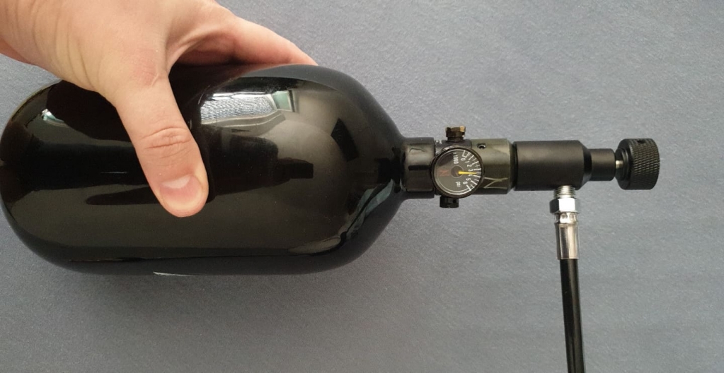

Ninja bottle 4500psi 68ci What do I need to be able to fill PCP airgun from it?
So, some time ago I was in airsoft and wanted to change to HPA polarstar so I bought bottle with regulators but in the end I just stoped playing airsoft.
I bought Artemis M16 and Yong Heng compressor BUT I didnt know that I cant use this ninja bottle setup to fill my pcp... :(

So, can you help me?
Can I change something to be able to use this or do I have to buy something else?

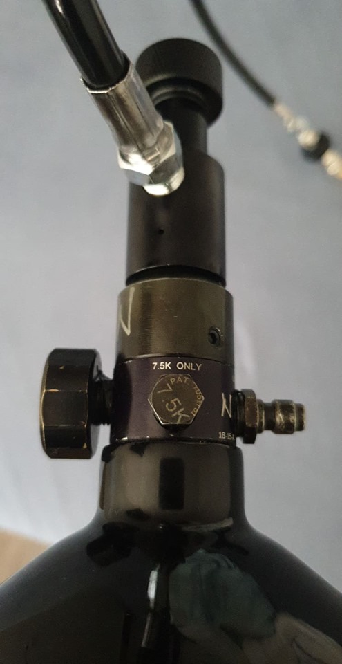

I did not shop for price and only shopped Ninja brand because it is USA made and I know I can trust these fill valves as I have both and have used them extensively with no problems. The valves on these regulator units differ from standard paintball tank valves so you will not be able to convert your reg to work like them. I expect others may make them but I am not familiar with them. This should get you in the ballpark for a fill station to fill guns and tanks.

Although I know you can get kits to up the pressure on the Ninja regs I am pretty sure they will not reach to the fill your PCP pressures you desire.

Those ninja bottle are for airsoft and paintball so they max output is like 800 to 1100 psi. That's way too low. It may hold 4500 psi but if its outputting only 1100 psi its useless for airgun. There are small tanks that will output up to 3000 and 4500 psi but those cost over $300. And only just like 2 to 3 refill. I'd rather spend a little more around $500 and get a 75cf tank that will refill many many times.

That tank is something I have laying around, so its free. But it has to have possibility of changing the output.
Can I put this on the bottle? Anybody knows?
