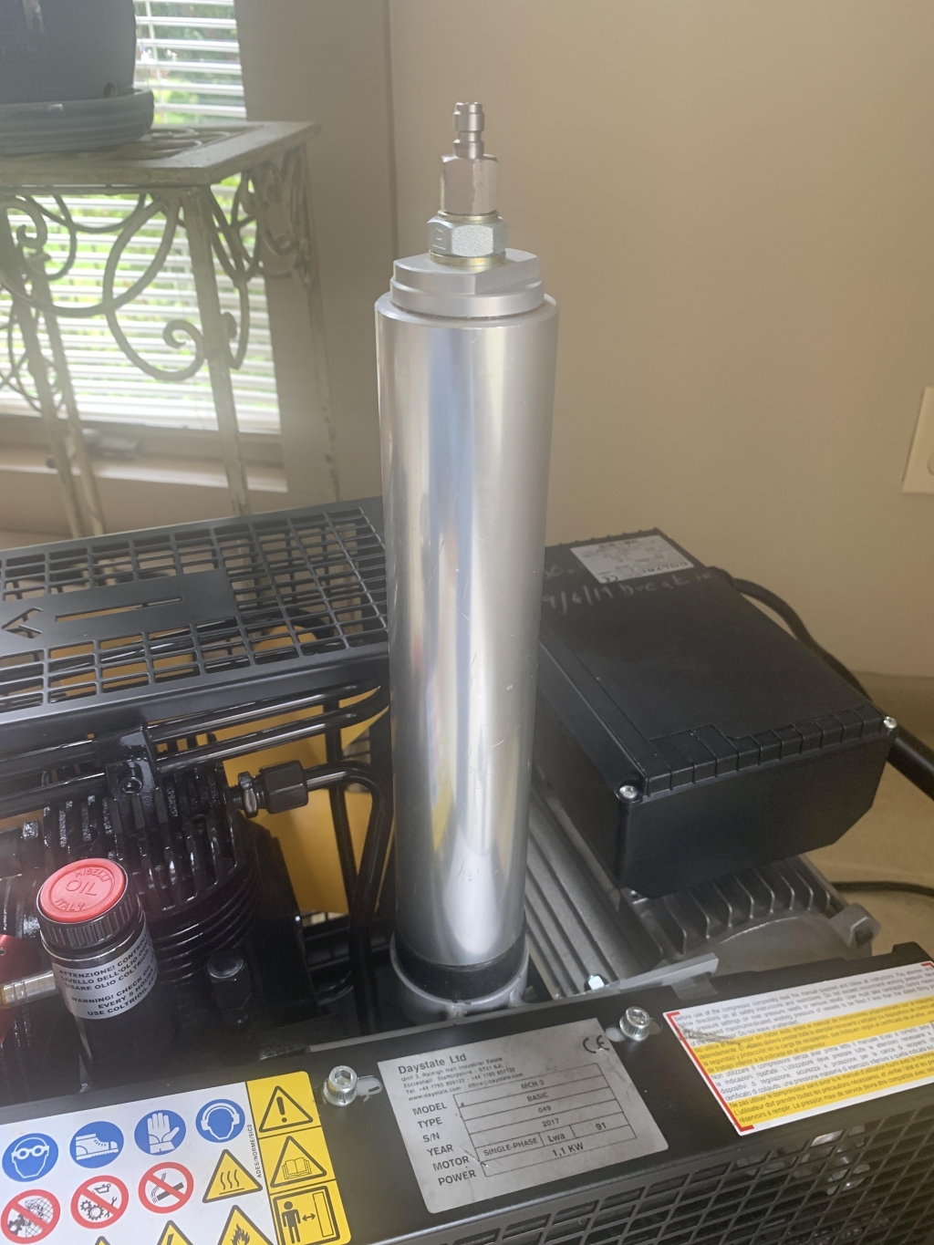

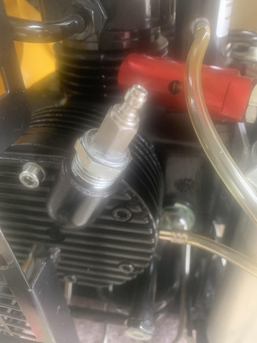

Here is what I have so far. The adaptor which I can thread into the compressor air intake and the external regulator.

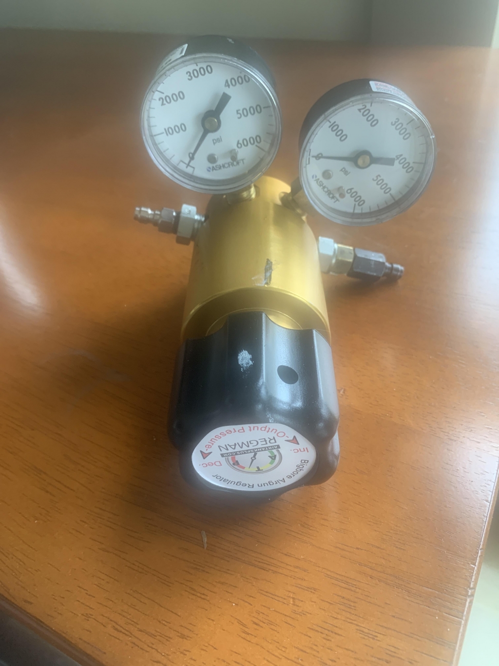

I understand that I have significantly reduced the air flow to the compressor and will need to compensate that by adjusting the out flow pressure from the big nitrogen tank using the regulator. I also think I want to careful not to over do that because logically already compressed gas is going to harder to compress then non compressed gas putting stress on the compressor . So I think I’m on the right path with the devil being in the details. How much is just right ?
The only measure is the air gauge on the daystate compressor. I’m thinking that I could measure the rate of clime on that gauge with the air intake open filling against a closed system and then match that clime with the nitrogen connected adjusting to regulator to match as closely as I can.
Some one might have a better more accurate solution . Maybe that regulator is not the best piece of equipment to use? It’s what I have available and it can be adjusted down very low.

The only thing I can come up with is that the stage-1 head is currently operating at local atmospheric pressure, something around 1atm. It's designed for that. I would be worried unless you can get the nitrogen pressure down to similar atmospheric pressure you could see increased stress on the compressor stages.
But... that's a guess, I don't know that for certain.

Your big reg will not work and moving the output up and down in pressure will shorten the time between rebuilds. I bought a Palmer Paintball stabilizer that will handle 4500psi inflow and bring it down to 0-200 psi outflow. The sweet spot should be around 32 psi with 1/8” fittings. Once the machine is running it is about airflow and as long as there is just a tad of back pressure the compressor is getting all the air it needs.
if your using 1/4” the psi needed is less to achieve 50lpm.
