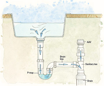

On your tee connector for air intake what if instead of using the non-hermetically sealed PVC end-cap you installed an AAV? You'd probably have to neck-up to 2" threaded PVC but if you hear the AAV flapping you'd know to increase tank pressure?

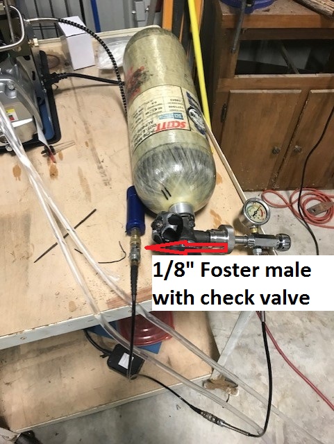

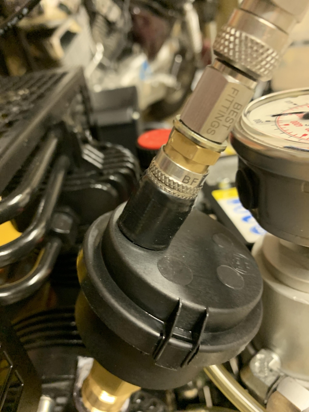

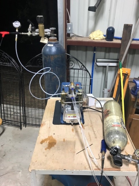

Ok. Updatin

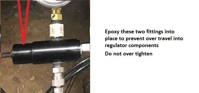

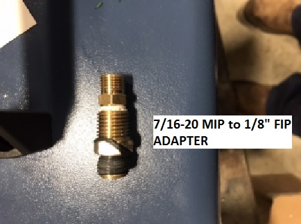

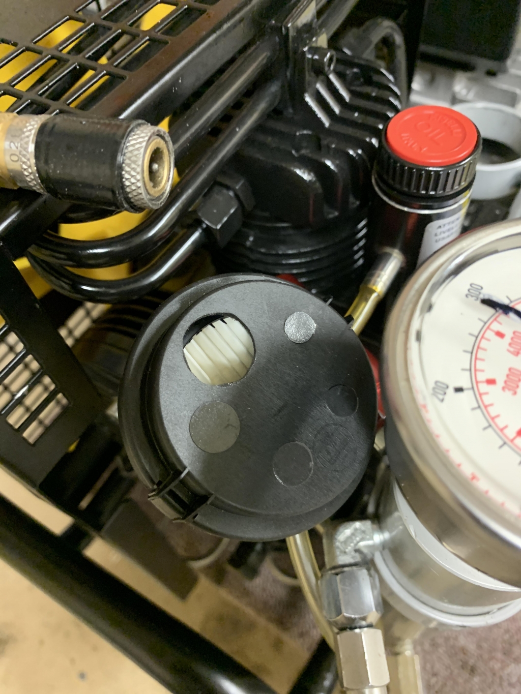

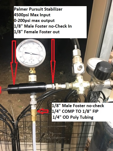

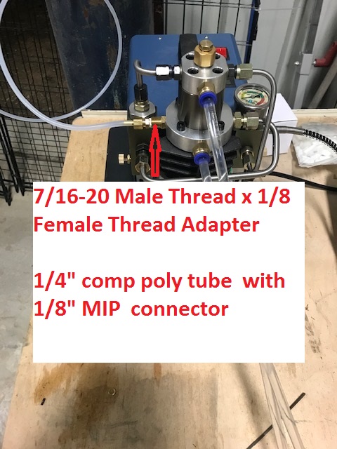

g this thread. The issue has been controlling the air flow out of the nitrogen tank and into the compressor . What I did was buy Joe Brancato’s dual purpose regulator. I know expensive but it can be used to tether SCBA tanks to the guns. I had some equipment to sell that nearly cover my expenses so I bought his regulator. THEN all I needed to do is get the gas into the daystate. I got a filter housing that I adapted and so what I can do is turn the compressor on and get it running in it’s intended manor. Then I turn on the nitrogen and just stick the extended fill connecter into the hole in the air filter housing. The electrical tape is just there to allow a seal. I adjust the regulator so it’s neutral not sucking or blowing and off we go. Worth it ? Probably not but I got it done

Yes, on the YH I leave the low pressure bleed slightly open. As long as air is escaping there I feel confident the compressor isn't starving. To begin filling I open both bleeds and start the n2. Then start the compressor, once running I close the High pressure side to begin filling. Once complete I open the High Pressure bleed then turn off machine.
Interesting project. I was going to use a haskel pump to boost N2 or even dive air to 4500psi using shop air. Economic when you can find surplus used haskel at proper ratio. As to the project at hand or any similar project I would use an ammeter on the compressor to determine if the load was increasing. If you feed the 1st stage under pressure you are asking the 1st stage to compress denser air thus more work/load. Starving the compressor would reduce load and probably would do no damage since the 1 atmosphere of suction is far less work than 100 atmospheres of compression (or whatever 1st stage pressure normally is). Possible problem would be if 1st stage is creating vacuum it might start consuming oil. A one way check valve could prevent vacuum or limit it to slight vacuum. Ammeter truly would tell you if you are laboring the compressor beyond normal operation. And yes, I believe clean, dry air is always desirable for protection of HPA equipment (tanks, guns). If it wasn't then no one would go to the trouble to create dry air for SCBA, SCUBA or any other HP air. It's not dry for sake of breathing (dries out your throat, moist air much more pleasant) but to protect pressure vessel. The effects of moisture are exaggerated as pressure increases, crudely expressed the moisture is squeezed out of air and condenses to liquid. Just a couple of percent of moisture at atmospheric pressure can puddle in the bottom of a tank at 3000psi. Moisture will damage your kit, but the question is how much? Those that call it a boogyman are simply accepting the damage as being within an acceptable risk range for their purposes and I have no problem with them doing so.
Sounds like good suggestions. Unfortunately a bit over my pay grade. But I understand the concept. I sit with the compressor and I monitor the compressor and listen to the compressor for changes in the sound and watch the flow of the nitrogen by lifting the extended disconnect in and out of the air cleaner as the compressor is running. I think I can “tell” if it’s right. Best I can do for myself right now. I’m not getting any moisture out of the drain. Seems to be working
