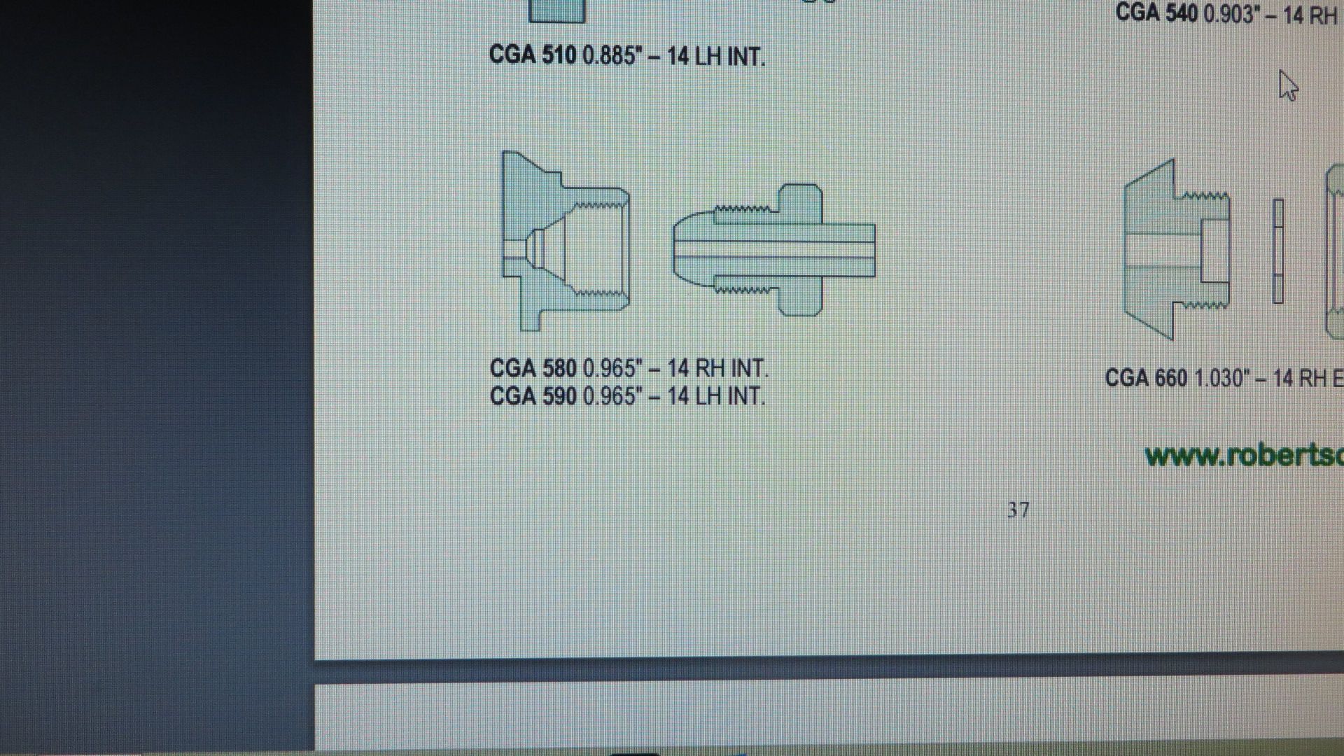

For the last five or six years I have been using nitrogen. I get a large bottle from our welding supply. It usually last a year, maybe even a little longer. Well all of the tanks I got so far have had a male fitting on the tank valve. Except today, it had a female fitting. I was not around when they left it off, so when I went to use it today my regulator would not fit. As my reg end is female. So I drove 20 miles to the supply house and they gave me a fitting I had to put on my reg. The welding supply said that is how theirs will be from now on. Just wondering how is everyone else's? Also I noticed the new tank was not as heavy, still heavier than a welding oxygen bottle, but not as heavy as the other nitrogen bottles I have wrestled with. Must be some kind of high strength steel.

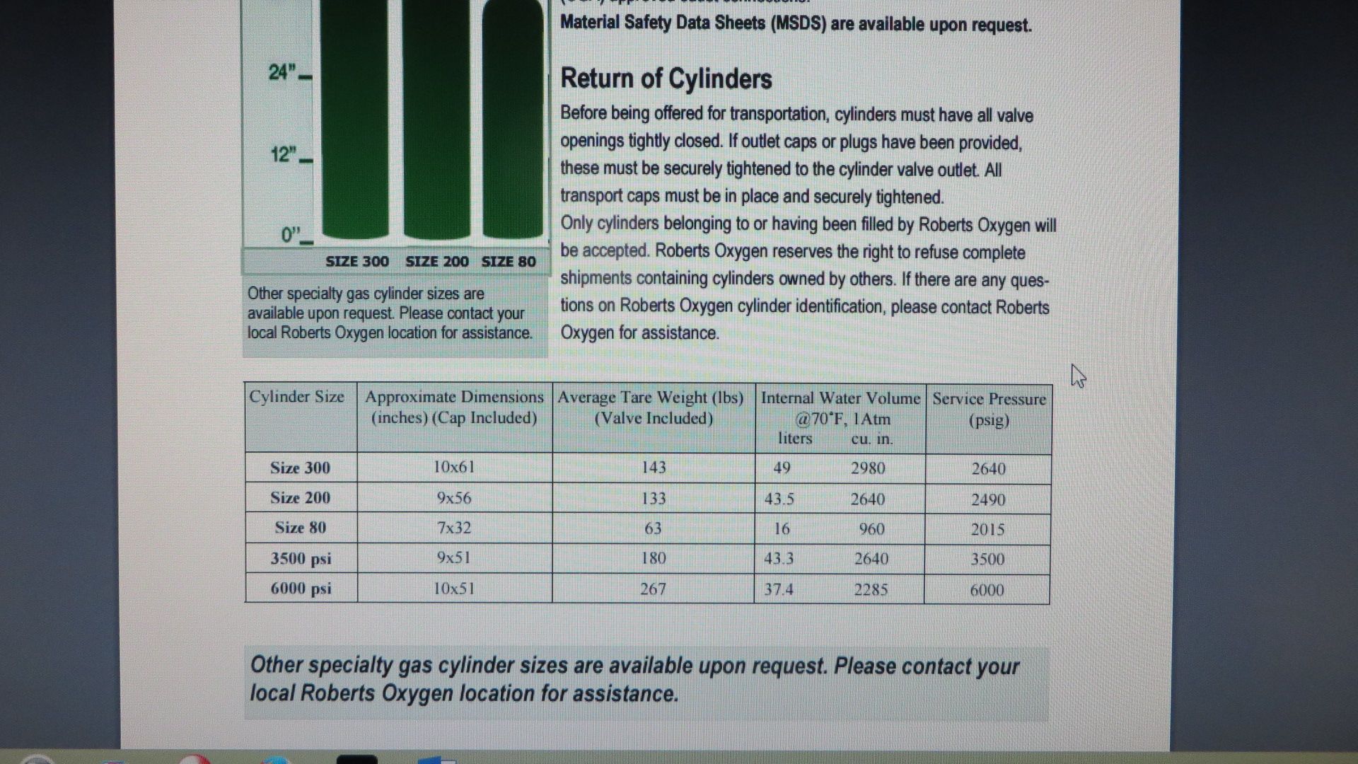

Here is the weight and size of a 6000 psi bottle

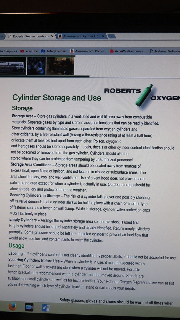

General Storage. Main thing to keep the bottle secure from tipping over.

I wonder if you could give me more info on your tank How tall and how big around is it? I went to the local welding supply and they thought I was crazy. Told me the only tanks that go 6 K are so huge only a business would have one installed at quite a cost? ????? I thought it looked about the size of an oxygen tank. Can you give me more info? Thanks Much. Brian Smith [email protected]
"briansmith"I wonder if you could give me more info on your tank How tall and how big around is it? I went to the local welding supply and they thought I was crazy. Told me the only tanks that go 6 K are so huge only a business would have one installed at quite a cost? ????? I thought it looked about the size of an oxygen tank. Can you give me more info? Thanks Much. Brian Smith [email protected]
6k cylinders are quite common. They are usually about 10" in diameter and 51" tall. They are very heavy, just under 300 lbs. because the wall thickness is about 1" steel. I would look for another welding supplier, or gas distributor. Try a search for Praxair, Air Products, or Matheson, they are some of the major gas suppliers.
The big 494 CF one like I have is about 9" in diameter and 56" tall. About the same size as a big oxygen tank for a torch outfit, but a lot heavier. You should tell them of course you are crazy, you belong to a hobby that people pay a couple grand for a rifle & then months tweaking it to their perfection. Not counting all the other stuff that go along with it. Have you checked out
