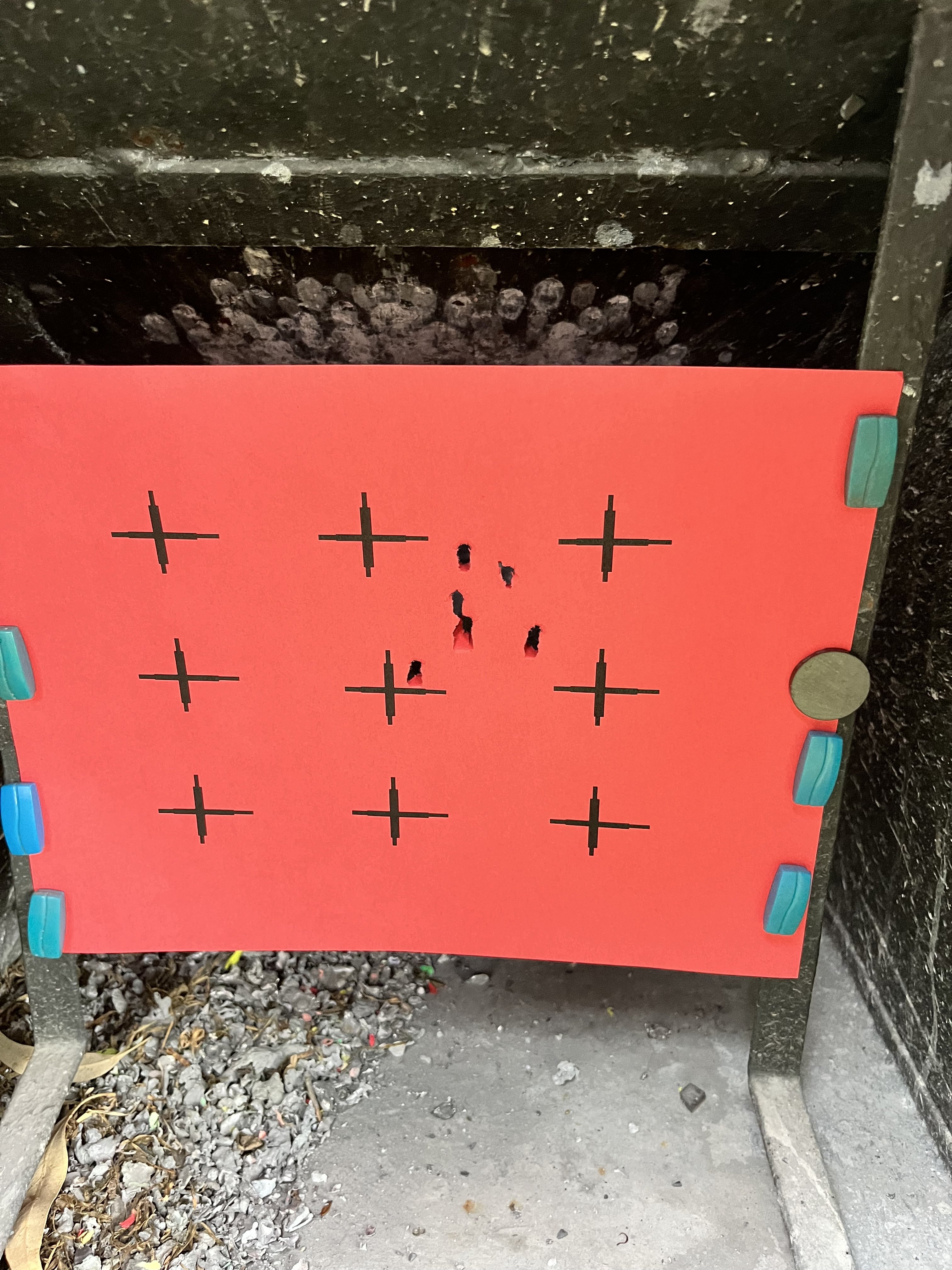

The scope on my AR6 is VERY bad and with only 6X, so this bad group is not entirely fault of the rifle. 50 Yards, 6 shots JSB 25 grain:
