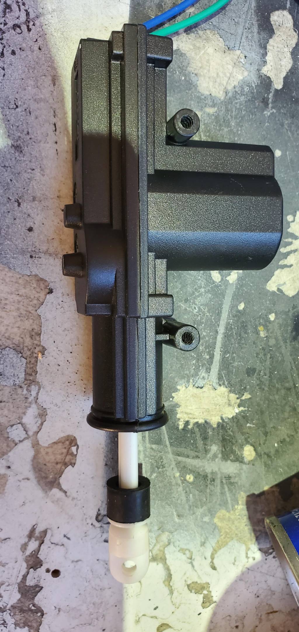

Issue one finding a actuator that was strong enough to move the plate. There are a lot that can do it but none as cheaply as I wanted to spend at least not that I could find.
2. Finding a actuator that has enough stroke and still cheap.
3. Finding a way to have the actuator move the plate up and get out of the way so it would not hinder the plate coming down when the plate is ready to come down. Many actuators are geared such that the arm stays where it is after it is put in a certain position.
Well I found a very simple actuator that was fairly strong and cheap. It also happens to have gearing that was not high and easy to overcome when no power was applied.
This was a aftermarket generic door lock actuator! You can get these for as little as $4 each! You do have to buy more than one but 4 for $16 is cheap and easy to replace if you break it!
The problem is stroke. There is not a lot of stroke so you have to put the pivot point very close to the hinge or attach to a bell crank with enough amount of movement but still be strong enough to lift the plate up. You could also make and 3d print a new housing for the actuator so it has the amount of travel required.
The other thing is finding a 12 volt remote control switch. That part was easy. The only thing is finding one you can program to be momentary switch. Meaning it only pushes when you have the button down as you don't want power on the actuator once the plate is up because if someone shoots it while the actuator is powered something would probably break. I found these as cheap as $8 ($5 if you have your own remote) but it's on the slow boat from China. You can find 🇺🇸 suppliers for like $10 to $12. You just have to change the setting to momentary switch.

Oh these sure loosen up quickly. They do need some type of locktite. I fired about 12 times before the linkage on the target fell apart enough to prevent the mechanism from lifting the plate up correctly. The other extreme is not to tighten the nuts and bolts too tight otherwise it will be too hard for the motor to lift the face place and mechanism together.
As for how much force is required to push up the plate. It depends on where you are pushing on the plate. With the actuator I am using it has a short stroke so it must be used closer to the hinge. Which requires it to have a fair amount of force.
