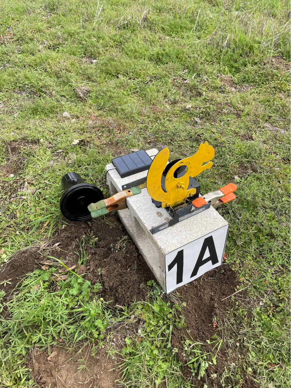

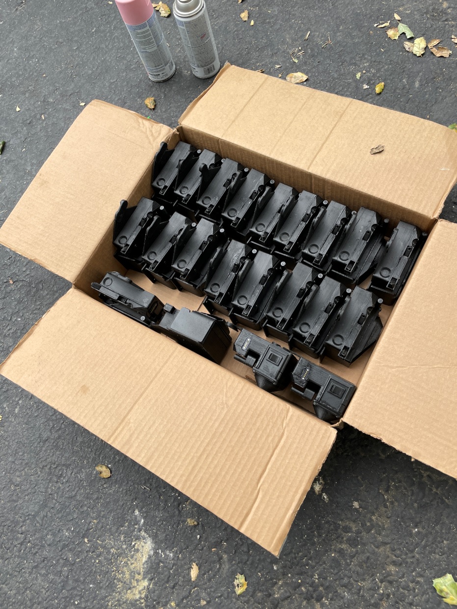

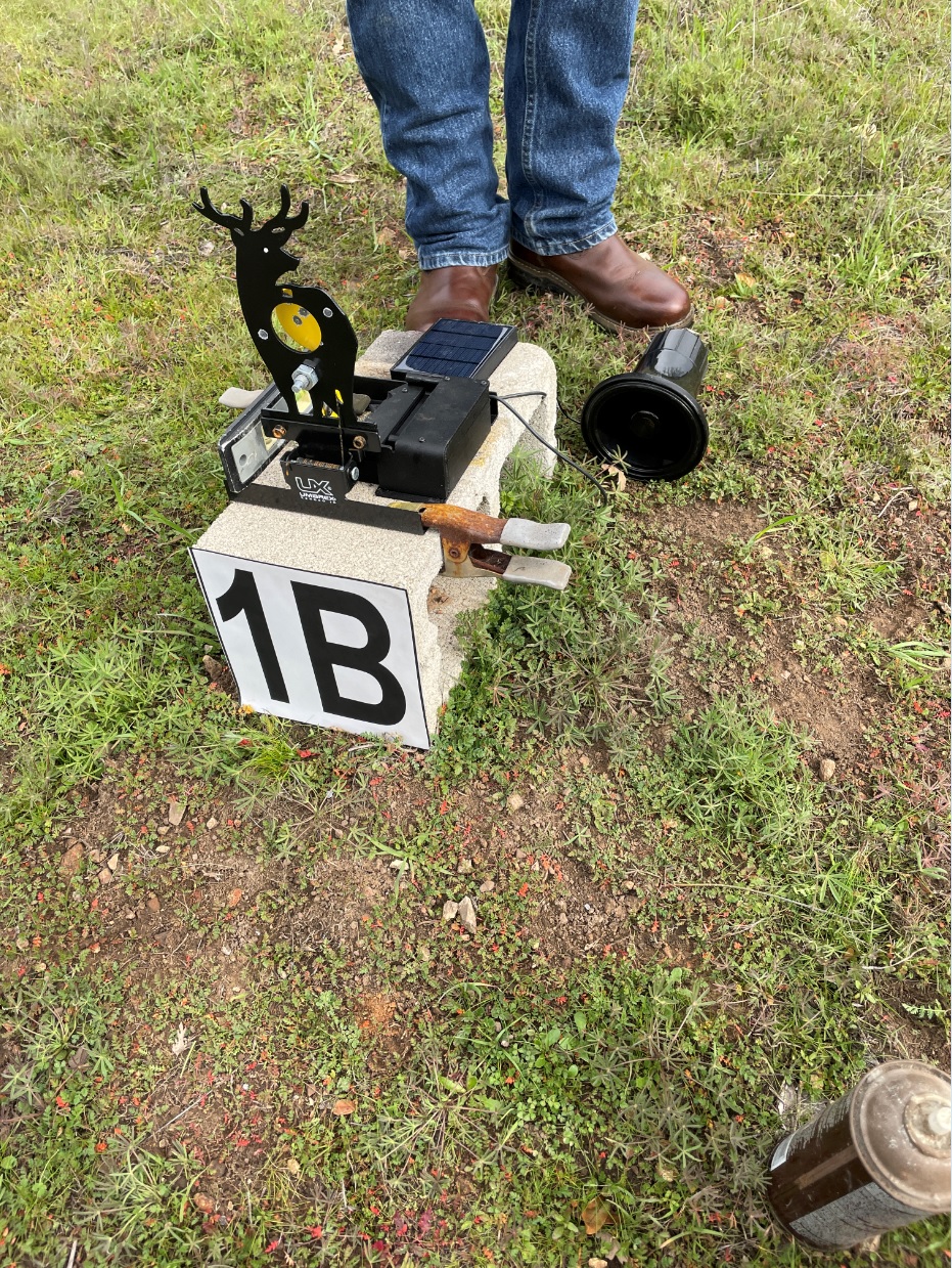

We tested on heavier face plates. Even the existing servo could lift some of the small/medium Steel Plinkers 100fpe targets. A bigger servo and arm would be needed for very heavy targets. The existing electronics can drive the bigger servo. But in either instance, a new housing design for the unit would be needed since those targets have significant dimensional differences.
The latest version mounts securely to, and works with Gamo, Umarex, and now Crosman Field Targets. We could do a slightly different housing design that mounts securely to Air Venturi Field Targets - easy enough.
The CASA match this Sunday will use all auto-reset targets. If anybody wants to try a FT match with "no strings attached", come on out.
