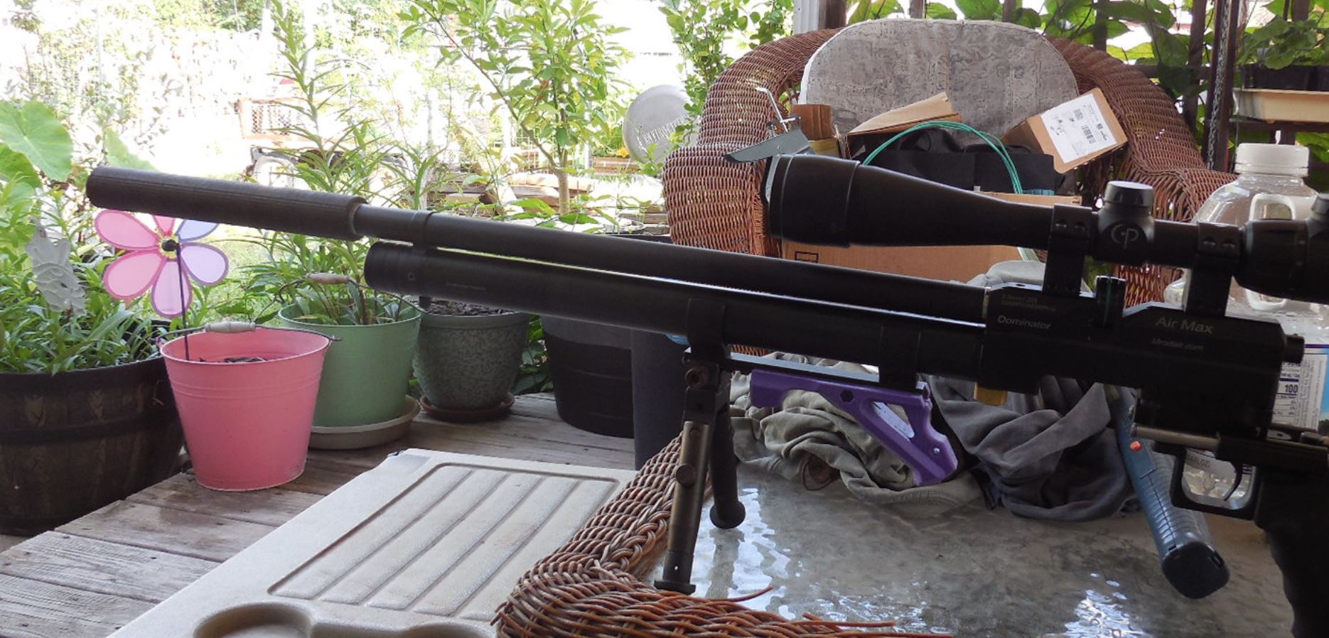

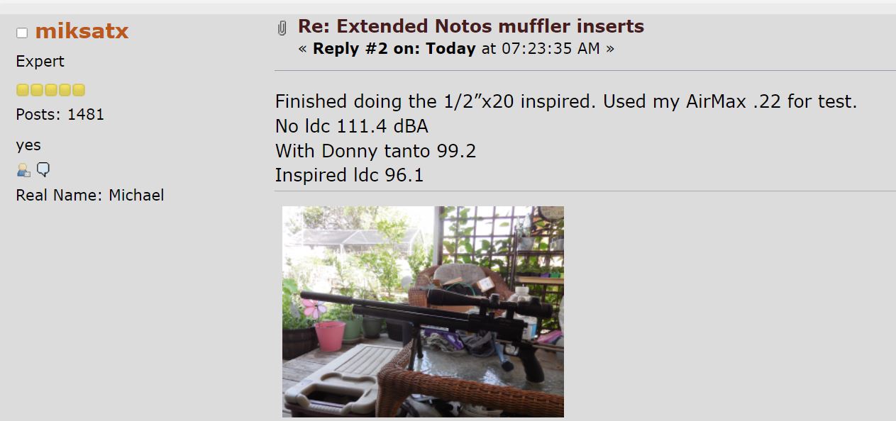

So, we have a test result for the Notos inspired LDC that was printed overnight - see screen captures below.
This was on a .22 Air Max Dominator - I have asked Mike what his pellet weight and velocity were. EDIT: Mike provided the info: "Crosman hp 14.3 825fps" That is 21.6 FPE.
Mike's test results: https://www.gatewaytoairguns.org/GTA/index.php?topic=208202.msg156450525#msg156450525
