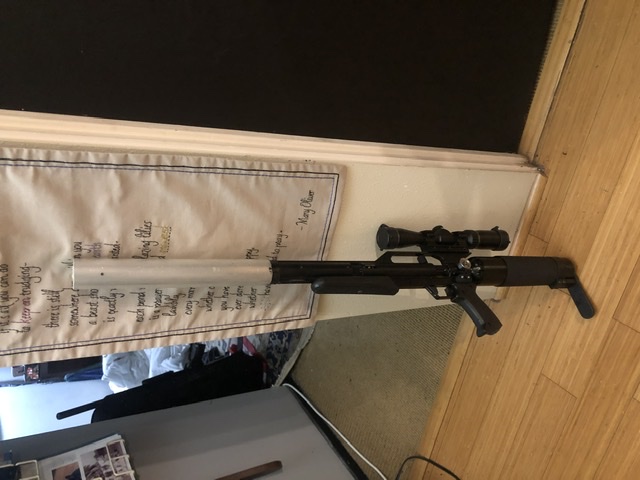

I built my own airforce gun in a TalonP "chassis" hpa man.
Aluminum breech and heavy hammer from talontunes, Noble valve and spring, 18" Airforce heavy barrel, an aluminum thick-walled actually 4500 psi tank stamped as tested at higher pressure, that I have never fillEd past 4000. Thick walls decrease the volume a bit so it's not a full 0.5 L more 0.45 I think.
Aluminum tube is a reflex ldc I made - slides back over the barrel (which sticks 5" Out of the end of the shroud) and has 3d printed baffles and some other stuff inside
So, this sound ok or risky?
