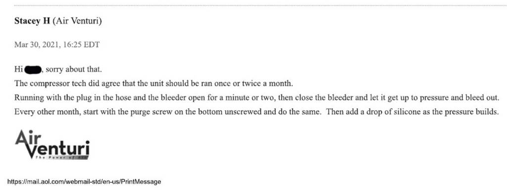

stoutblock - Crosman silicone chamber oil works fine and is fairly easy to get. Good news (or perhaps bad news) is 3-4 of the 1/4 oz tubes will probably outlast the compressor. A tube goes a long way using only 2-3 drops at a time.
