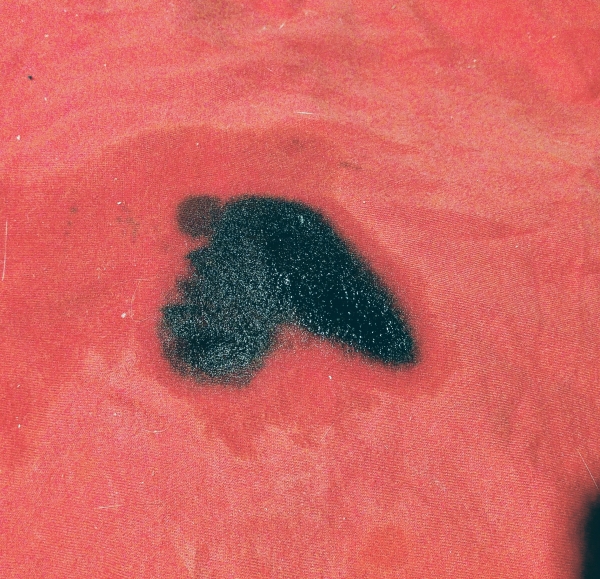

Just did the basic maintenance per the manual. She was purring like a kitten before I did it, but still got this amount of junk out of it.
Did my first one Saturday and it did not look like that at all, it was just wet. I am pretty sure you have more time on yours as I just hit the 20 fill mark but I cannot think of any mechanical device that would be happy with that floating around in it!

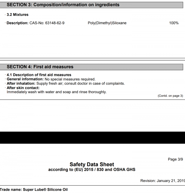

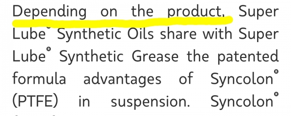

I saw from your earlier post you are using Superlube in your compressor. I did a little poking around on thier the website and found this:
What is Super Lube®?
Super Lube® is a patented, multi-purpose synthetic lubricant, containing Syncolon® (PTFE) particles held in suspension. Super Lube® lasts longer and outperforms conventional petroleum-based greases and oils.
So this is not pure silicone oil as it has teflon in it. I wonder if that is what is making it black, burnt teflon.
