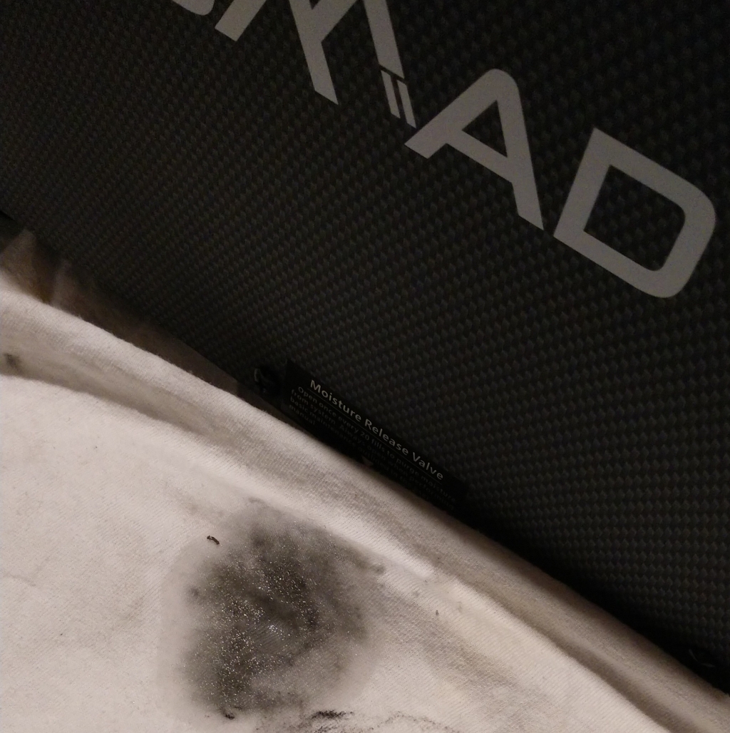

Started my ninth fill with the Nomad 2 of an Ataman MR from 100 bar to 280 bar the compressor stopped at 230 bar and gave a code on the Load gauge of H2. I have followed the silicone oil protocol at the 5 fill mark. I checked the burst disc, it was bulged but did not have a hole in it. I changed the burst disc anyway and did the 20 fill maintenance got the black oil water mix. Now compressor only runs for a couple of seconds getting a load of 18 to 20 and shuts off. I am still within my 30 days so I will be calling AV tomorrow and see what they say.

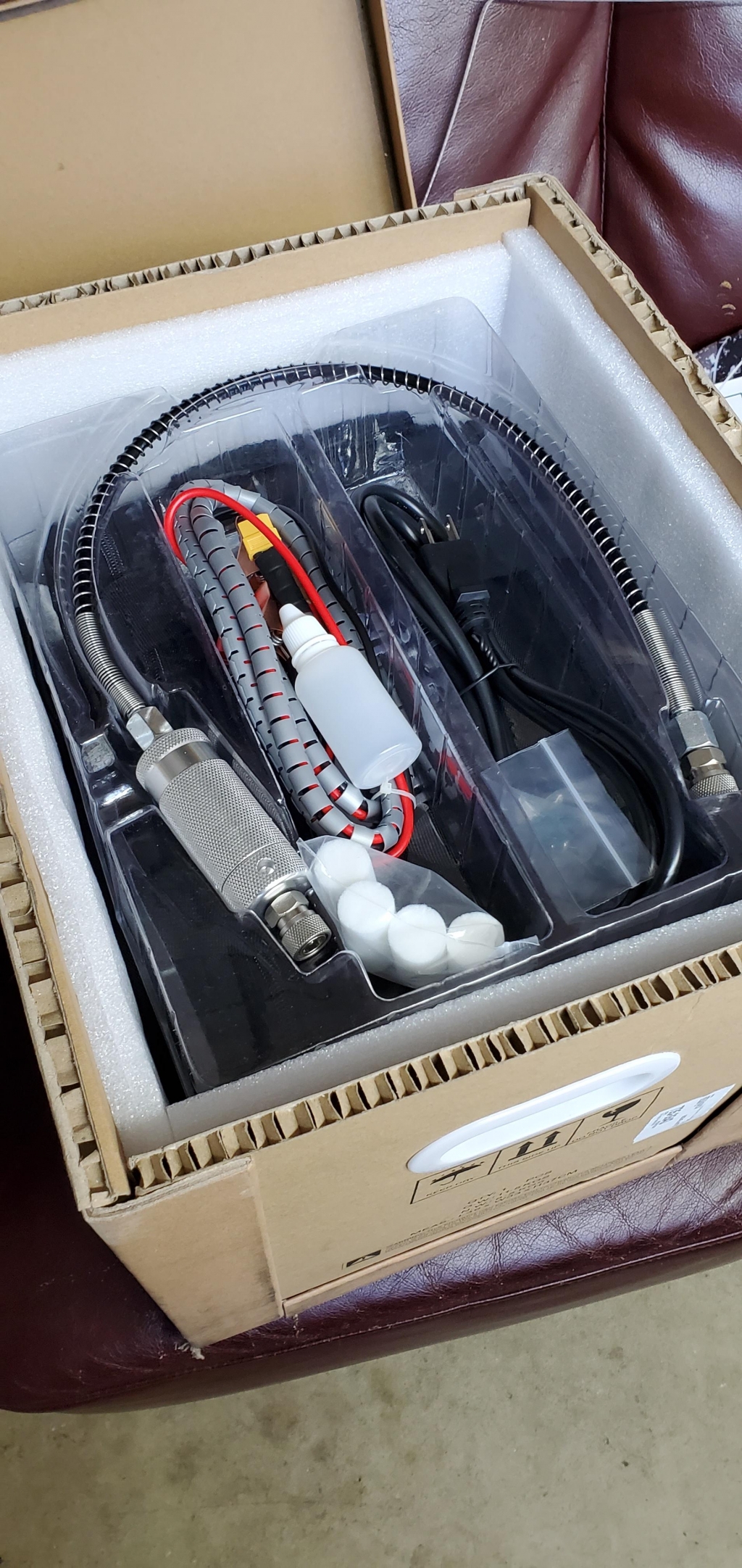

Update: Took a month to receive my compressor back from AV. On a good note, they sent me a Brand New Unit as replacement! I originally sent them only the compressor and hose as that is what they asked me to do. To my surprise, when I opened up the box yesterday was a brand spanking new compressor with Everything! Hopefully this unit lasts longer than the last one.
