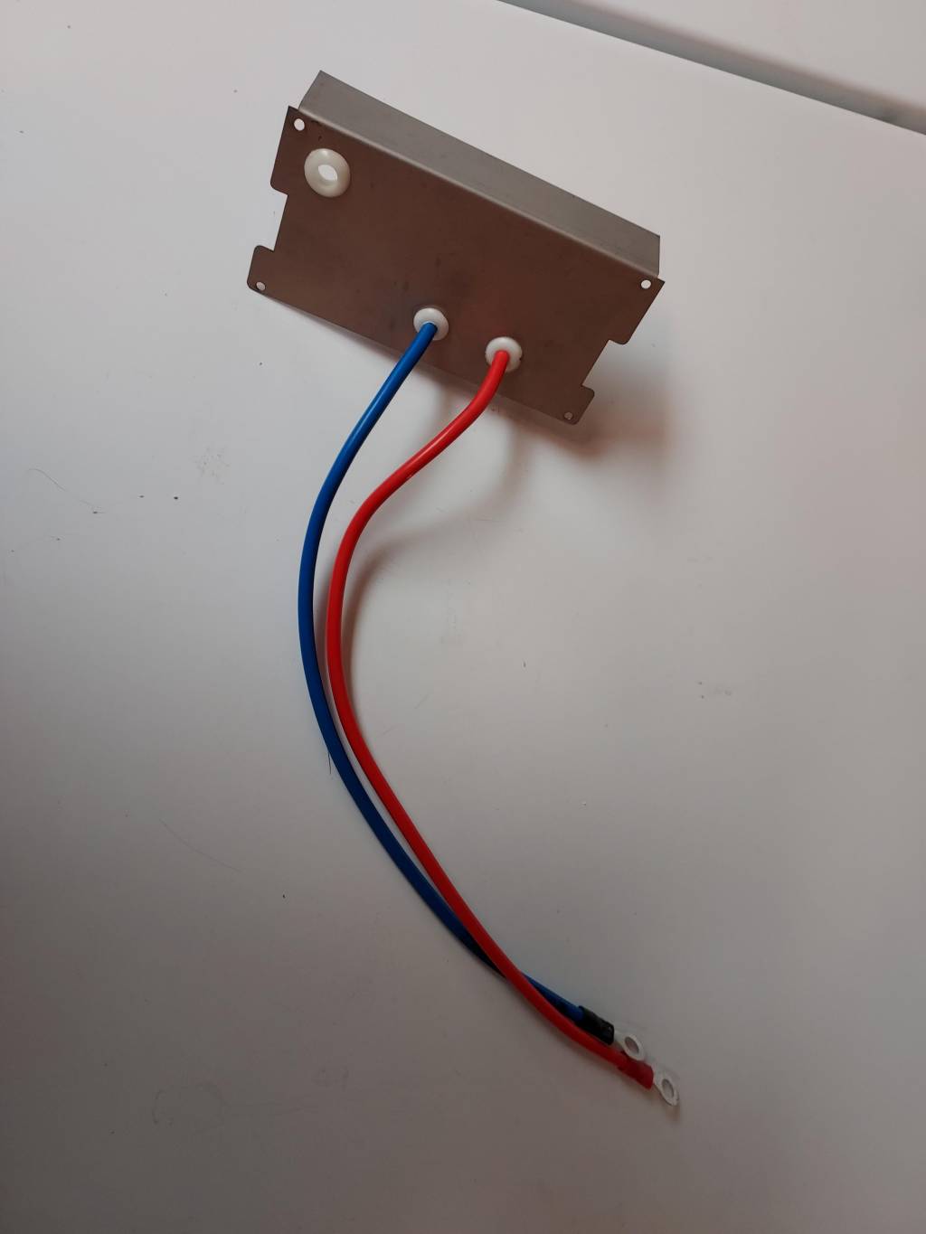

Hi. Digging through my old parts for length of wire and found this.
The rear panel from the spark external power supply. Just remove it and the install the new power supply into your Nomad II. I apologize for not having the correct installation information.
