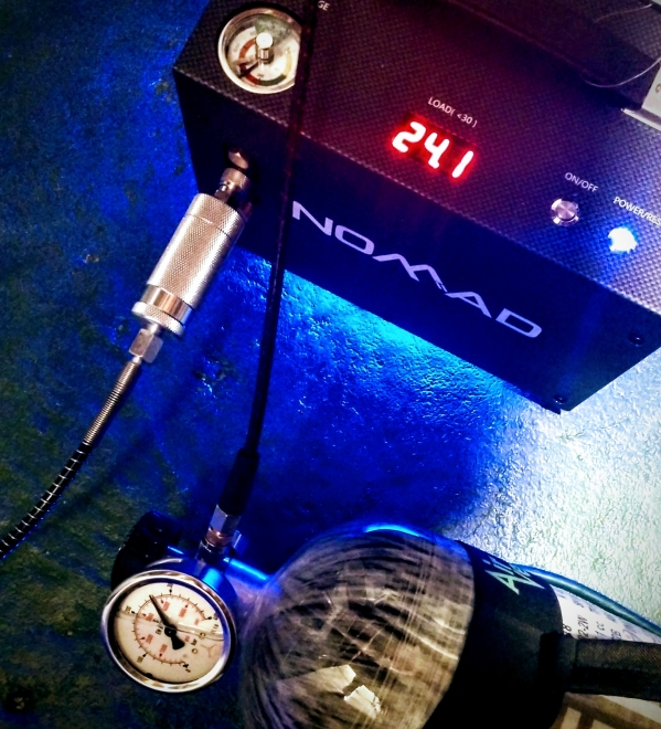

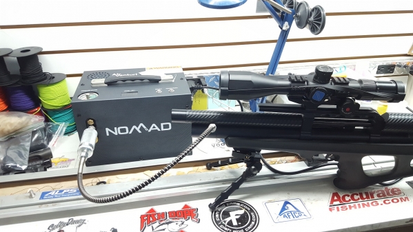

Did a full top off of the Crown yesterday, from 140 to 240.....took 7min 20sec.....I think that's pretty close to advertised.
Also got the male-to-male adapter so I could use the hose from my tank with the hose from the compressor.....way more convenient this way. Now I can flip the gun over to look at the pressure gauge while it's filling if I want to.
Also makes it easier to hook up and the gun doesnt have to be right next to the compressor. This will make it way easier when charging from the car once I get around to doing that.

Did my first fill from under the hood today. It was -5*F outside and it worked just fine. Though I didn't time it, it sounded like it was running a bit slower compared to when plugged into a wall outlet.
I left the car running during the charge because I was at a remote farm and I didn't want to chance a dead battery and get stranded in the cold.
