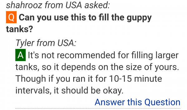

It "can", it's just not recommended. I wanted to get some time on mine in the first 30 days so I hooked it to my 74 cu.ft. tank and did two 12-minute fills with a 5 minute rest in between. Took the tank from 3,600 to 3,900psi no problem and the load meter never went above 24.
If I had one of those small tanks I'd probably use it to fill based upon this question and answer:
It is a good chunk of change for something that can't even fill a 90ci bottle.
