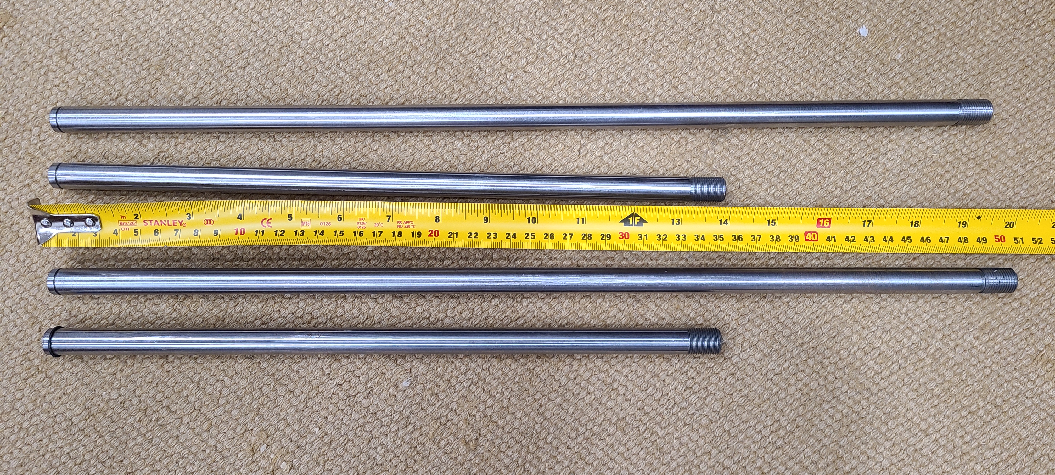

I have these Russian/ebay made .22 and .25 polygonal barrels (AP 1:17.7) for my Leshiy2 for some time, I did tried the .22 and performs pretty well....never got to .25 yet.
But last year I replace it with FX .22x600 liner and shoot with that instead for almost a year.
Tinkering now again to employ these barrels again, but in order to benefit from a FX shroud internal air stripper, speculating to remove the M14 and rework the thread to 1/2-20. This seem to me less work instead of making a new shroud plug with M14. I think to standardize the threads to a single size I can minimize the parts laying around.
What can go wrong shooting pellets from an unchoked barrel? ......... In worst case scenario I can still shoot slugs but that is not my primary focus... I wanna shoot pellets from L2.

I am developing my own process, my goal is to have a FX shroud over these barrels working well.
But I need to DELETE the M14 thread and make a new 1/2-20 in order to use the shroud.
What is the issue?
The Leshiy2 Dwell timing is tricky and not so simple to get it right.
With the FX .22x600 liner the L2 was a MOA @ 50 meters, I want to make it MOA @ 100 with these x500 barrels. And that is possible if I shave off the air blast leading in front of the projectile.
What is the issue?
