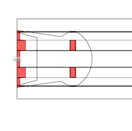

A JSB pellet boasts a head diameter of 5.52 +- 0.01 mm and a skirt diameter of 5.71 +- 0.01 mm. The head fits snugly between the bore and groove, encompassing around 45% of the depth, ensuring an optimal engagement. Moreover, the skirt covers approximately 101.017% of the total barrel diameter, fully enveloping the barrel profile's extremities, creating a perfect seal and ideal head engagement. ( That’s why pellet sizers do not work if you pass the entire pellet through it)
As you fire the shot, the skirt no longer needs to expand; instead, it bulges and harnesses the charge, accelerating towards the Choke. (You can find numerous images of fired and recovered pellets online illustrating this process.) The choke measures approximately 0.012 mm less than the bore diameter or 0.0005 inches. It serves as a constant tapering section, molding the slug by pressing against the grooved contact surface and effectively swaging it into a uniform diameter.
The skirt features a meticulously engineered conical section that readily collapses and deforms with minimal effort, contributing to a highly efficient discharge. As seen in the image below.

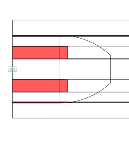

On the other hand, the 0.216 slug is relatively loose-fitting, akin to riding the bore, resulting in numerous air passageways.
Consequently, this creates the following scenario:
I would like you to imagine how Jason Statham would say these lines.
- So, you've got quite a bit of space between the groove and slug diameter, allowing the City of London to run a tube service right through it! Your air charge exceeds and exits faster than the preceding slug. What you don't realize is the amount of energy you're losing.
- Now, as you approach the choke, guess what? You've got a solid chunk that's fatter than an éclair (for the choke, at least!). There's no tail section to deform. The result is that you end up losing velocity and a fair bit of the slug to the choke.
- And finally, the grooves cut into the slug, causing you to choke your barrel with lead deposition, making it a smoothbore much sooner. Wonder why you need regular bore cleaning?
