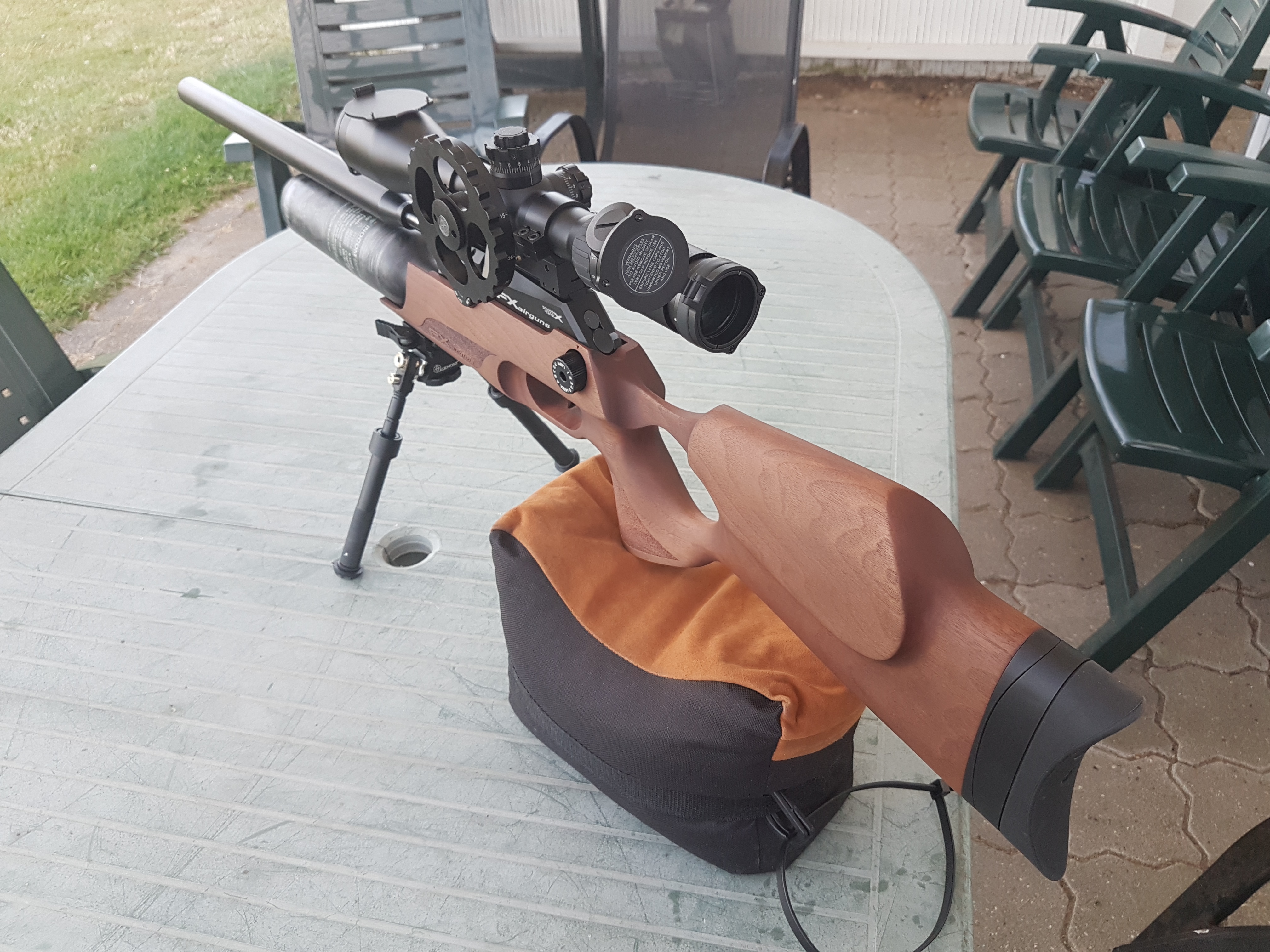

Hi Edward,
My experience is that a Bipod on the bottle causes a lot of Poi shifts if you like shoot a benchrest target. The POI becomes unpredictable unless you carefully lifts the legs on the bipod and put them down again. If you shoot a mag, on the same target without moving the rifle and the eye, I can shoot a magazine down the same hole.
I successfully use bottle clamp placed on the middle of the bottle, for attaching the bipod on my Redwolf - this is no problem the Redwolf is sturdy like a tank.
My Crown is very lightweight compared and will be much more sensible to shoot.
I find it better when I shoot with the bipod mounted on a picatinny rail fixed to the end of the Crowns wood stock.
But also remember to tighten the two screws holding the stock semi tight.
It is totally unpredictable if the screws are not properly tightened.
With that said I have really been fighting the POI shift on my Crown.
I have tried many different ways to avoid not only sideways, but also up and down depending on the load distribution on the bipod vs. hold vs. reas support.
Best is to have a bipod that can rotate when you rotate sideways. And secure to hold the same way every time so you get the same weight on the bipod every time you press the trigger.
If the bipod legs is 45° degrees forward - be sure to have feets with very little friction from bipod feets to the table.
This should allow the bipod to easily slide into the same position between every shot.
I know this is probably basic information for most shooters - but I just learned by comparing different ways.
But one thing is for sure Bipod holder on the bottle did not work for me at all with my FX Crown.
The Crown will never be like my Redwolf. I can take the redwolf out of box and shoot at a target from 50 m and it will hit the same spot as last time - from the first shot.
Lets just say it as it is - They Crown needs some massage to wake up and perform - just like men in my age ;-)
Best regards Claus from Denmark
Old photo from when I just received my Crown Today I use mainly 700 mm barrels - It is so long.
