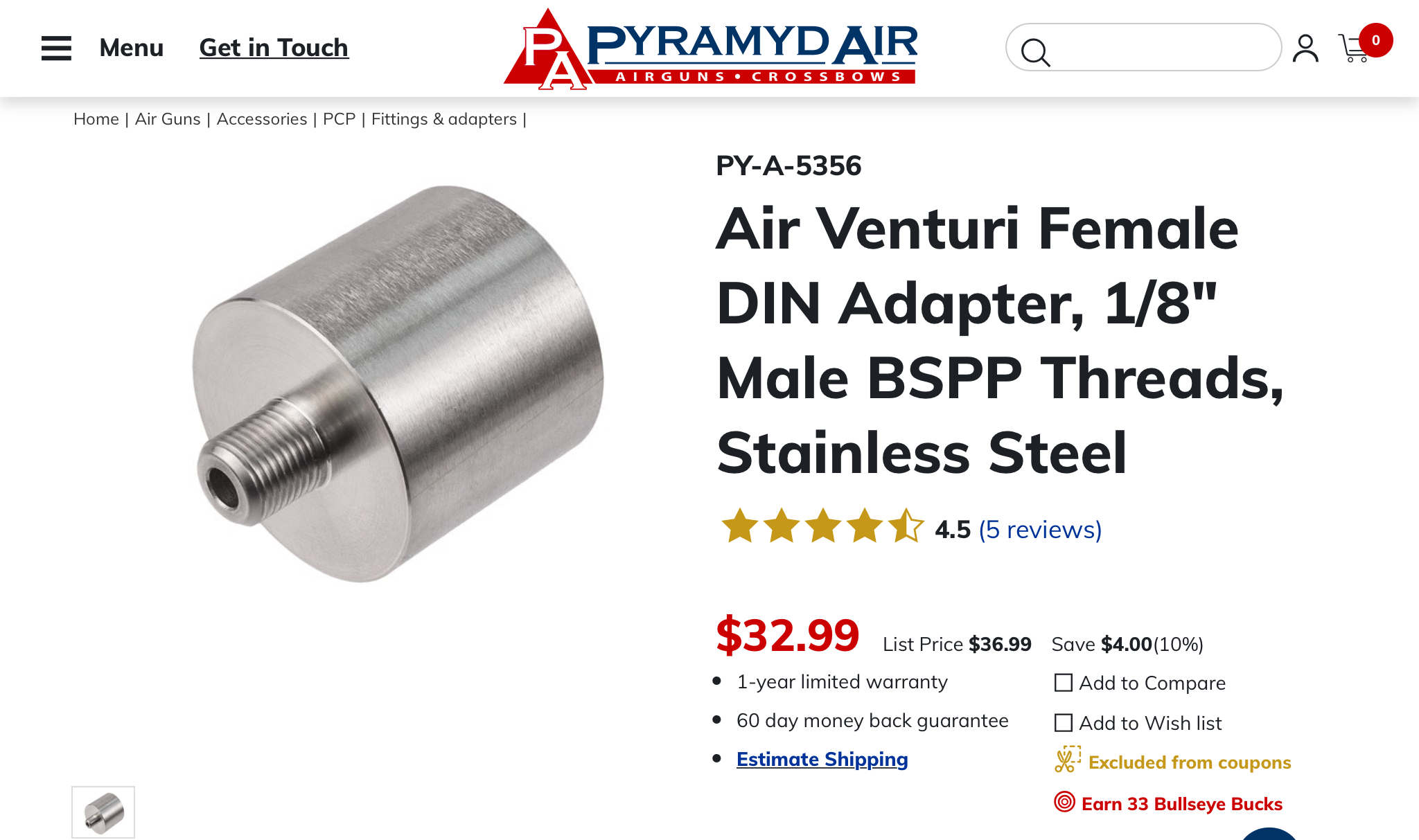

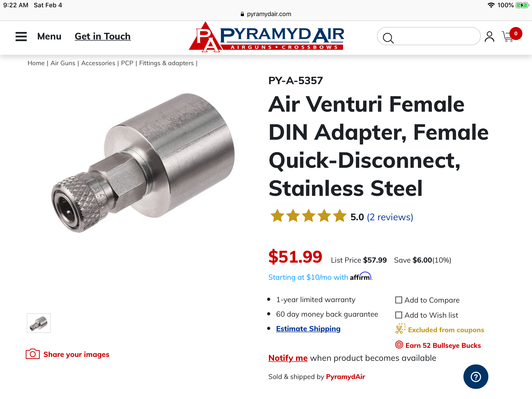

If you unscrew the foster connection, isn't it a 300 DIN fitting? Dive shops should be able to fill it.
I just went to the AoA site and looked at the Omega 75cf tank. According to the specs it comes with their HP3 valve which only has a male foster fitting. But if you watch the video for that tank they show a different valve that has a DIN 300 outlet that you screw your necessary fitting into for your gun filling needs.
I’m guessing that (maybe) the dive shop guy was able to see that your valve isn’t the DIN 300 variety and he had no way to attach his fill whip to it.

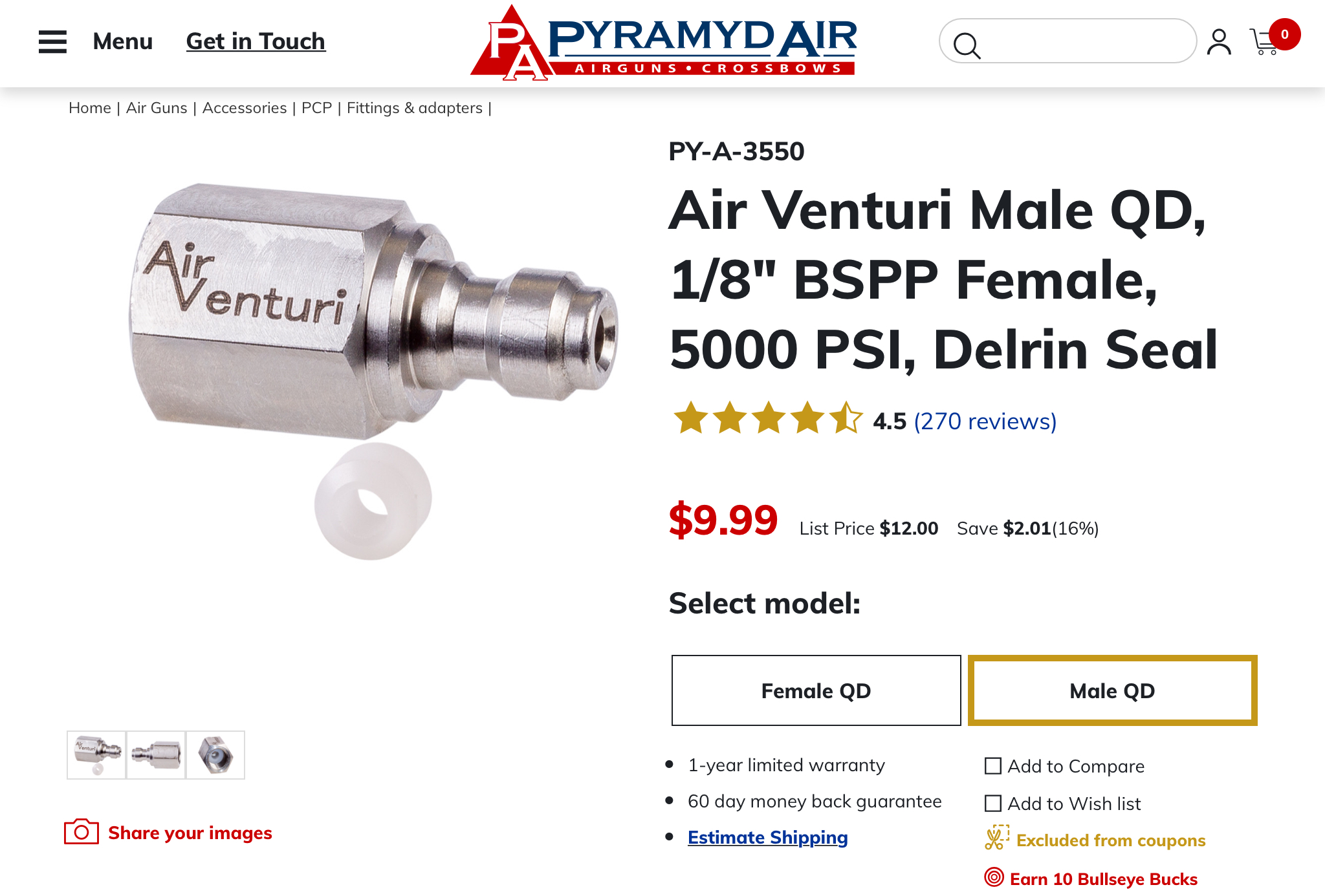

Being you bought a compressor any continuing conversations are moot. But, if anyone else has an HP3 valve all you need for a dive shop to be able to fill a tank with HP3 valve is: Pyramyd Air PY-A-5357 DIN 300 female x female quick connect foster, shown below. The downside of that adapter is if the dive shop guy is careless with his much heavier fill whip line, he can bend or break off the small male foster on your HP3 valve. That would be exciting if the tank valve is open. So a better option would be to leave your micro bore line connected to your HP3 valve and use the Pyramyd Air PY-A-5357 and a PY-A-3550 and screw them together, photos 2 and 3. That way your microbore will tolerate any fill whip mishandling.
