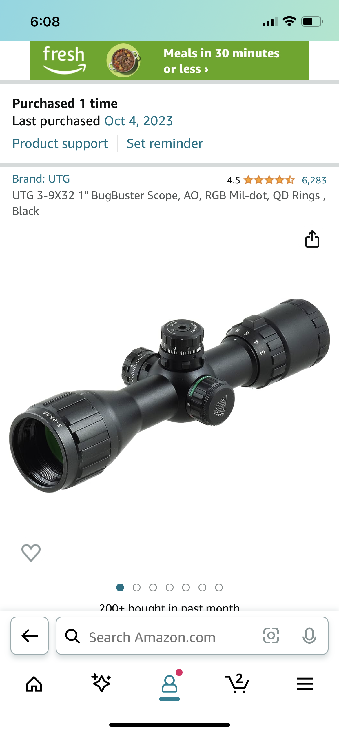

its a bug buster?
my bug buster has the side parallax.
post a pick:)
Reactions: mjb206
its a bug buster?
post a pick:)
This is mine. The side dial turns the red/green reticle on and off. Parallax adjustment is at the front.
