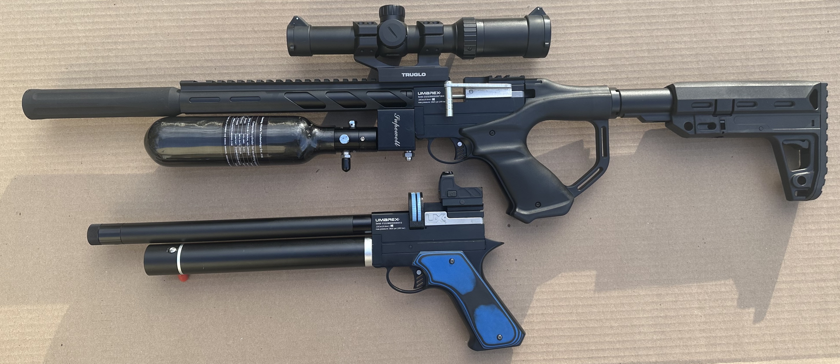

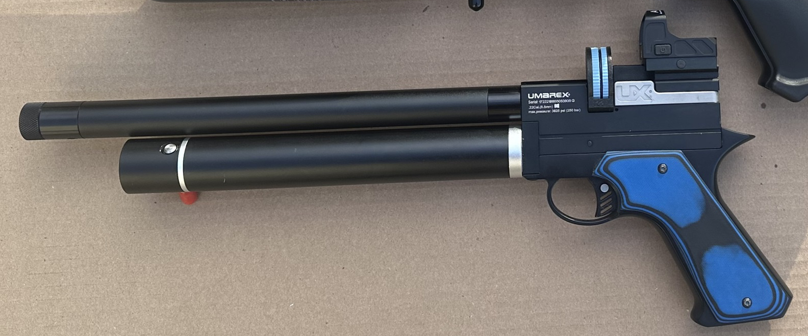

I've been singing the praises of the Notos for a little while. I had one converted by Firewalker and I have to say I really like this little gun.
So when I saw another one hit the Classifieds, I figured I'd make a pistol out of it.
Hardest part was removing the factory mod. I chucked the barrel up in the lathe and started turning it down until I got the clips out and then broke away the rest of the molded plastic. After that, it was easy. Got the endcap off Ebay and cobbled together some G10 grips for it.
I'd love to shorten the whole thing up a little bit, but that's well beyond my skill level so I'll have to settle for it being a 'longish' pistol. Still not unweildy, I dont think.
Pictured here along side of my other Notos.
I just got in the endcap today so havent done any tuning on it. Current plan is to try to tune it down to around 650fps for more shots on a fill. Plenty enough for my intended purposes of this gun.

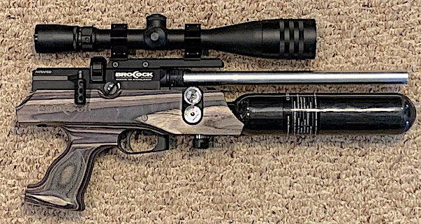

they make grips for it and even sights but the sights look cheap
but the blue laminate looks fine
you could cut the barrel back to the cylinder
if i owned PCP's i would have one in a heart beat
https://www.pyramydair.com/search-results-ext?keyword=umarex+notos
show the shroud area when you get it done i have some interest in still buying one to play with

Rob they look sharp. Was you able to save the original mod & thread it back to fit?

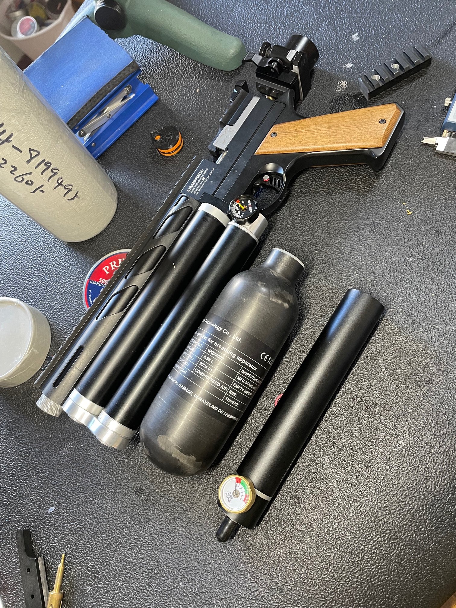

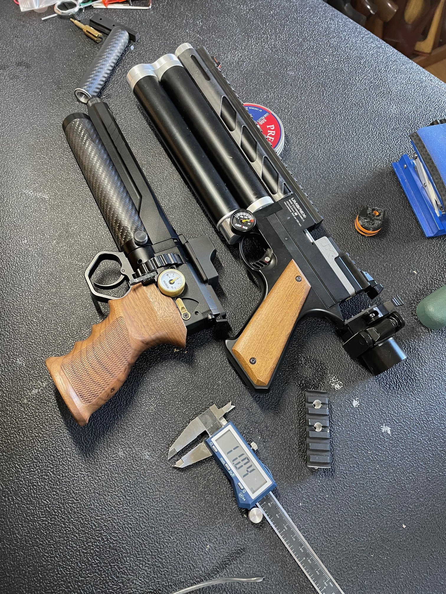

So now that I finished the Notos Rocket 2, I decided to make it convertible to micro carbine. Working on the quick release detachable folding adapter for it. Next up is a shorty .25 cal pistol. I'm waiting on material to make a regulator that will be inside the bottle to keep length to a minimum. An external companion plenum will be utilized on both sides connecting it to the drop adapter.

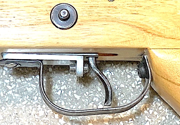

I came close to buying one of those Keystone laminate pistols. Figured it would have a rudimentary trigger, but I've smithed the world's simplest triggers to silhouette State Champion and National Record winning let-offs. Couldn't be simpler than a 50's vintage Crosman 160 and 180; those triggers and sears being a one-piece, L-shaped steel stamping.
Home-made sear-engagement adjuster on the world's simplest trigger/sear on a 1950's vintage Crosman 180 (converted to pistol), breaks like glass at 10 ounces.
I like that. Simple and effective.
