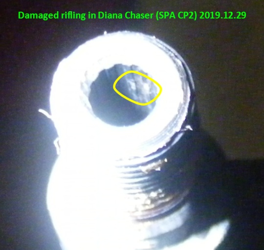

Snowpeak (OEM of the Notos) has a track record of scoring the rifling at the muzzle by using a piloted crowning tool. Check for it. Here's an example...sorry, it's not one of my better photos.

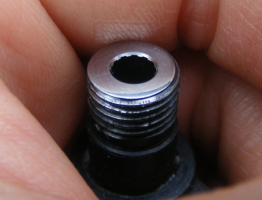

Here's the result after removing about 1/4" and recrowning. Immediately began grouping great.

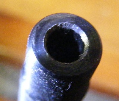

Or it could just be a crummy crown leaving a burr at the muzzle:
If so, a brass screw and abrasive may do the trick.
