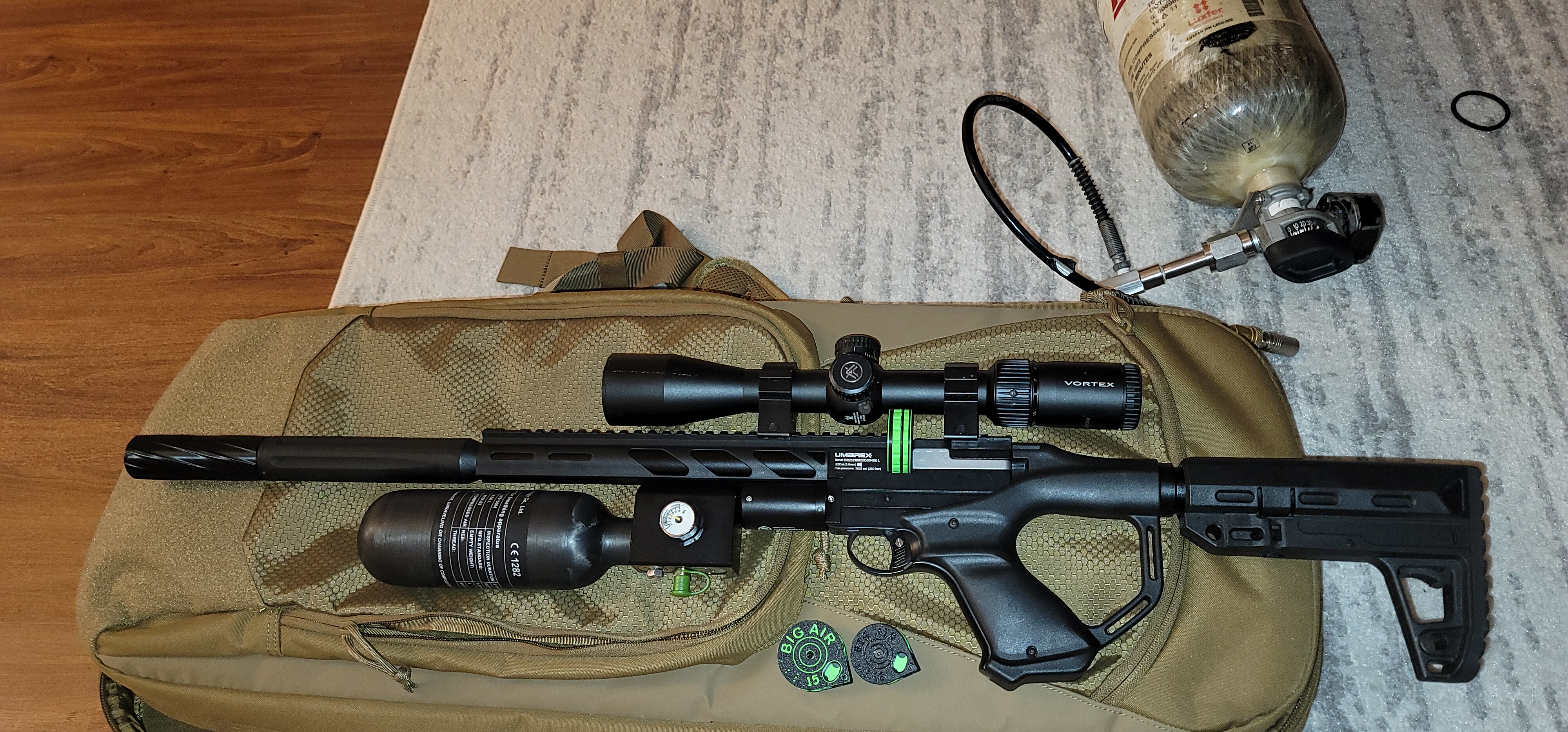

Happen to know what the weight on a notos is after you add in the 500mm barrel kit and a bottle? Curious if its much lighter than a Zelos with its 660mm barrel.
-Matt

I'm not sure what it is with the 500mm fx barrel kit, but mine with a 360cc bottle that nets me about 130 shots from a 4000psi fill with a vortex diamondback tactical scope, tall heavy rings and a mod insert to quiet it down about 8-8.2lbs. But the weight is towards the back so it's not front heavy either.

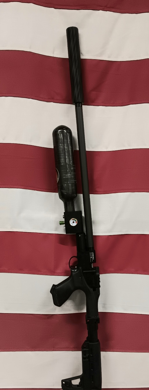

Just for comparison sake, a fully kitted out Notos is 6lbs.
A fully kitted out Zelos is 11lbs.
Notos by a large margin for portability.

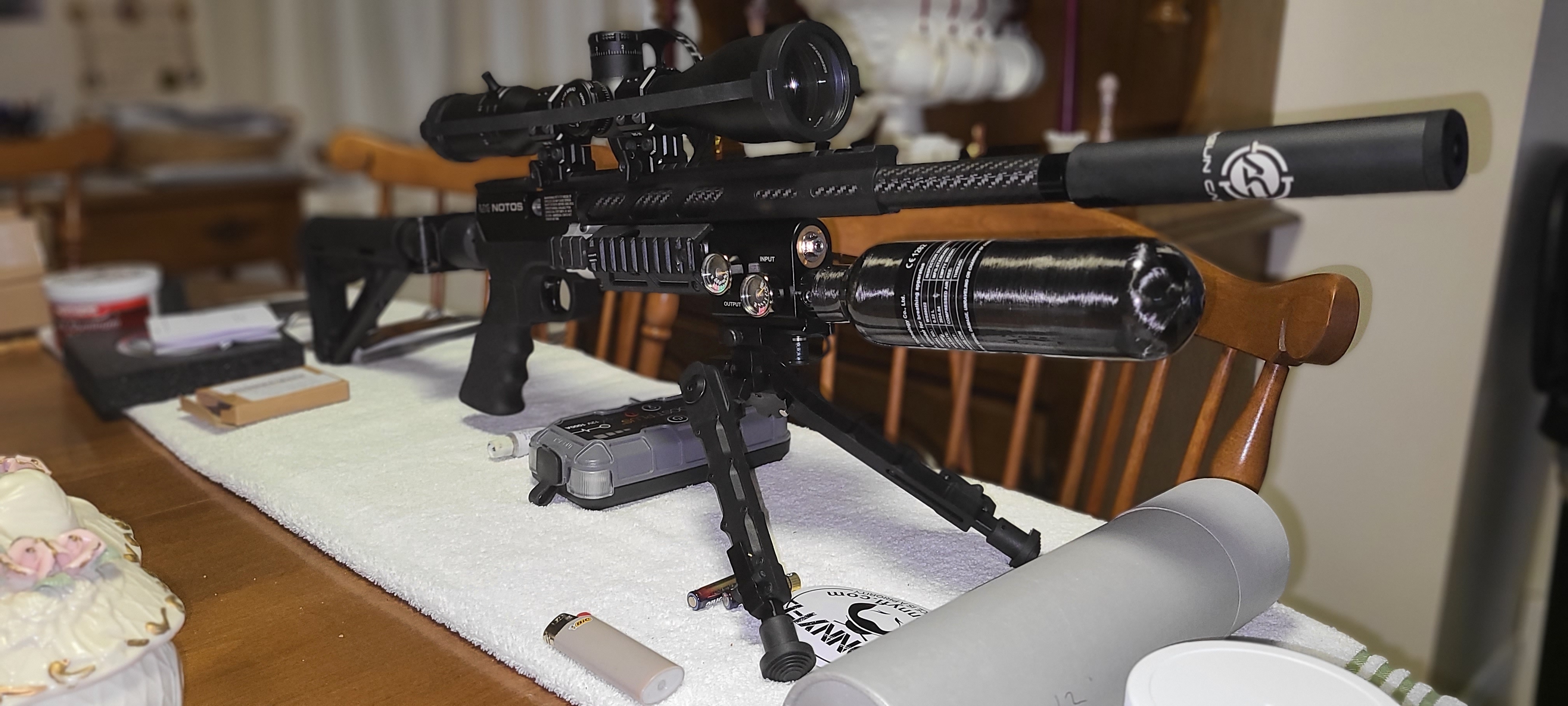

wow mine weighs in at 8.4 with bipod 220cc tank

is say between 12 and 1300
Hawke 4-16x50 sidewinder scope eagle vision scope mounts moderator barrel kit fx 380mm liner fx carbon fiber barrel stiffener gauge block Huben dream Tk Notos regulator 1 c88 plenum extension 2 regulator gauges one on the block huma-air 300 bar and another on the reg
buck n rail complete kit maple peek valve 2 maple mags whatever that cost I'm guessing 12- 1300 never added.
but ya know what i enjoy modding anything with wheels tracks and an engine now i went down the rabbit hole buy enjoy very much so to me its priceless
oh that don't count hrs. of labor lol
That's a beefy bipod though. In reality I don't shoot the Notos further than 50yds and if I do that's to not miss a chance at getting a big iguana. But I could put a 2-7 scope or a 3-9 and cut back almost half a pound, and if I do away with the plastic pic rail and go for dovetail rings along with a 2-7 or 3-9 she'd be sitting pretty close to 7lbs even.

yeah my scope is heavy over 1lb but worth the weight i shoot 50yds as well
This was today at 50
