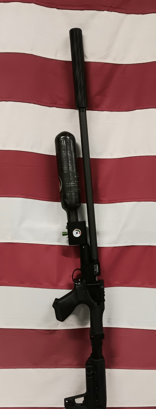

I've got a 15" tj barrel on the way for mine. Was thinking about making a small run of TJ barrel kits... but the price would be ~250 and I don't know if they'd sell.
I think it's cool seeing people's builds on the Notos, but I could never imagine modding mine into something it ain't. It's such a great light weight gun as is and good power level for close range shooting. I guess if I'd want a more powerful, heavier, higher shot count, and longer gun I'd invest in a gun like that already. But hey to each there own. I modded Mrods so I've been down the road, but never changed the form factor or anything just internals and barrels. But yeah I think as is the Notos is great for it's purpose.
If you make them to where they fit with no extra parts or fiddling around. I think they would be worth it.
The 500mm Fx barrel kit is $160 on top of the ectra $110 for the barrel liner not including counting shipping.
So it's already pretty close to $300

It's really only $750 to make the zelos an 80fpe power house? Cause it shoot slugs or just pellets?
Why not? Porting, springs, good tune, your golden.
Notos?
If you do all the work yourself?
YES you can!
Slugs too? If an FX can shoot slugs, so can the Notos! After all, it's got an FX liner!
Notos?
YES you can!
I was referring to the Zelos, but you're right. It is changing the barrel to an FX barrel as well.
