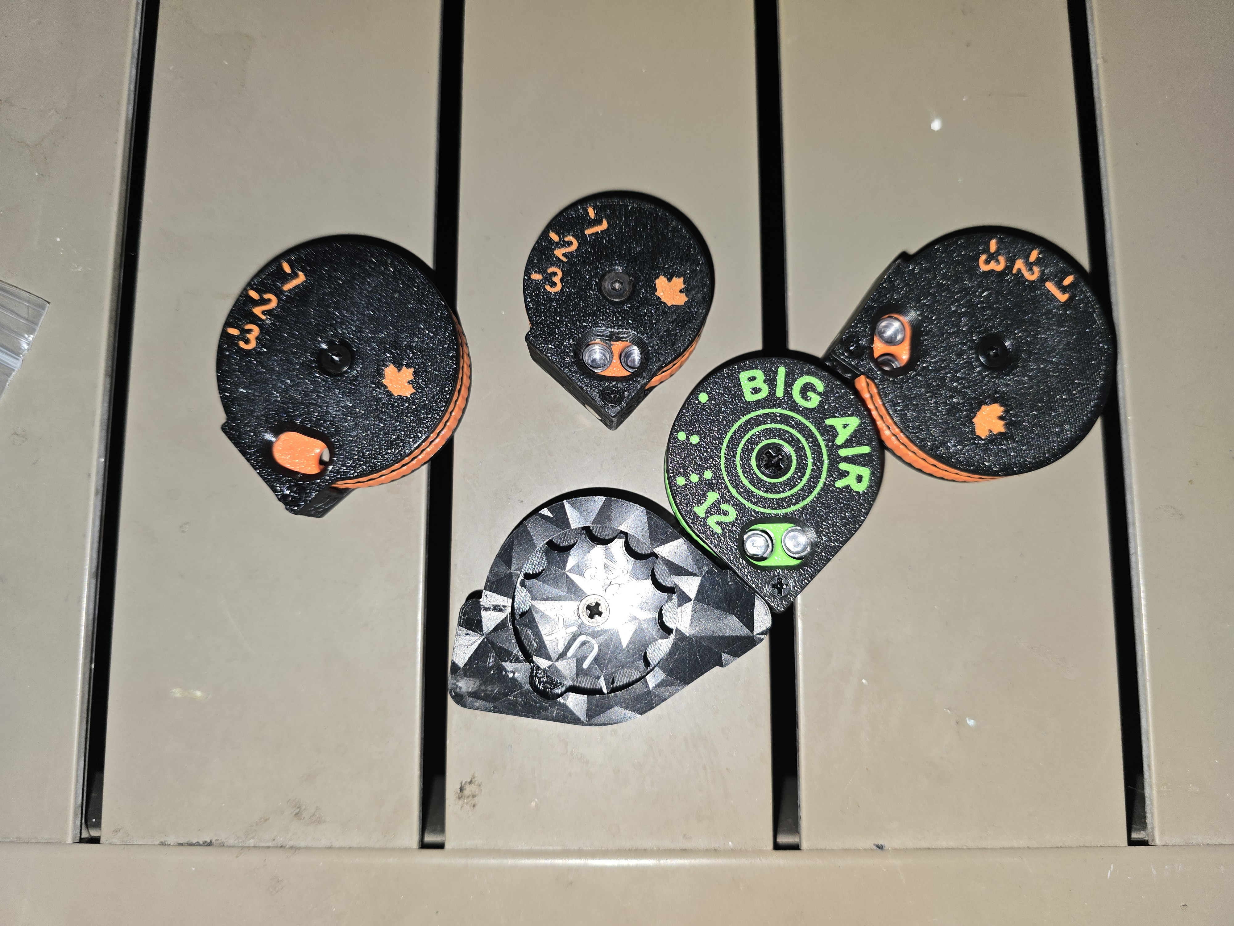

Big Air Precision makes some nice NOTOS magazines but I read that you said it wasn't a magazine issue.
This video make help you understand the NOTOS bolt and cocking lever assembly. The only difference is that the NOTOS lever is on the opposite side.
The issue with the probe being loose causes hang ups as the pellet exits the factory magazine, because it goes in cockeyed into the breech. Getting a Big Air Precision mag fixes the issue as it forces the probe to only go straight.
The easiest fix is to buy new magazines, this is a known issue for the notos since it came out.
Not a magazine issue. I have another Notos so I have multiple mags and does it with all of them. Even does it with both the single shot tray I have. Tried with Maple mags, Big Air, and Orion. That was my first thought as my other Notos had mag issues. The probe is noticeably more "wobbly" when moving compared to my other one

Gotcha, mine did it while being wobbly and the issue was solved by getting an aftermarket mag, yours is clearly has a larger issue at play.

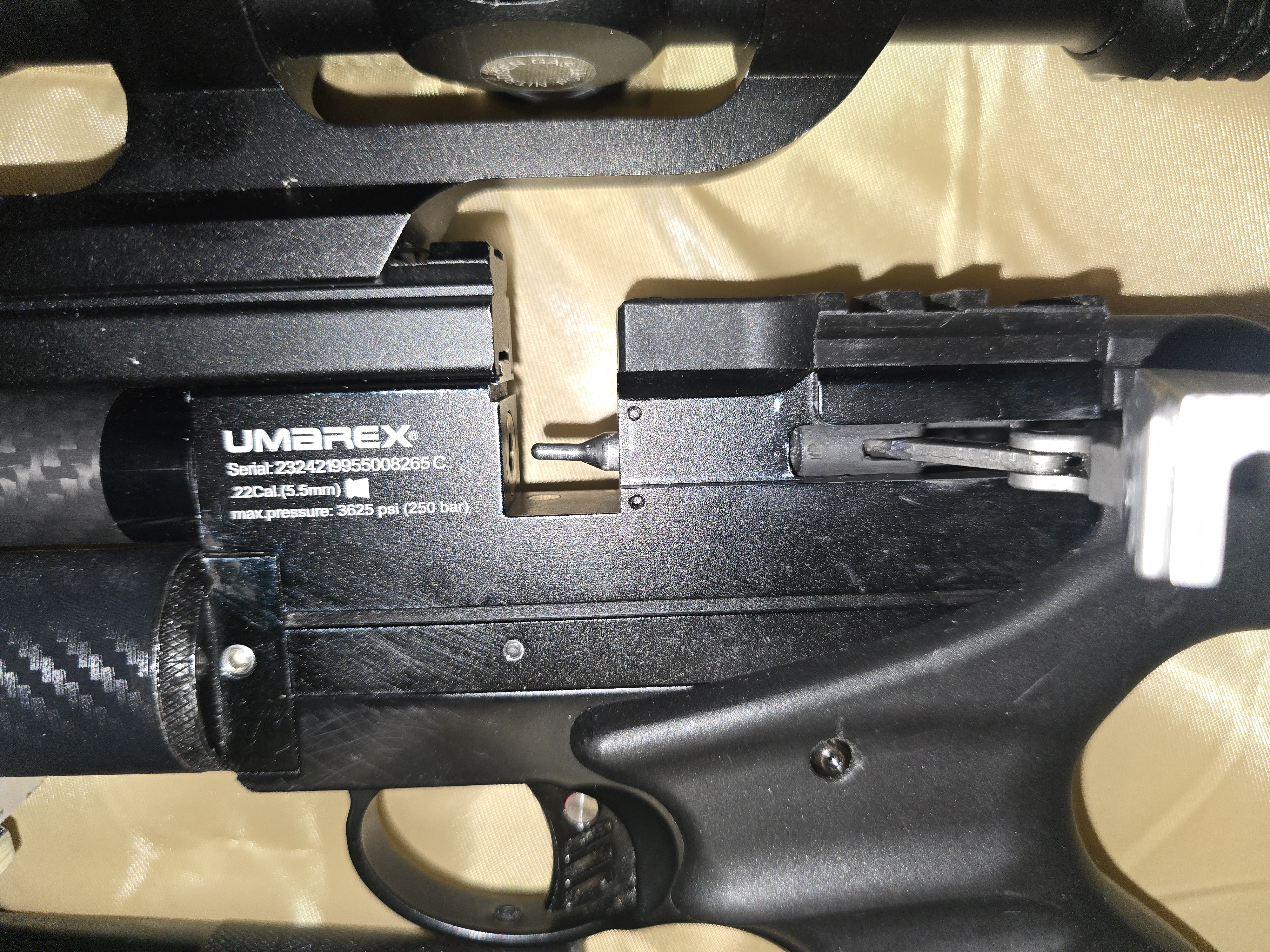

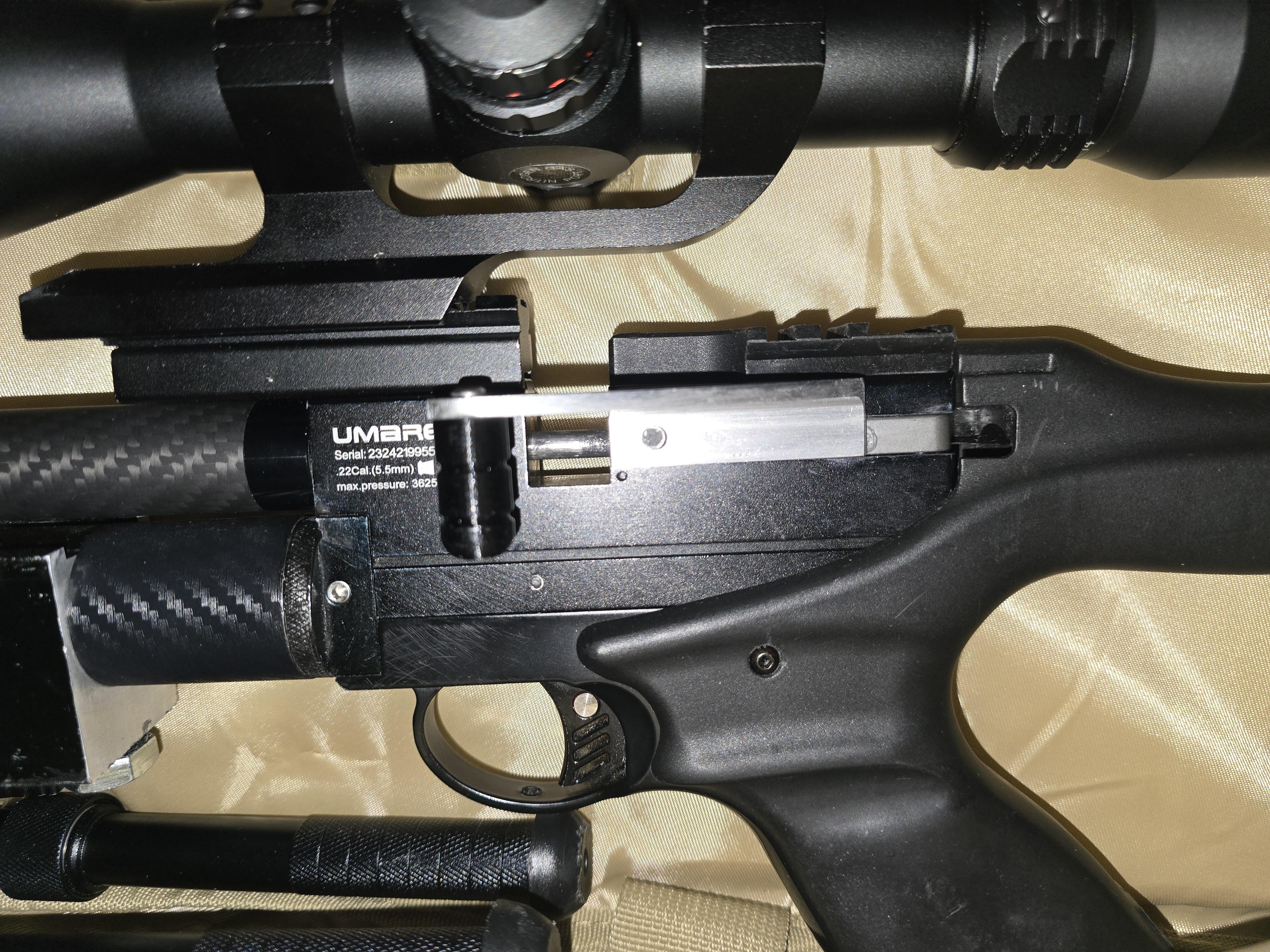

Upon looking at it closer, not only does the probe move, but it is bent upward towards the tip. Makes sense since you can clearly see with the single shot tray it presses the top of the skirt on the pellets and the maple mag it messed up was also in that upper portion.
Looking for a new probe now and straighten this one out and see if it helps for now.

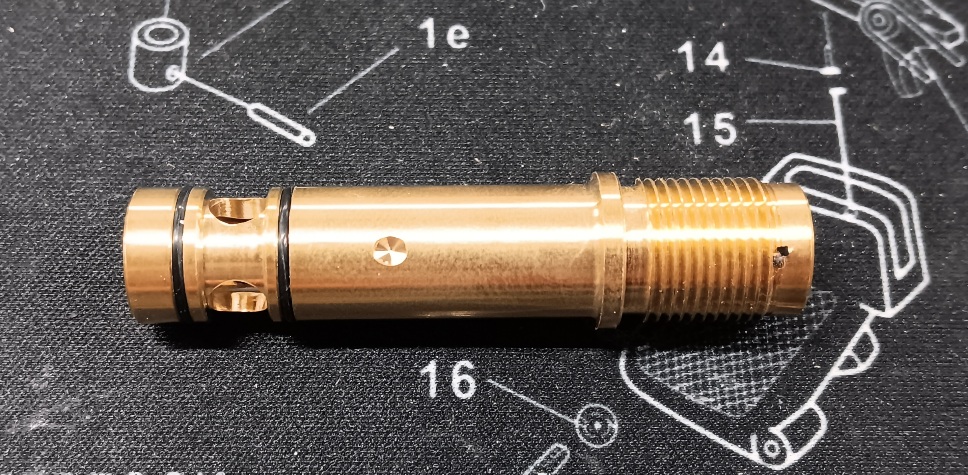

That was mine a long time ago. That shouldn't be possible it has the multiple holed TP for the FX barrel. IS there an oring in that breech? Also, you can turn the TP around... it doesn't matter which hole faces down, There is a channel and it gets equal flow. Is there now a single hole or Bridged TP?
I used primarily 18.13 pellets and 18gr slugs. The only time i had something fall into the TP and try and jam itself was trying to shoot Jumbo RS, and occasionally 17.5 NSA slugs would try to get caught, but, that was with the wide ported Single hole TP. This is the Gen 2 C88 TP unless it's been changed.

https://www.airgunnation.com/threads/my-notos-first-impressions.1315315/page-6 this thread will show the progression of that gun. The Cocking handle and some other things were changes after me. this is the liner receiver/tp/breech that should be in there.
that gun is ported as wide as it gets. smaller pellets are just going to be an issue.
