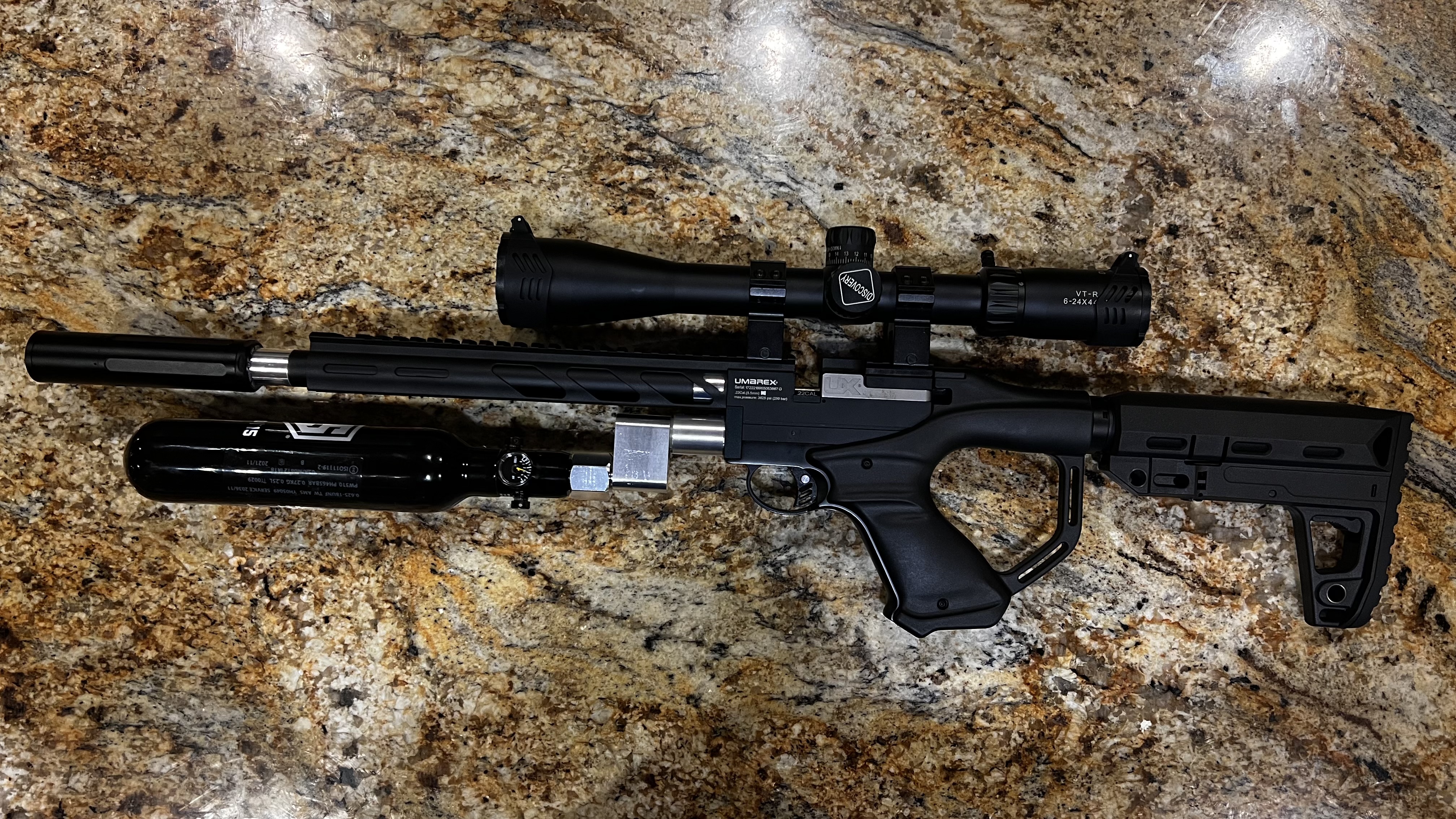

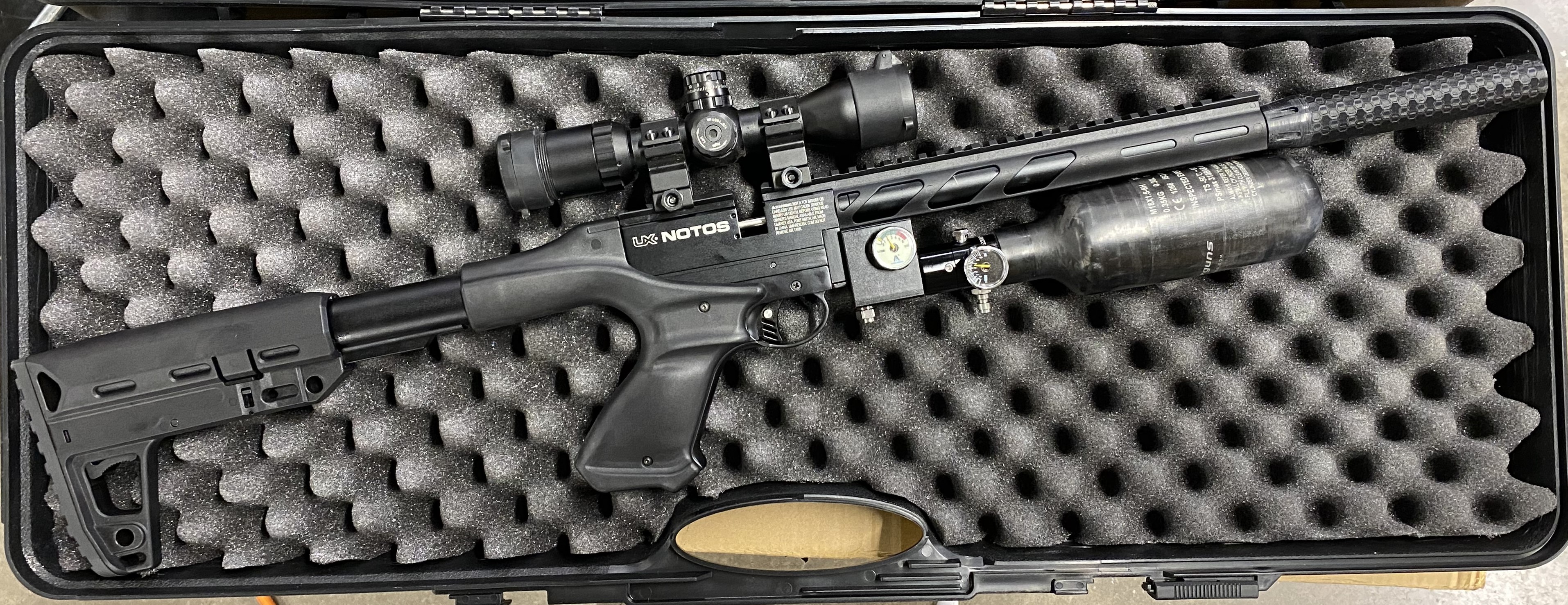

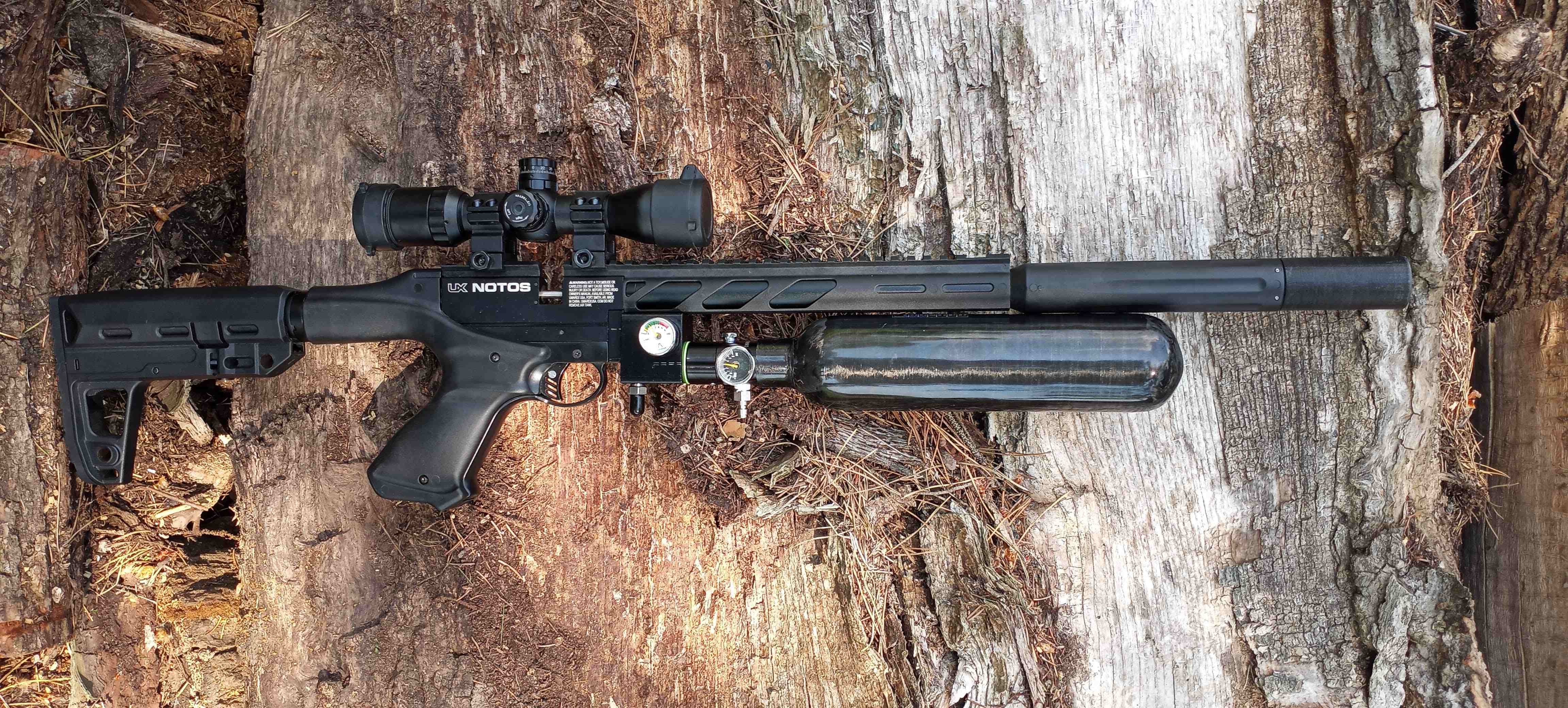

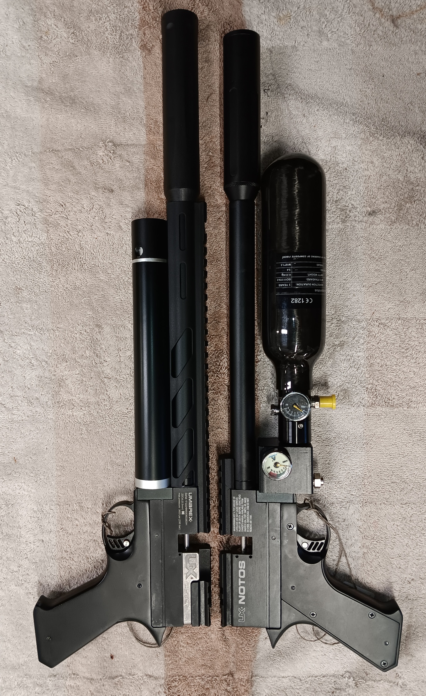

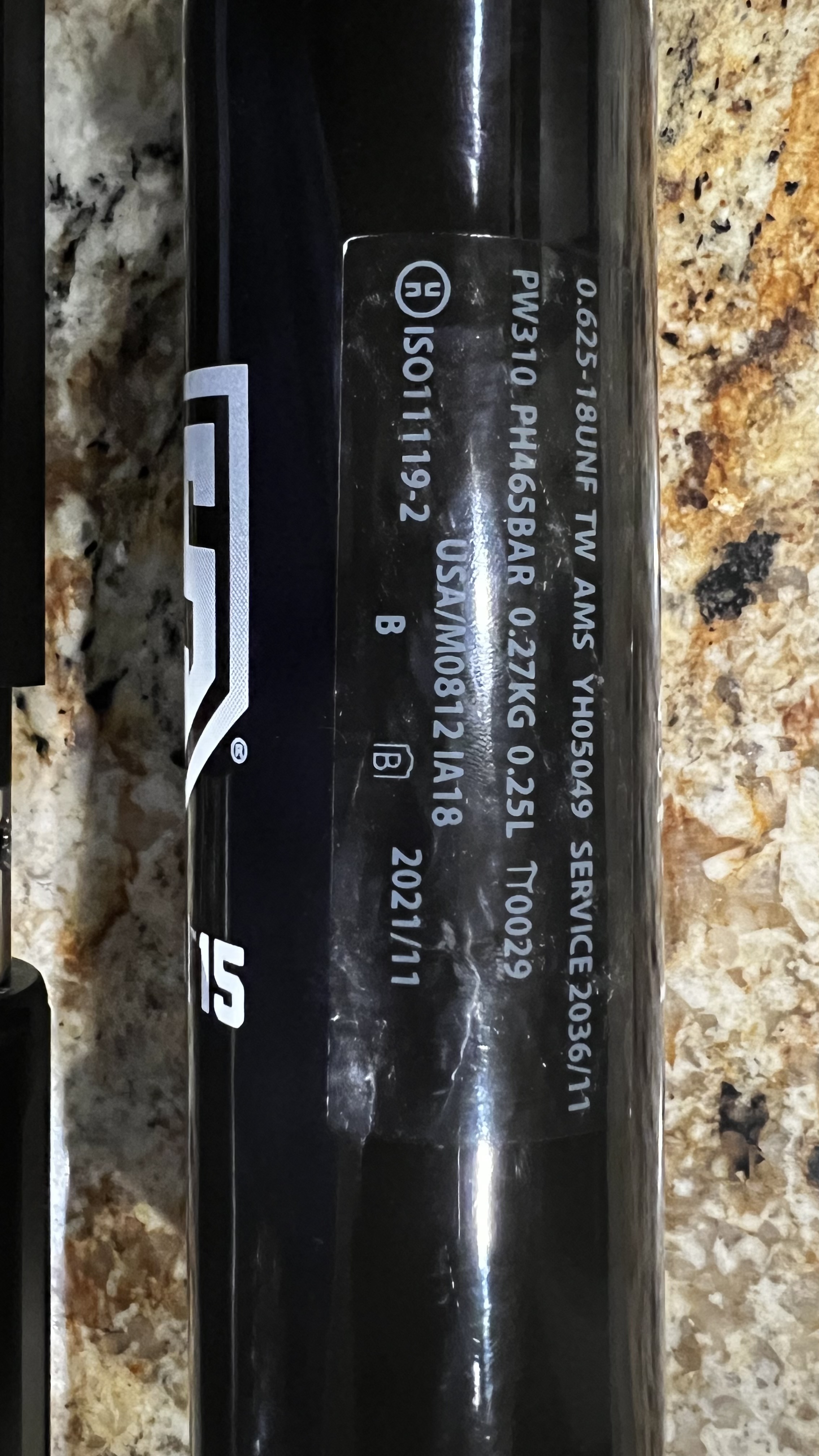

Yes, Im smithing the Notos, I have over 50 conversions under my belt and have three inhouse getting new parts. Please PM me for information, I have everything in stock, including a .2L Carbon Fiber bottle with more arriving in 2 weeks.

Hi Sir,
Did you cut the to pic rail or does it come off? May I ask how you took the moderator off? TIA
I put the barrel in the lathe and cut it off at the 5" mark from the front but didn't cut all the way to the barrel. I then cut down through the two clips holding the molding on to the barrel, cleaned it up and cut the end of the barrel off, re-crowned the barrel and threaded it so I could thread an aftermarket moderator on.
