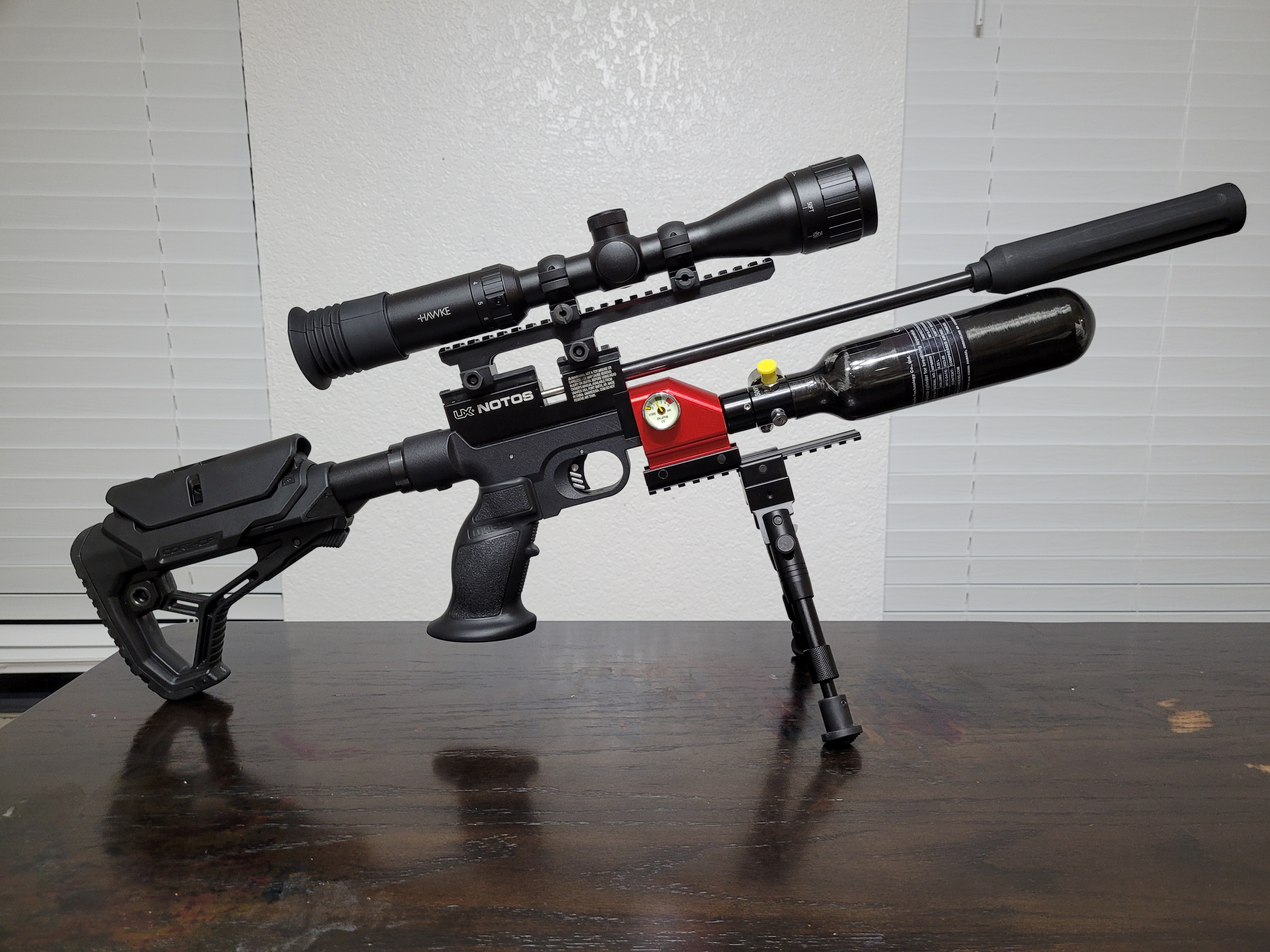

Im considering that same drop block. Do you think a 580cc CF bottle with the reg. linked below would work with that drop block?My notos bottle conversion, .25L 4500 psi carbon bottle
Thanks Firewalker, I've heard of the mods you do but I'm in AK and shipping is expensive. I got the plenum/moderator kit so I might just stick with that but where can I find the Z block?I cannot recommend any CF bottle over .3L, especially with the 2 piece drop blocks. There is a new Z block with an internal regulator is 1 piece and no exterior regulator overhanging and I would be OK with the larger tank on that one.
I think 580cc is too big for a compact pcp like the notosIm considering that same drop block. Do you think a 580cc CF bottle with the reg. linked below would work with that drop block?
agreed, im pretty happy with just the plenum and moderator mods. Over 5 mags before dropping off aint too bad & I love the size and weight too much as is.I think 580cc is too big for a compact pcp like the notos
Firewalker I sent you a email I would like to get more information from you please sir.
A couple of questions, does that drop block act as a plenum? Where did you get the drop block?Here's my rendition of a bottled Notos. Got the bottle on aliexpresss. .22L.
It depends on how the reg is placed in the blockA couple of questions, does that drop block act as a plenum? Where did you get the drop block?
Mine got a 480 cf I had laying here you get a ton of shots at 11 ftlbs I have to replace Foster male end it's leaking and I don't have a small enough one the way it's designed is dumb my drop block has 2 gauges with reg installed and days hueben cricket on it think it came off aliexpress to but there was not any drilling and tapping threads fit everything including my old bottle
It's not timed quite right but I dont really care that it's off to the side some as long as there isn't a leakYou are very fortunate to have had a perfect fit! I've fit over 80 of the Crickets so far and I have not found a single one that was threaded to match the clocking on part 66/the air block.
