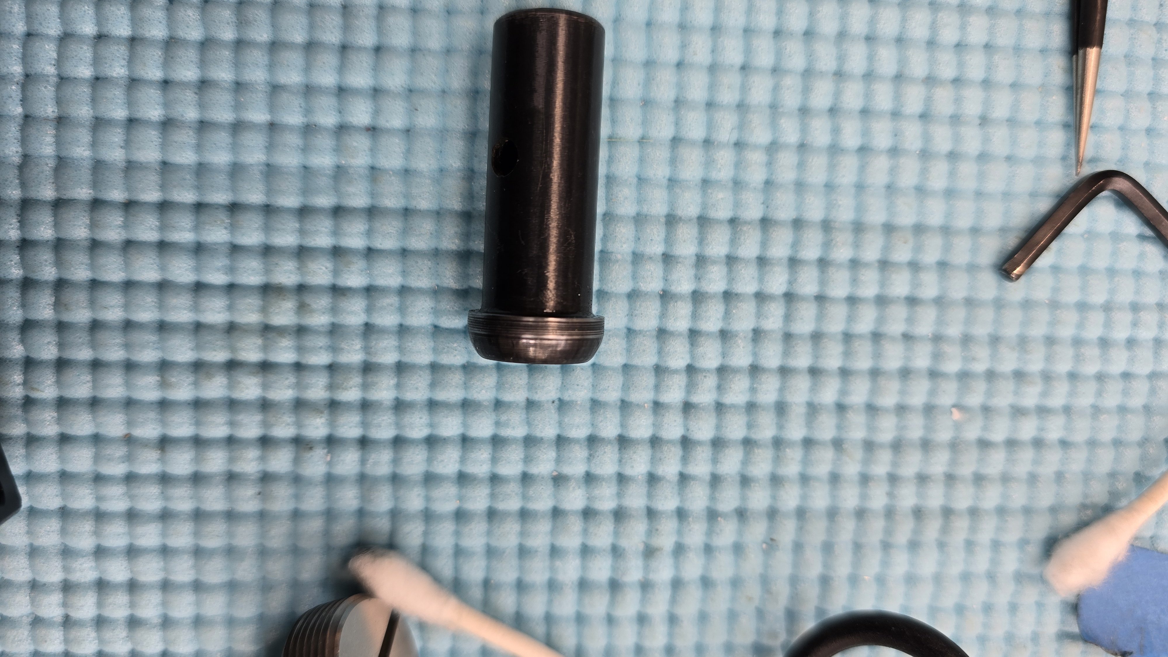

Found some pellet debris
But still little gritty
Cleaned up did some polishing

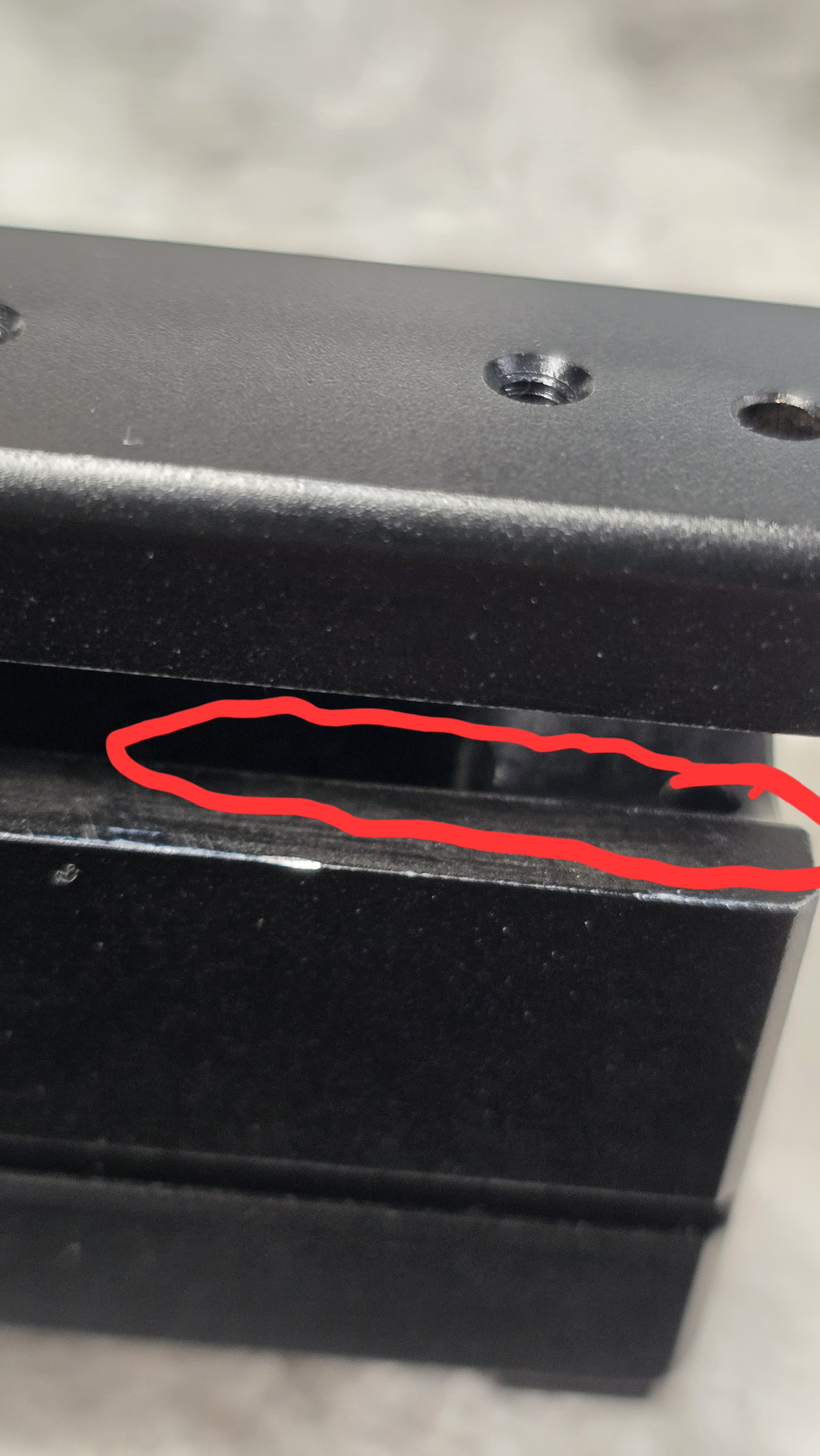

what I notice is from the tension from the hammer spring when cooking causes that bolt to slightly cock and drag on the top and bottom
No galling anywhere strange it was fine couple days later and this

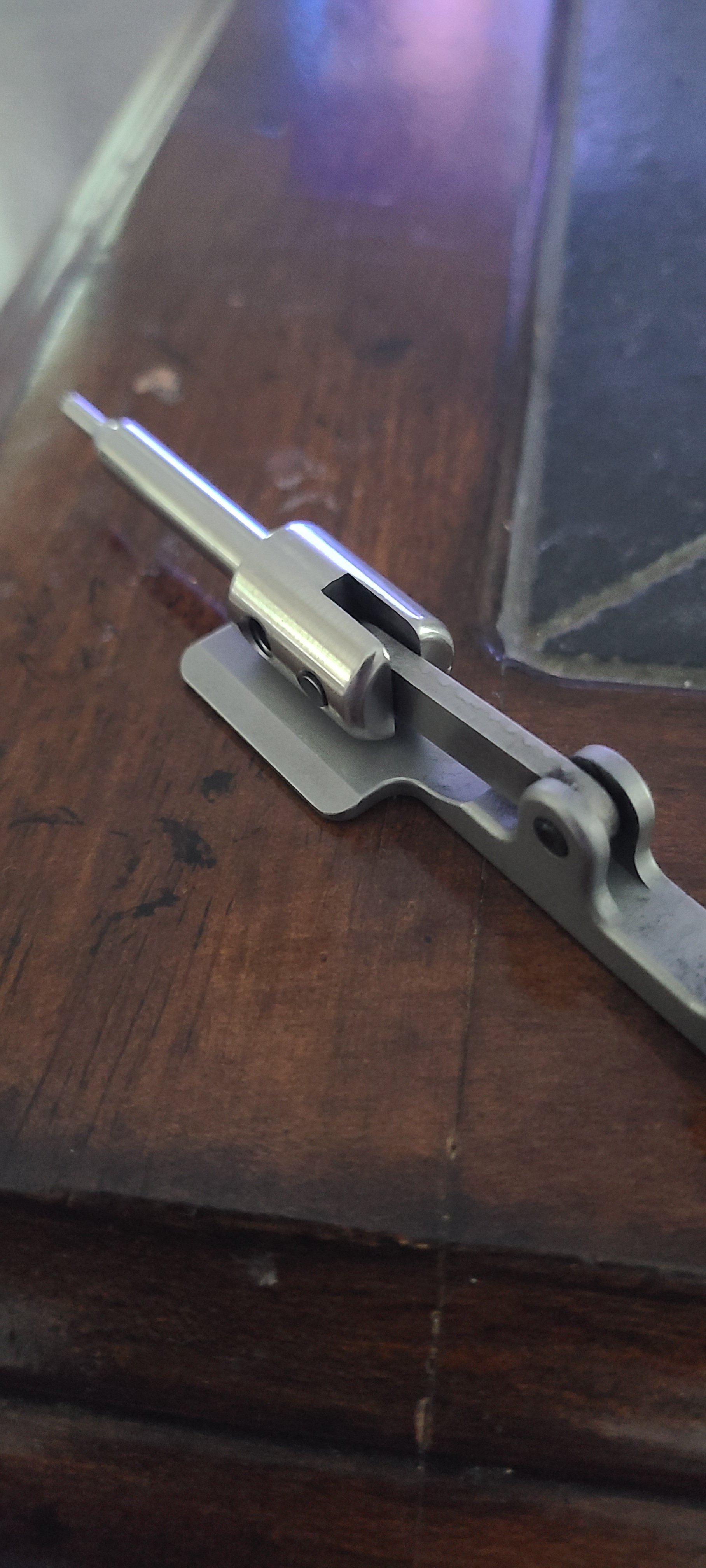

well, found another issue with this
if you look in the picture above that little pin in the cocking lever works its way up and skins the screw holes i found.
needless to say, a small peen took care of that
i also used high pressure black moly grease and skimmed the bolt n bore
now it's back and smooth as butter real smooth, that silicone grease it don't work for this to well but the 5% moly sure does.
