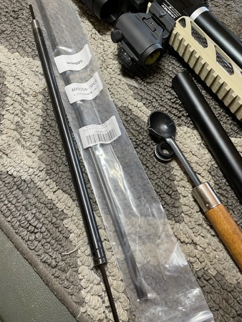

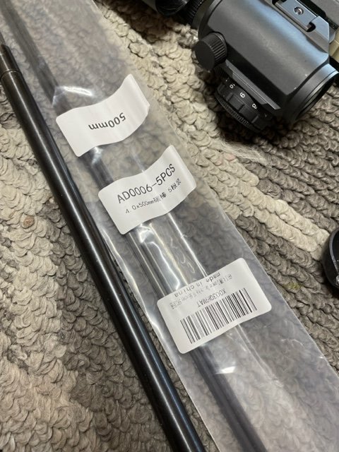

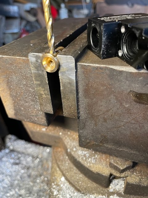

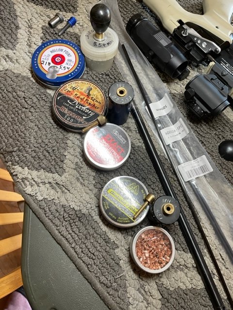

A question was asked about barrel twist of the Notos in another thread, using a 6" long Cerrosafe casting I get a right hand twist at about 1 in 22" to the best of my calc. 91 deg. 24 min in the 6" lenth. I used a 4.0 mm carbon fiber rod to push out the slug. It was a kite kit but works great for clearing jams also as it won't mar the rifling. Last pic are various pellet sizer I made for my brother's guns.
Thank you, SO much for the barrel twist info. (Recently got mine) Haven't had the chance to check it and haven't found the info anywhere online. A 1:22" twist makes sense. I was bewildered as to why this gun is so accurate. Mr. Firewalker is doing some REAL mods to these guns resulting in higher FPS, and they are still shooting well afterwards. I guess UX "took note" and applied what FX is doing with their pellet liners.

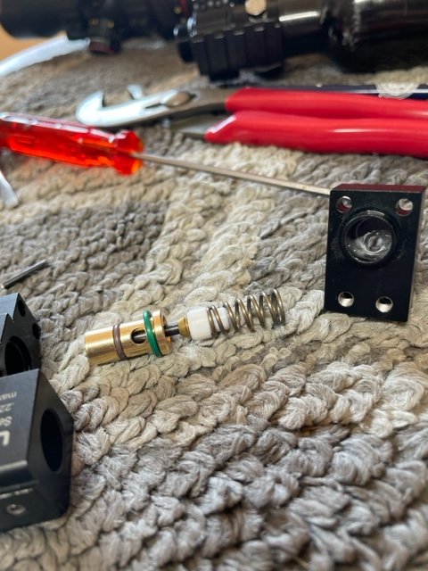

The big difference that the FX liners allow for is the use of slugs, higher velocities and distance shots. I'm told that there are some changes coming for the Notos, nothing confirmed but the design of the gun would allow for more performance if Umarex decided to up the game.

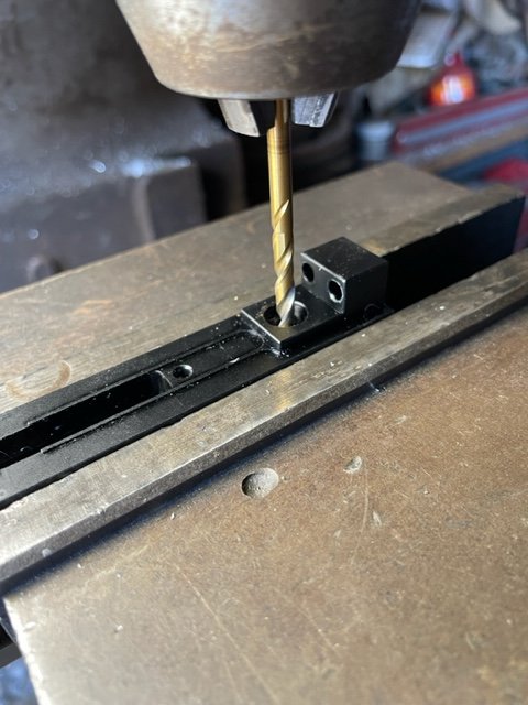

It's from Terry @ Buck Rail, look at post #77 for before mods. I also opened the hammer spring access to allow spring removal/change without removing the lower section. Below is final version compared to my home made Prod, also now regulated with Notos reg and tank.

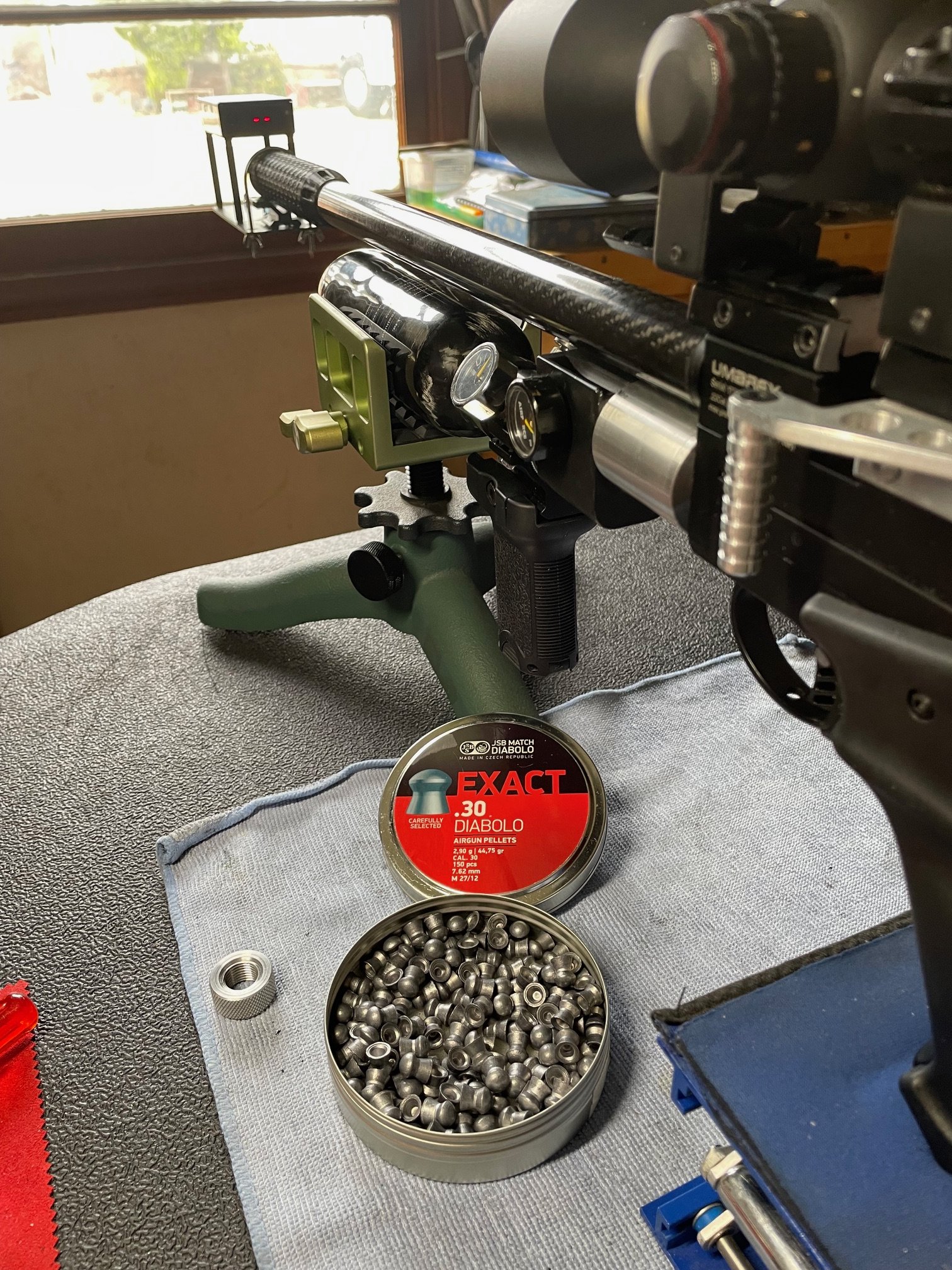

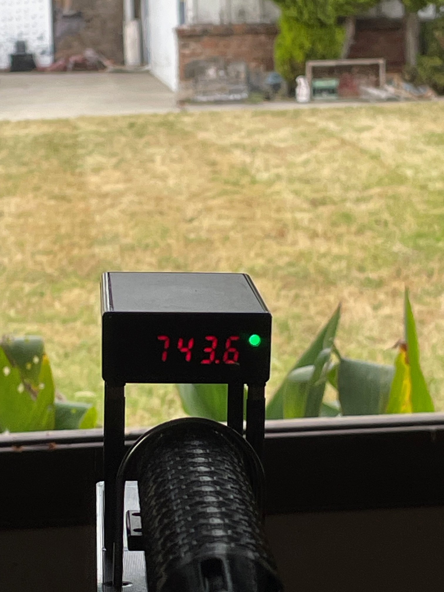

Spent this morning testing my brothers Notos, we installed a 30 cal 450mm reximex barrel on it. We were aiming for 75+ fpe on this project. But had disappointing results, maxing out at 55 fpe with JSB 44.75s. We can't put any bigger valve on it due to the action block width. This test was done with 2200 psi reg pressure, so even turning up to 2500 will only gain another 5-8 fpe. So back to 25 cal it goes. Glad we didn't make a mag for it and waste time, lol.
