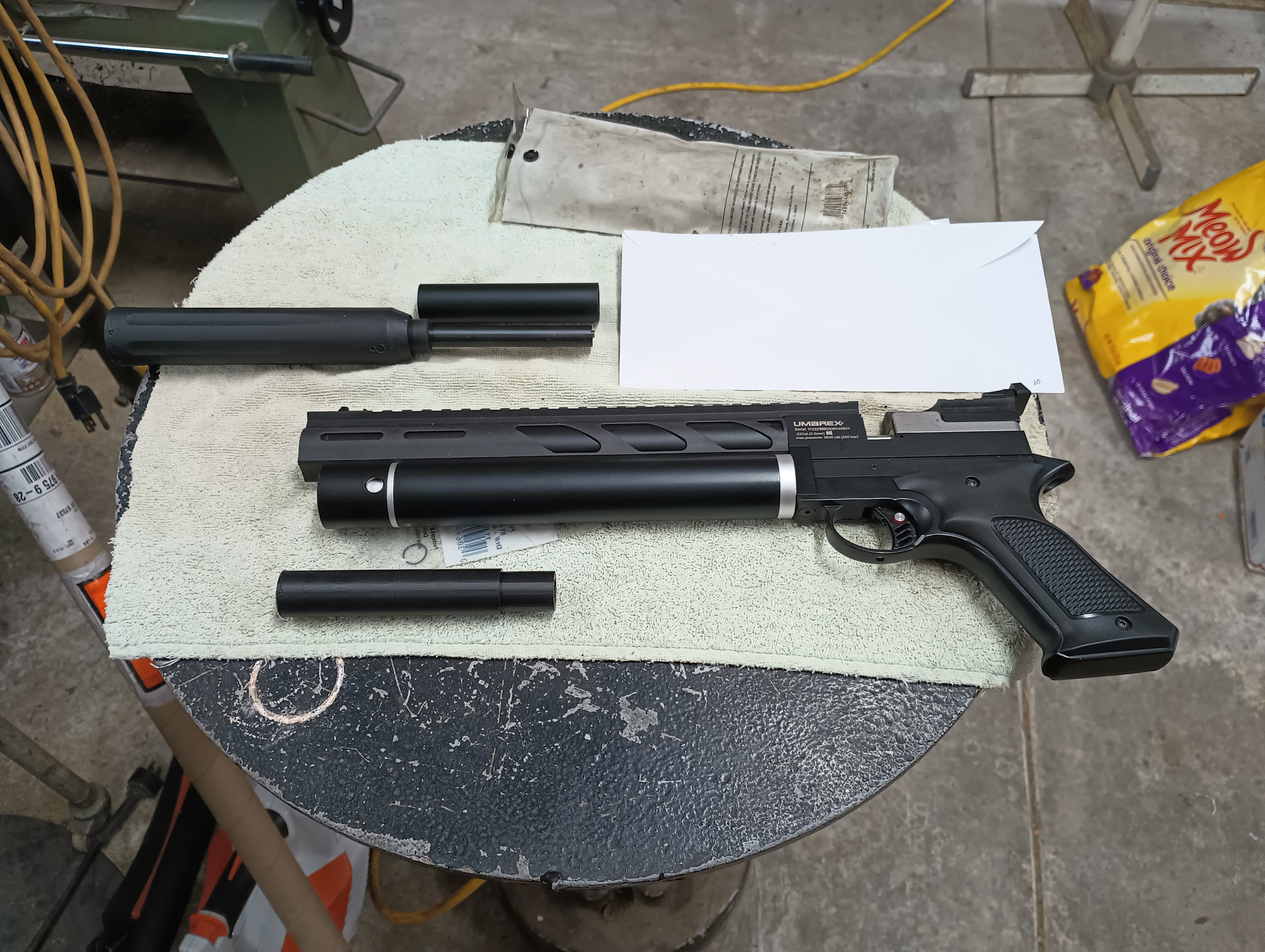

Does the Notos HAVE a regulator ?? For some reason, I was of the impression that they did not. Neat little rifles though !!
yes it is inside the air tube right where it screws on the body.. same as the pelenium.. they are inside the air tube..
now to shorten my air tube so I can make it 12" overall like the attaman ap16 compact.. yes I figure I'll only get 2 magazines instead of 4 worth of shots but I really wanted more compact..

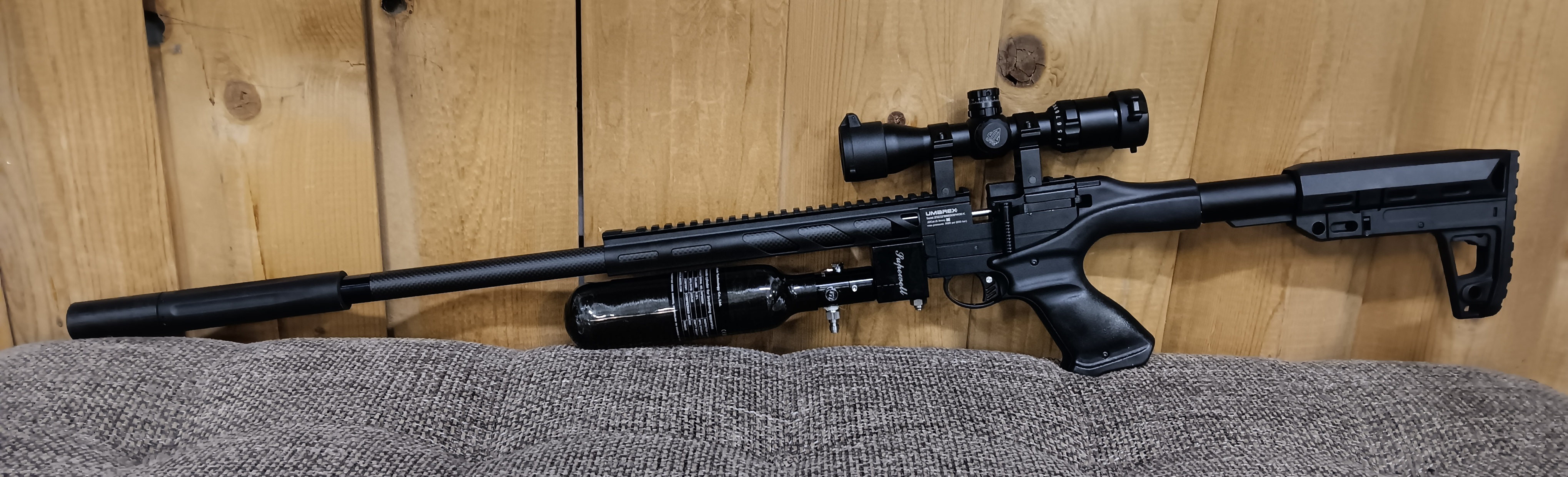

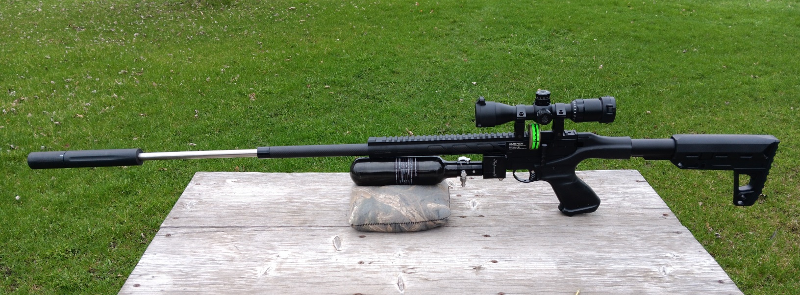

Is there anybody doing the after market up grades on the Noto? What do you get and what do they charge? I see where Firewalker says $600 parts, is that installed? If you run a cottage industry send me a PM with the info. Really like the Notos but it is a little crude and the tank is a little small. I have the trigger about right but the safety doesn't work.
Reactions: Firewalker
That would be me, Bill. Shoot me a PM and we'll talk.
$600.00 was everything you see including the gun but not the scope. It's a prototype series I'm working on for c88machining.
