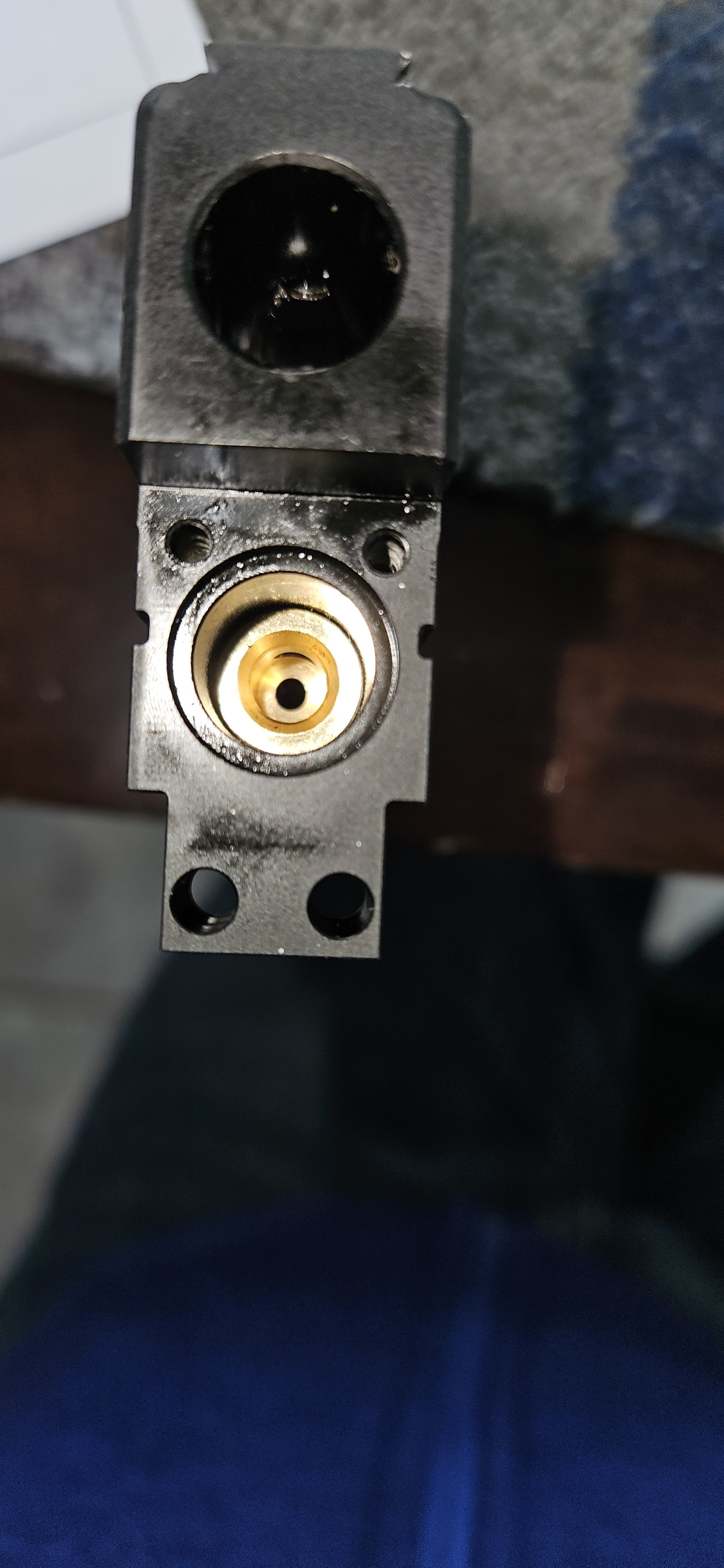

It's taking a long time for my poppet from Maple Custom Products to arrive, so I decided to disassemble the gun again and think i see an unseated o-ring for part #40 "exhaust valve" when looking through the hole in the bottom of the breech.
I've included a picture of the suspected unseated o-ring and wondered if I can push the exhaust valve out to replace and/or reseat the original o-ring if it has no damage (unlikely)? I've tried pushing it out from the side opposite where the poppet seats but didn't have any luck yet. I wanted to see if it's possible to do before I go too far and break something else.

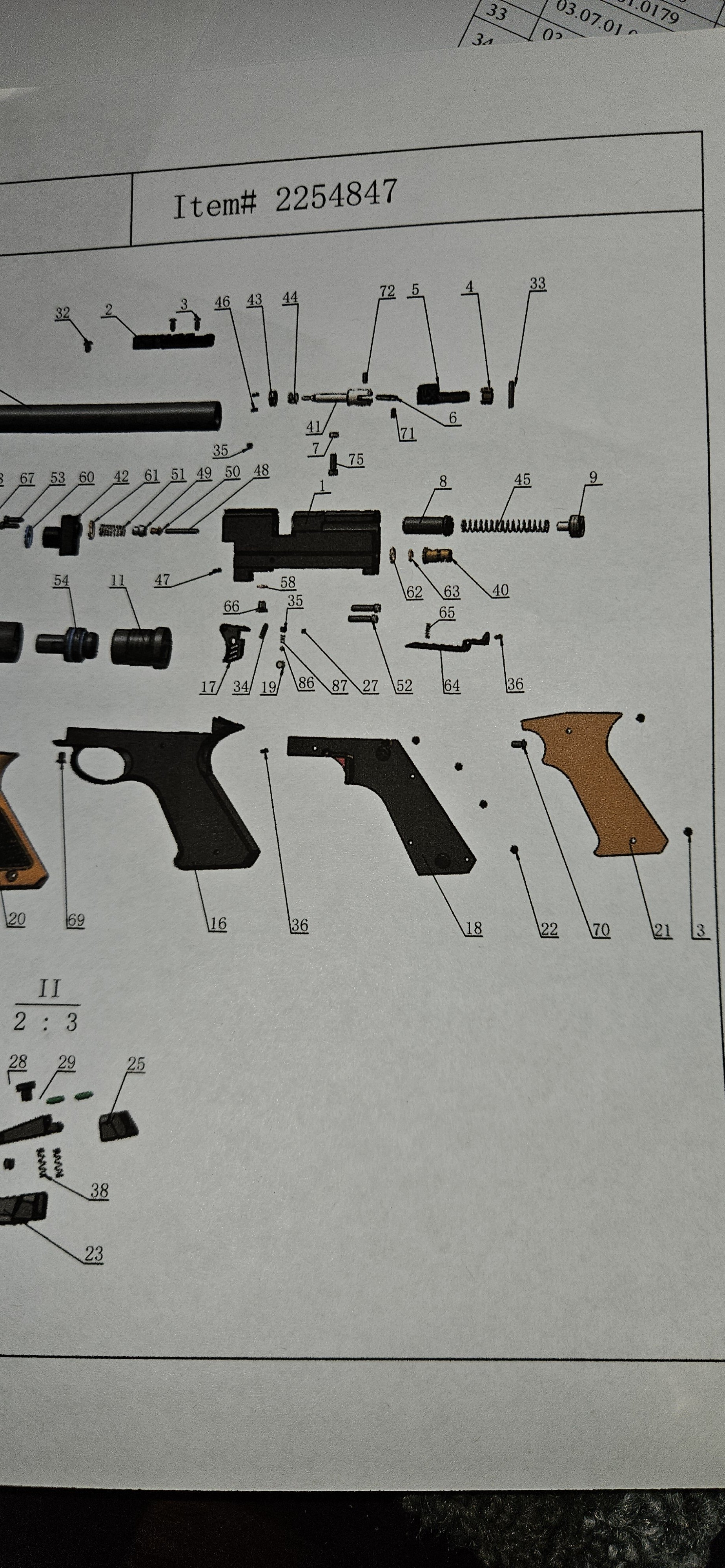

I've reseated the exhaust valve with the original o-rings hoping that might do something but it is still leaking air out of the barrel. I suppose I'll need to wait for the poppet to arrive to see if that fixes the problem. However in the meantime I'd like to order new o-rings for the exhaust valve. The diagram lists them as 9x1.5 and 6x1.5, I will order some but there are different materials with different hardnesses. Does anyone know what material and hardness i should look for?

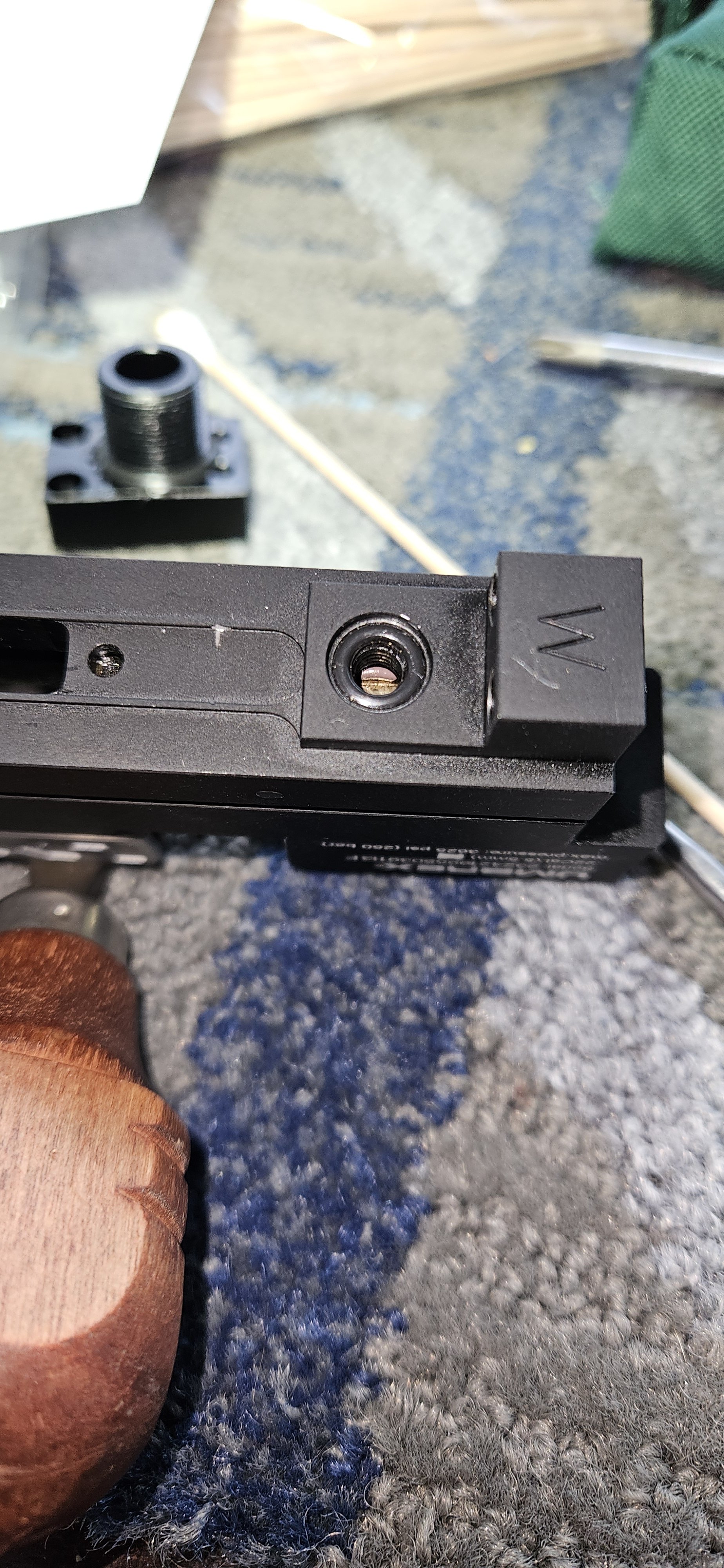

I think this is where I'm currently having problems. I have a 4.5mm drill bit and a 4.5mm reamer but they both hit the threads in that hole.
Are you talking about this hole?
I've removed the oring, and disassembled everything, not like in this picture, before I attempted to see how the 4.5mm drill bit non threaded shank end would slide and it hits the threads. It doesn't slide clear to the hole I need to enlarge.
Same thing happened with me. So I drilled to 4.3 and did some very careful work with a fine abrasive cone bit. Then polished
