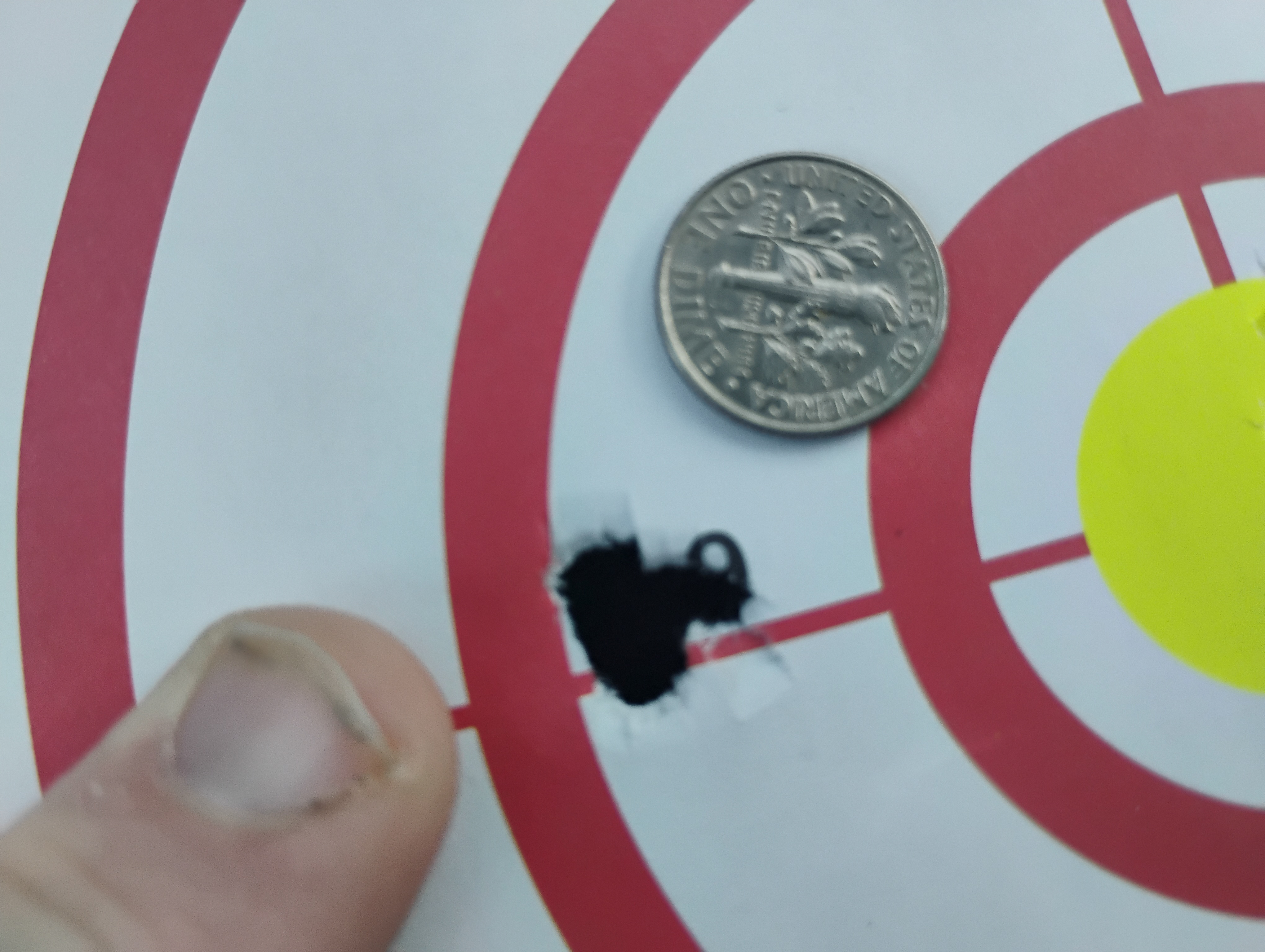

Over the holiday I tested some heavier .22 (.2195) Varmint Knockers 28,28.5, and 32.8gr slugs through the stock notos barrel. The VK. 28 one holed a 5 shot group at 35y, the 28.5 did a tight clover leaf. I'll take some pictures this afternoon. But this has led me to order some 20-25gr slugs. MV:630~ is. A little too slow for me, but 700-740 is doable. 17gr is a bit light for the wind conditions In the winter here and the BC is in the .063/.066 neighborhood. The 23gr is in the .090's even with a muzzle velocity of 700 it's still moving near 615fps at 100yds. 19fpe at 100 is plenty.

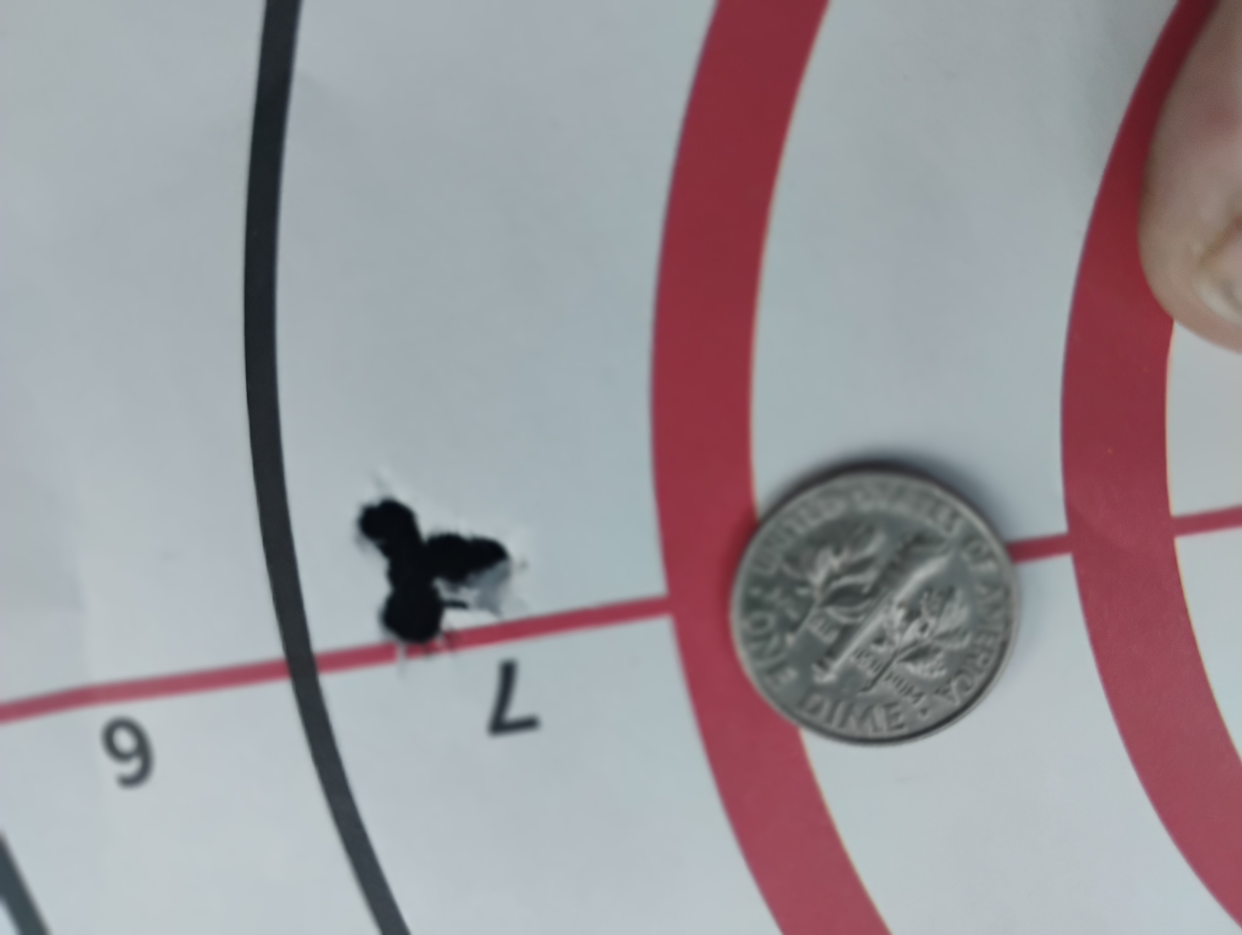

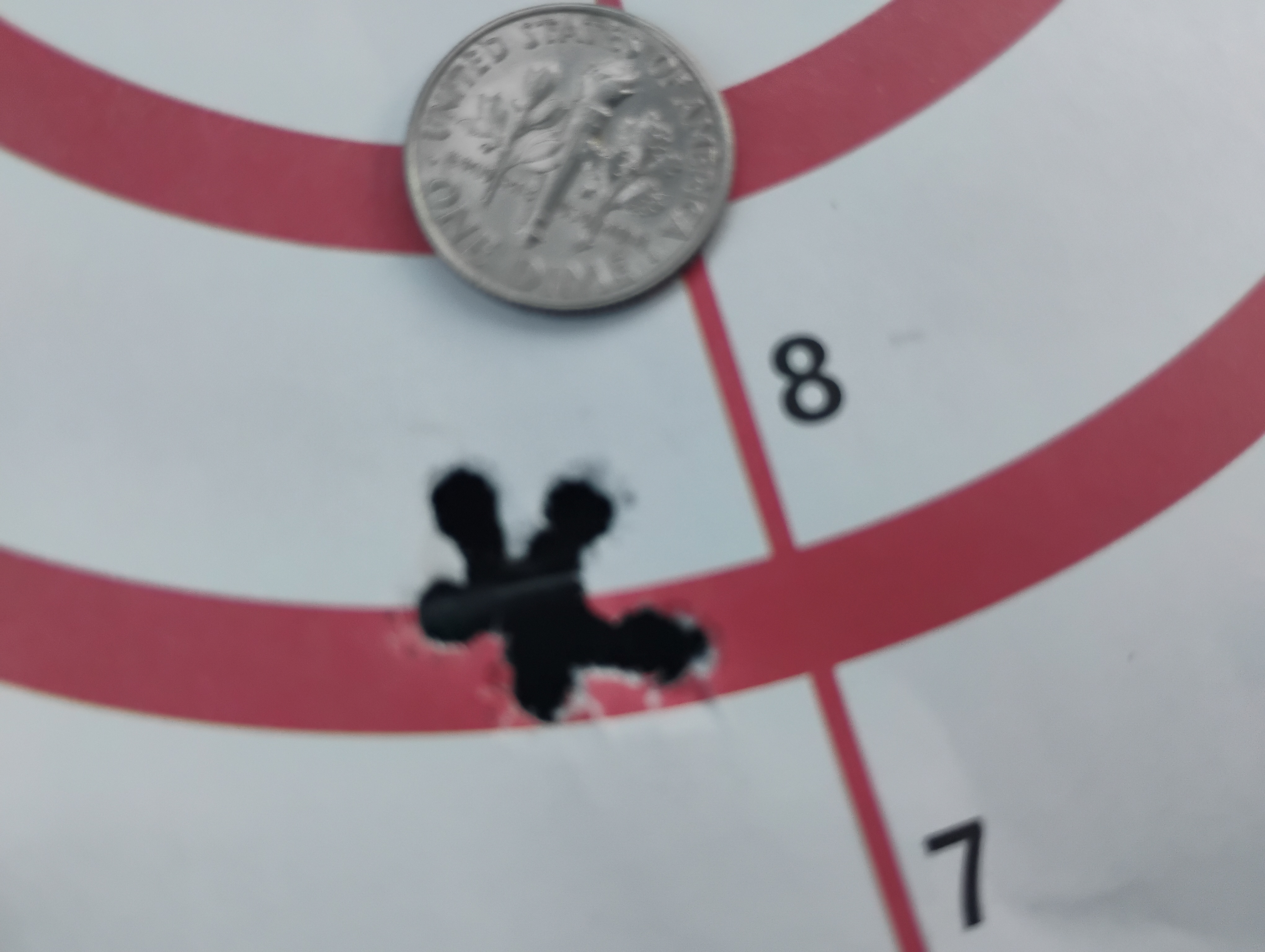

Tried NSA .217 and .2165 they were ok, not as good of groups as the 13.43gn pellets
28.5gr .2195 Varmint Knockers 10shots ±630
28gr Varmint knockers .2195 5 shots ±643
(.218) NSA 17.5gr 5 shots ±781
AOA is the only place I can find the .2175/218 NSA 17.5
