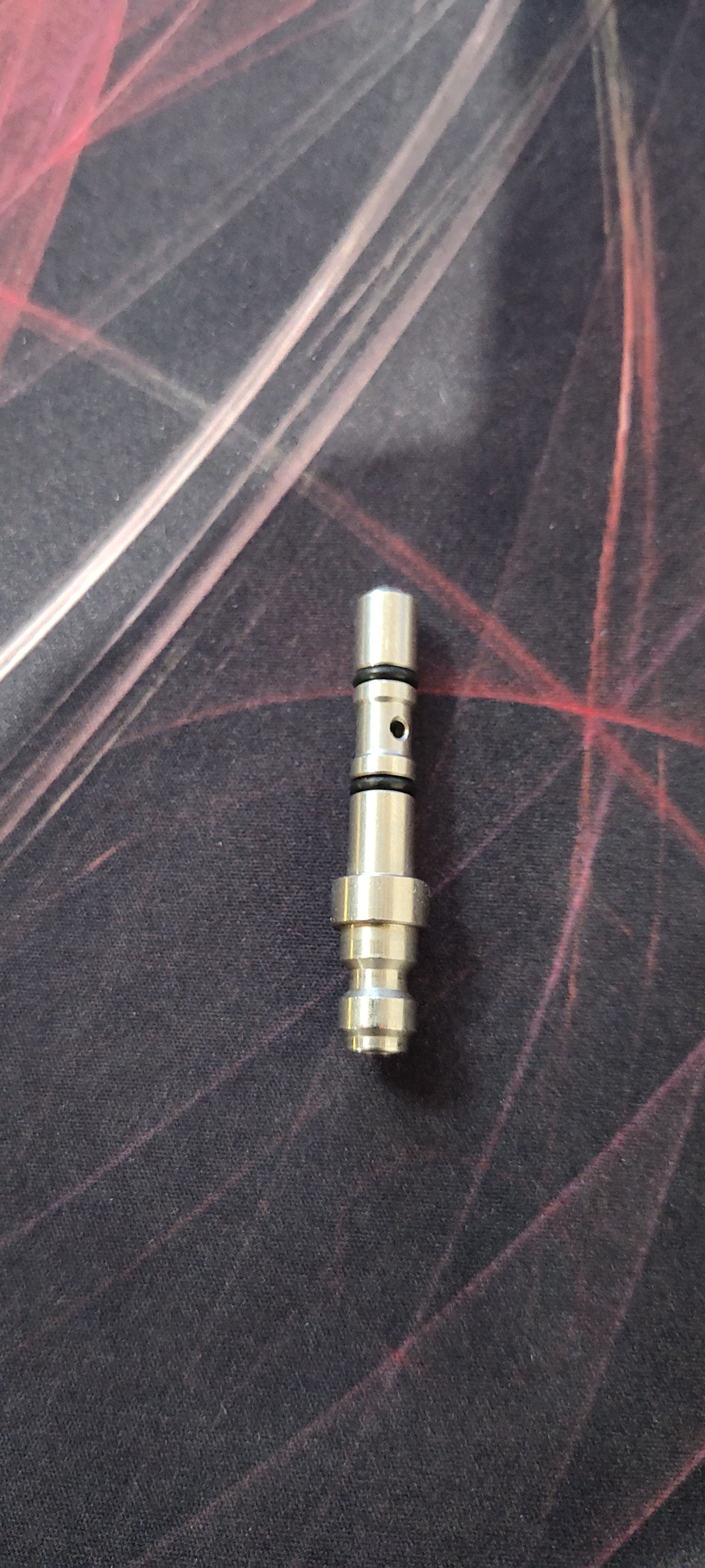

i finally got the notos i just bought, but im running into a issue where it will not fill now, it almost sounds like its leaking out of the fill probe or the female quick connect fitting. i tried talking to pyramydair who i bought it through and they are telling me to basically trim the fill probe on the notos(i just bought this, im not trimming anything). i kept pushing the male fill prob into the female with my hands and somehow got it to about 1k psi, or so the gauge says, but after another 300 or so pumps its still at 1k and not budging.
Post a pic of your probe

i swear on the life of me its the female quick connect, almost like the probe isnt seating on the oring inside of the fitting, like under the little ball bearings. but the guy at pyramydair swore up and down that wasnt the case. the probe has play in it when its in the fitting, and i "think" me pushing the probe hard into the fitting while someone else pumped was what got the 1k into the tank in the first place
