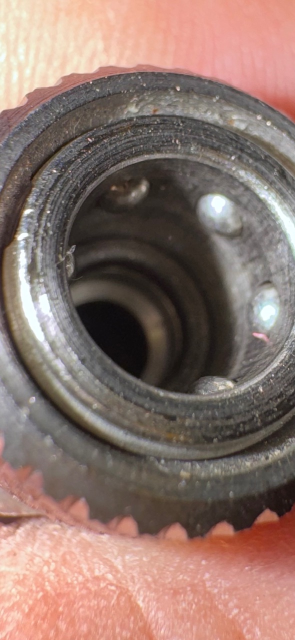

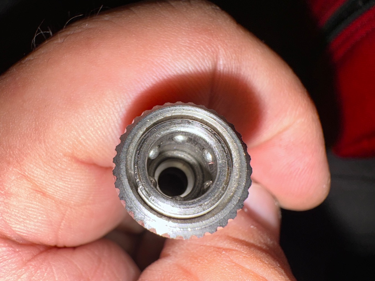

everything is brand new, pump connect gun all came in the same box today, so i think it looks ok, but its kinda hard to see into the hole to really tell. maybe a little smallAhha. How’s the o ring in the qd?
Upvote 0
If you’re getting a ton of play then yeah maybe like you said it’s the qdeverything is brand new, pump connect gun all came in the same box today, so i think it looks ok, but its kinda hard to see into the hole to really tell. maybe a little small

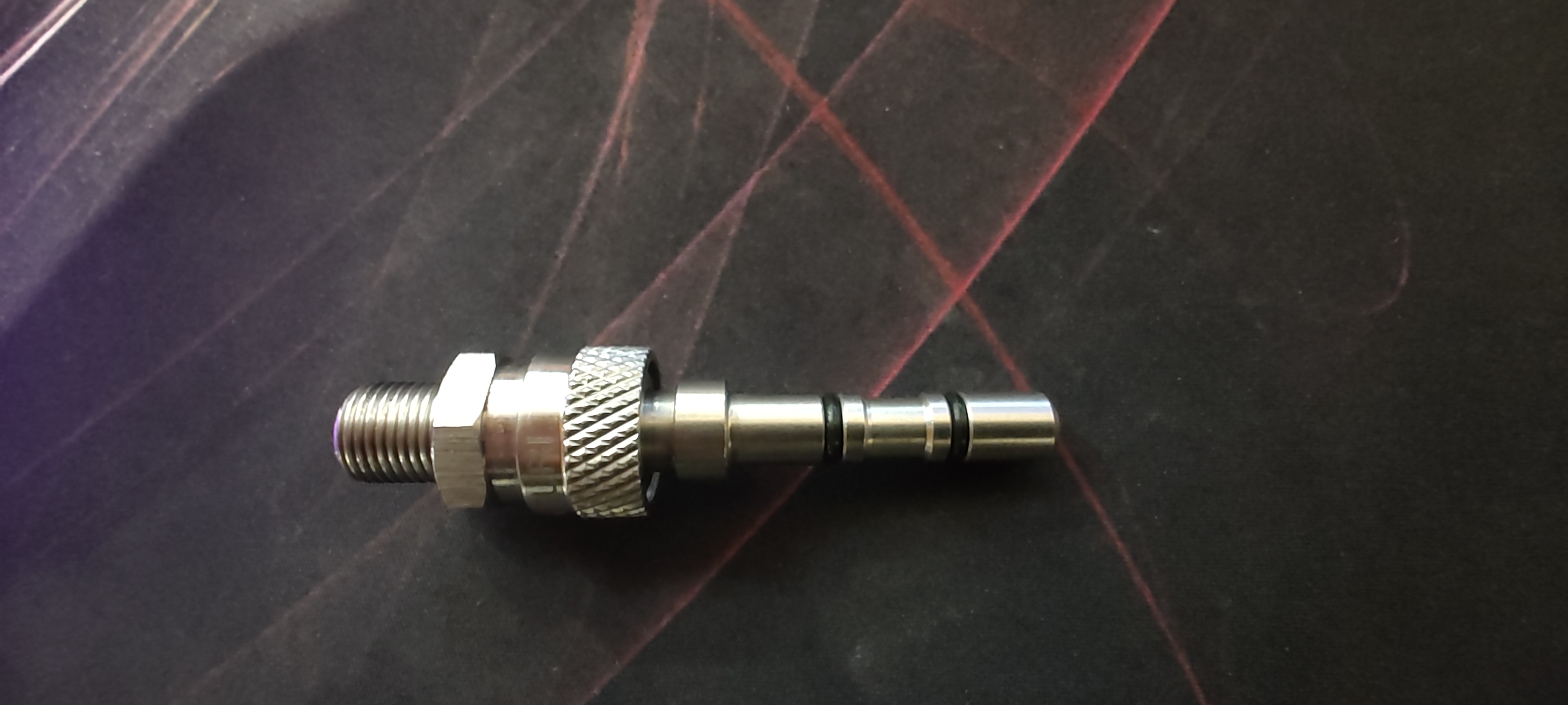

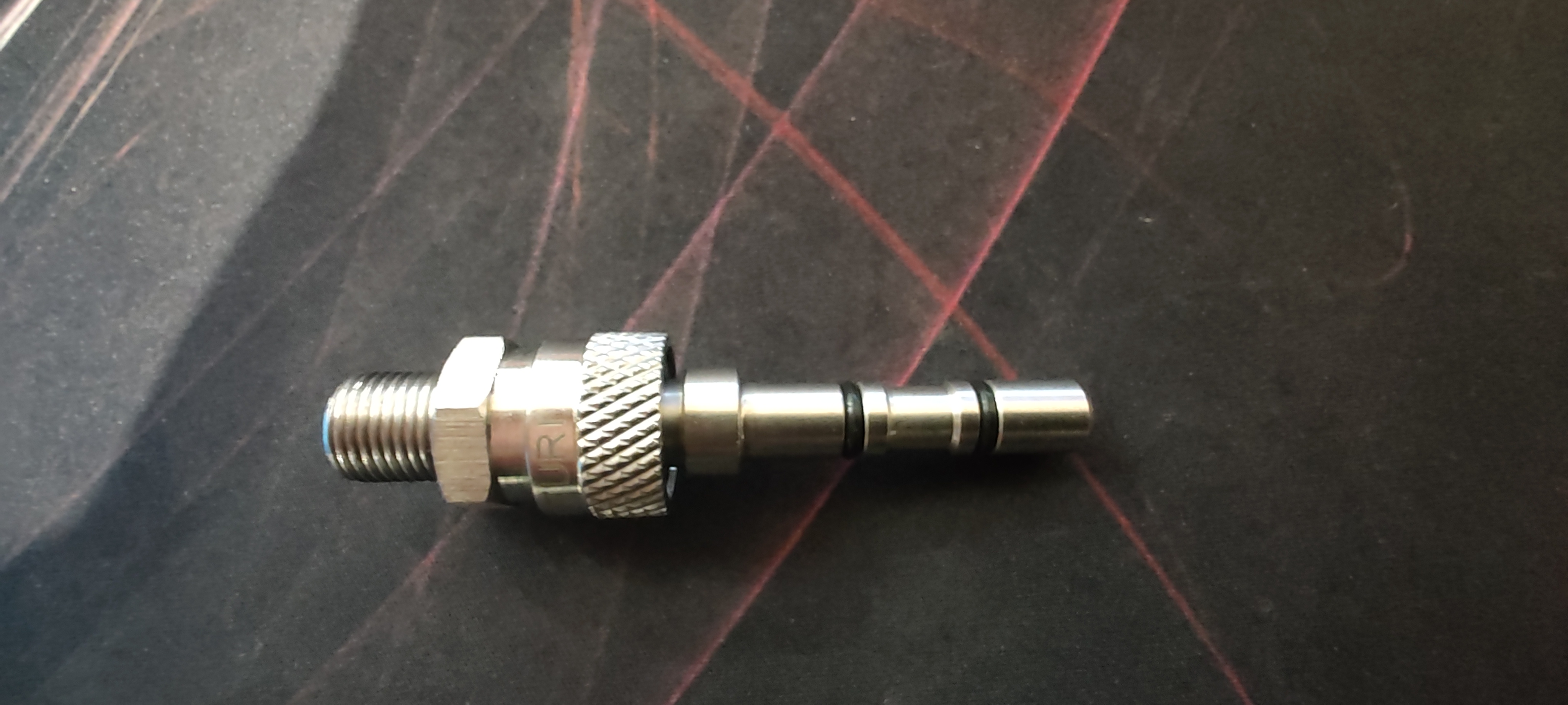

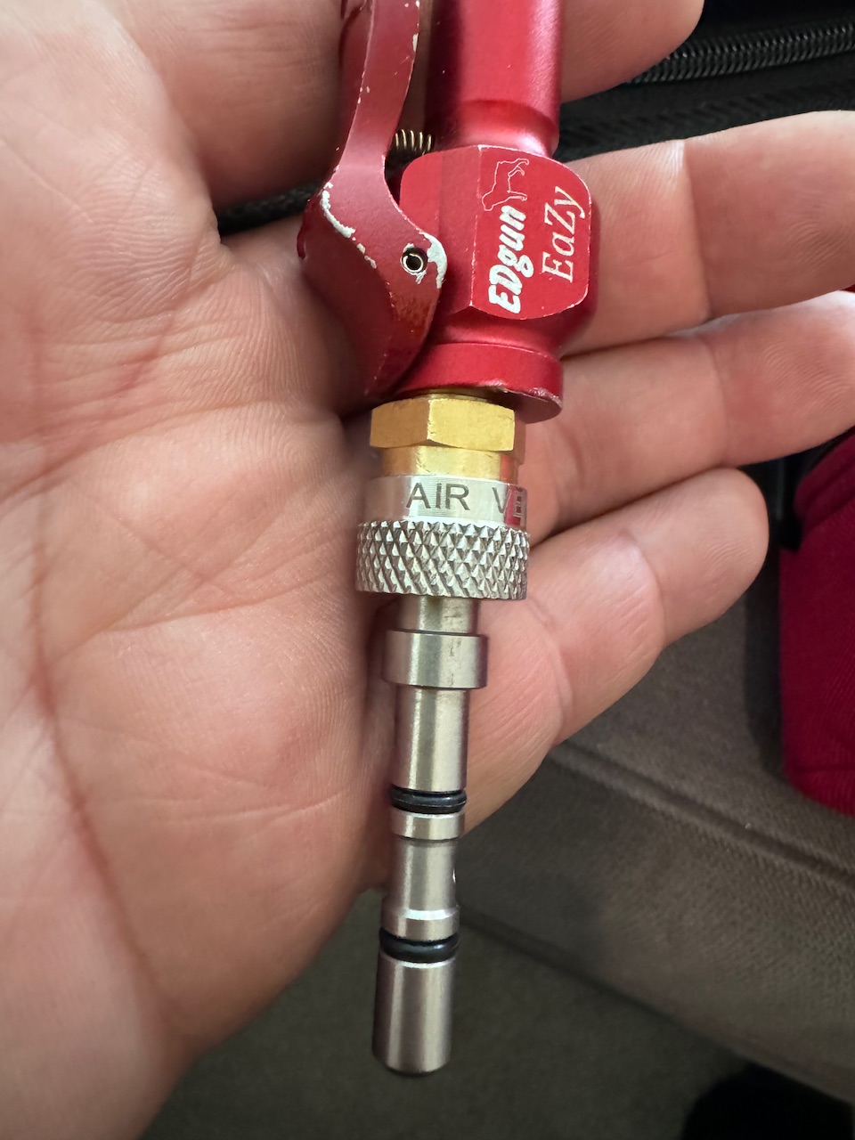

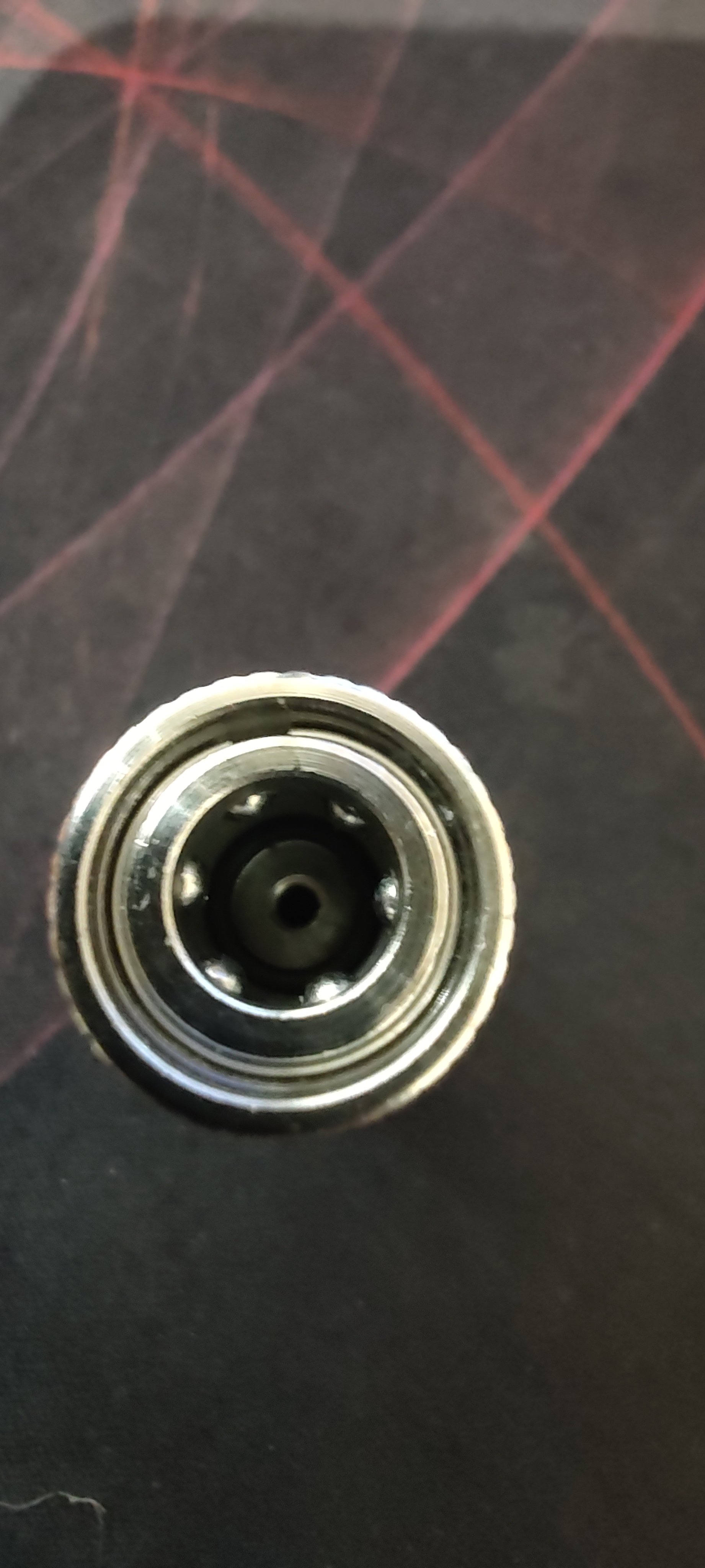

i tried to show the distance it moves in these, as well as the interior of the qdOk the AV ones work ok. 1/16 inch up and down is normal it looks like. Is the o ring inside the female qd?
Same as mine . Is it loose or sort of tight?i tried to show the distance it moves in these, as well as the interior of the qd
uhh, i mean it kinda wobbles a little. the first time i tried putting the probe into the qd it was extremely tight, but now it goes in pretty easySame as mine . Is it loose or sort of tight?
Double check the o ring inside the qduhh, i mean it kinda wobbles a little. the first time i tried putting the probe into the qd it was extremely tight, but now it goes in pretty easy
ok i just did a test, i put the probe in but didnt put it in the gun i jammed my thumb up against the hole as hard as i could while someone else pumped it, when the probe is out like in the above pictures it leaks 100%, when i have my thumb on it and push the probe in it i dont hear or feel any air escapingDouble check the o ring inside the qd
There you go you’re learning diagnosing you may need a new o ringok i just did a test, i put the probe in but didnt put it in the gun i jammed my thumb up against the hole as hard as i could while someone else pumped it, when the probe is out like in the above pictures it leaks 100%, when i have my thumb on it and push the probe in it i dont hear or feel any air escaping
