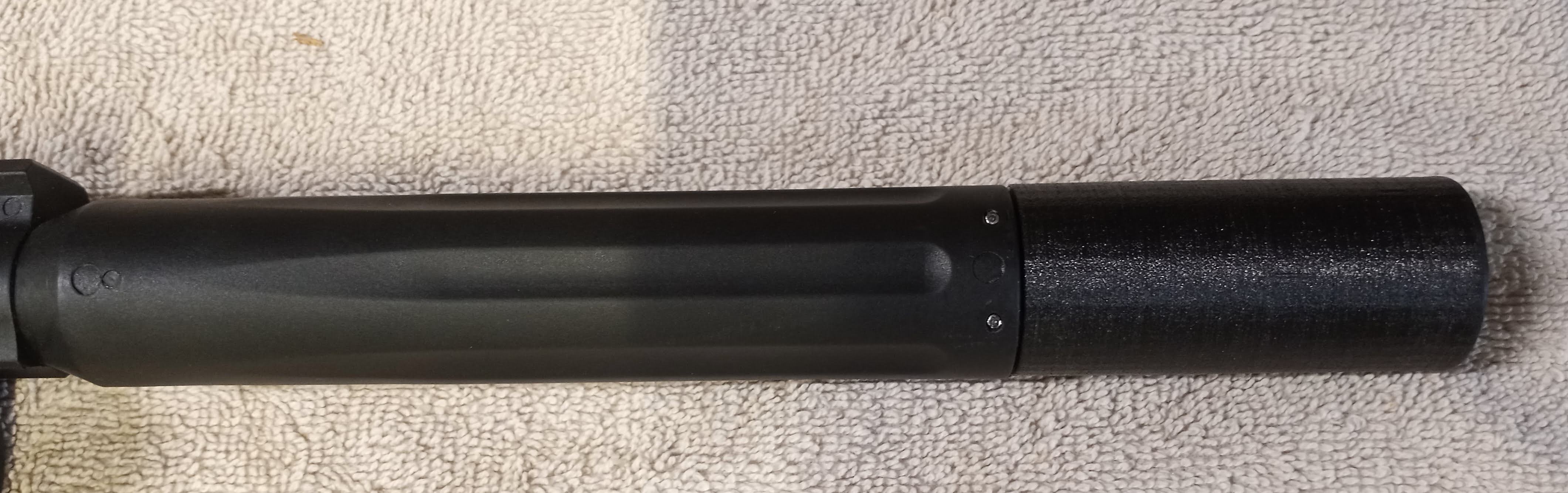

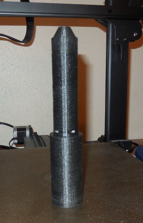

The image below is of the an insert for the unmodified casing, just printed by Mike: https://www.gatewaytoairguns.org/GTA/index.php?topic=206735.msg156435531#msg156435531

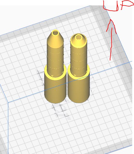

Reactions: Rain
Note that these parts must be printed with the wide end down on the platen, and the small end of the cones up. This is so that the internal structures are self supporting.
You need to select "supports off", else the inside may end up with a bunch of material you cannot remove.
The walls are thin, so set 100% infill.
Before you actually print yours, check back at the GTA thread to see if there are newer design versions, or more info about better pin hole locations: https://www.gatewaytoairguns.org/GTA/index.php?topic=206735.msg156435676#msg156435676
