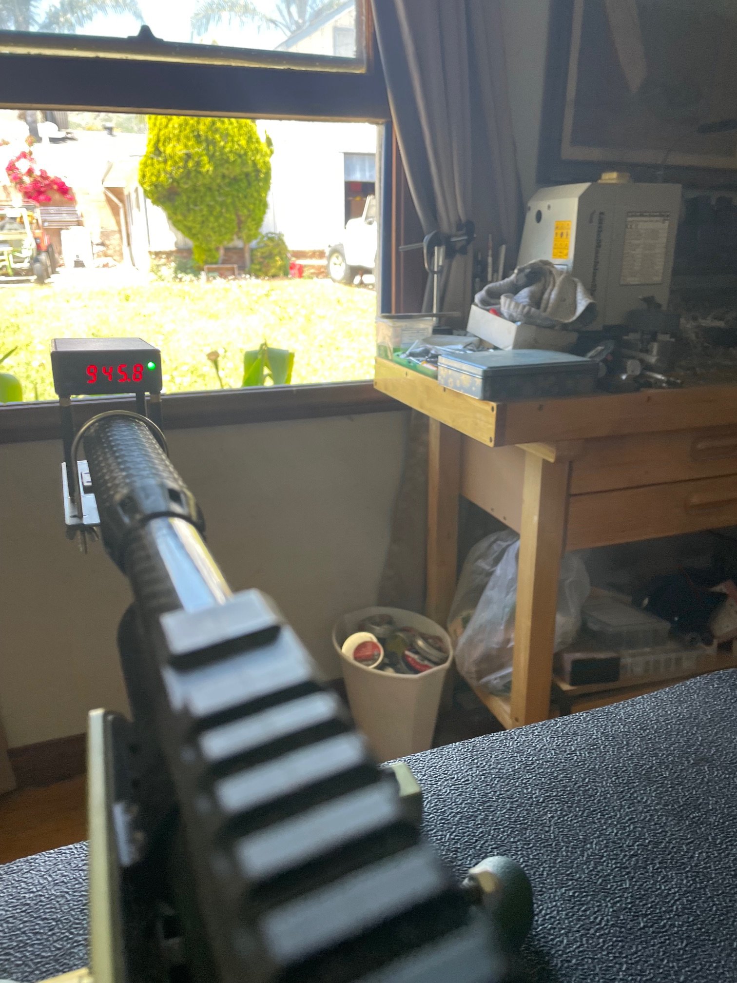

There has been good news as of late. Without doing any porting and/or permanent changes, I have been able to increase velocity from 740fps to a whopping 812fps with just an FX liner/barrel kit from c88machining on ebay.
This was achieved with a 700mm liner while the 500mm liner gave a solid 800fps.
In the near future, I will be modding a brand new Notos with full 5mm porting through all the receiver, air block and transfer port, the custom made thimble will utilize multiple ports for full use of all the new air.

OK, today I started with a new in the box Notos, I ported it front to back at 5mm, twin thimble ports at 5mm as well.
2900 psi regulator with the stock hammer spring and got a whopping 915fps with CPHP's!
I figure that once I change over to the Z-block, put a plenum on it and a bigger bottle, I should be able to tune it and settle on a pellet for her.
I stole the mod, drop-block, reg and bottle from my EDS but she will be getting them all back when I switch over to the Z-block.

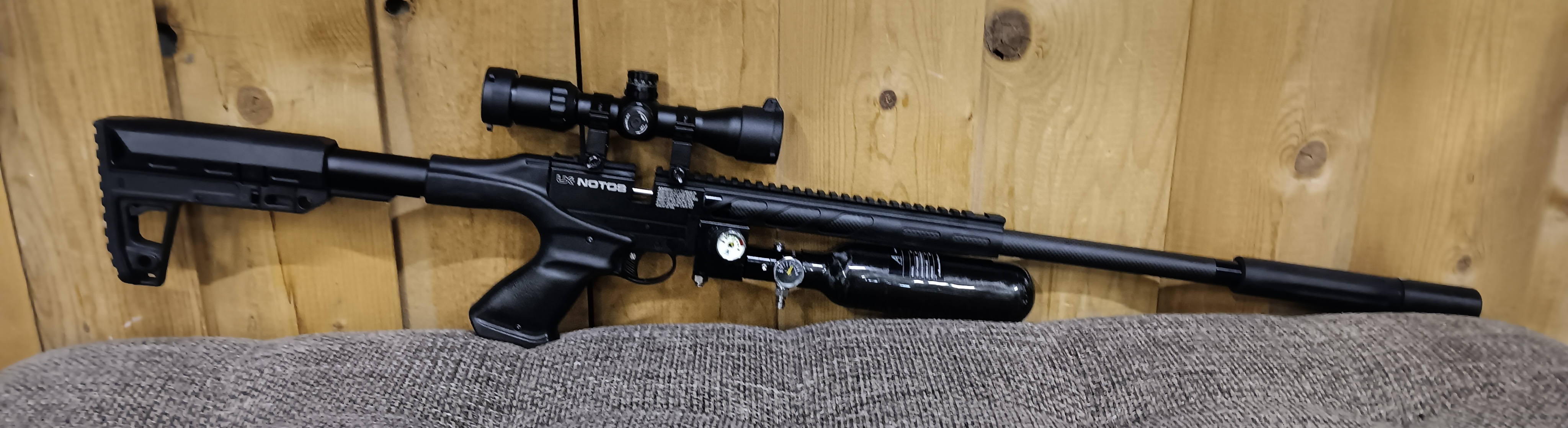

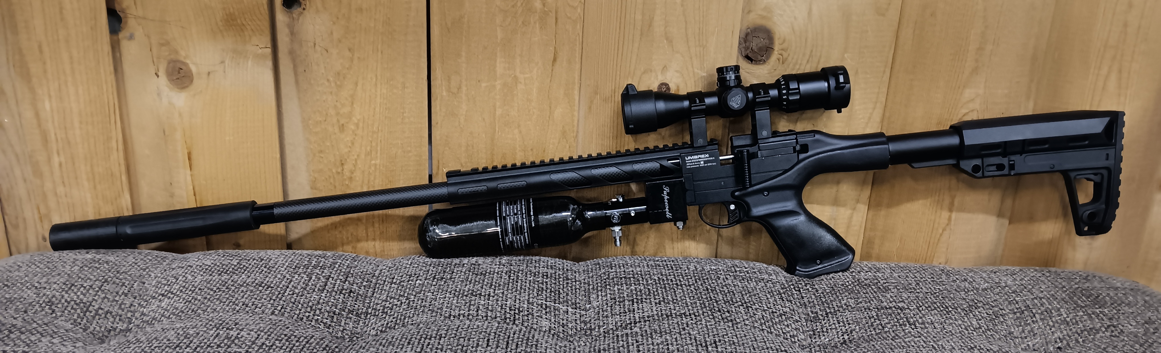

My younger brother is always wanting more power for his Notos. This rifle has a Reximex Turmenta 15.4" barrel (390mm) and action block opened to 4.8 mm along with the barrel port angle 11+ degree. Reg at 2100 psi. This is the biggest plenum I've made @ 32 cc, middle is 25 cc and bottom is 15. Just south of 30 fpe now. Tank is an Airmega 100cc @ 4500 psi with modified end caps for additional 12 cc. Still a very compact carbine at 29" w/o the moderator attached.
I thought I see an adapter that threads on the shroud. Is that not possible?
